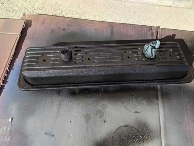

Made some more progress on the build, I pulled the valve covers to clean them out and check the valvetrain. Im very happy with the condition of the top end, makes me believe the mileage on the odometer. I then cleaned and painted the valve covers, I couldnt put them back on as they were. Next up was to drop the trans pan for a new filter and fluid, this stuff has been sitting since 98' so I thought it would be a good idea. I cleaned up the pan, it was covered in crap and then I cleaned the torque converter cover before painting it. I decided not to paint the trans pan this round, I might just replace it next time anyway.

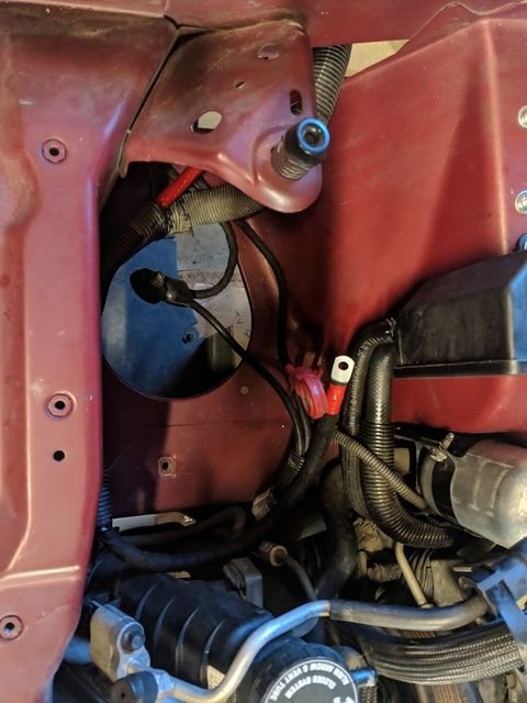

Update: I swapped out the drivers side plugs and wires, working on the passenger side now. The plug access isnt too bad with these headers, I changed the drivers side from the top. I will probably have to change out the wires from underneath on the passenger side. I also started on the passenger side wire tuck, need to order some new terminal posts and a breaker for the amp wiring. I am going to run the power wire under the inner fender as well and then behind the PCM, trying to keep it as clean as possible.

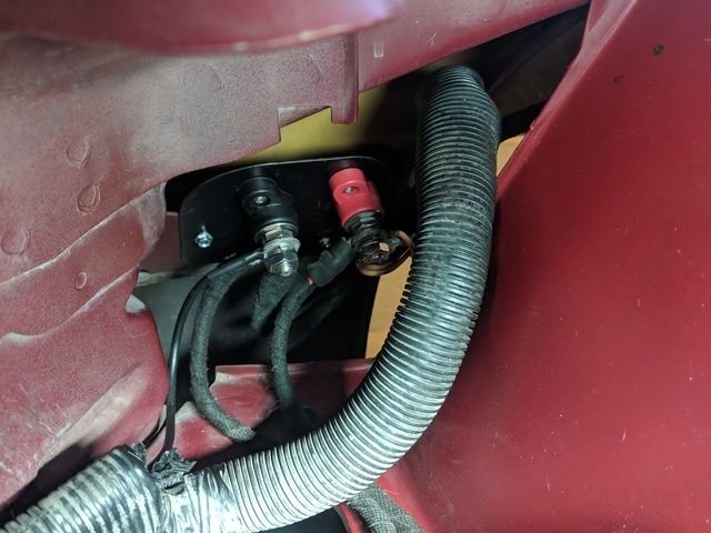

Continued progress of the wire tuck, I purchased some new terminal points for power and ground, I wanted something more compact that the factory arrangement. I then made a steel mounting plate and put the terminals inside the inner fender. Next up was boring the hole in the inner fender, wrapping all of the wiring in cloth tape and securing the harness with rubber cushion clamps. I used some SS button head hardware I had to fill in the holes, mount the harness and the power steering reservoir. Maybe some day I will weld everything up, but this will do for now. I also need to install a circuit breaker and 2awg cable for the amp, still waiting for those items to arrive. Then I can secure the wiring completely and put the fender liner back in.
I also moved the ground wire from the radiator support to the new ground stud, much cleaner now.

I started routing the 2awg power for the amp, waiting for the circuit breaker to show up. I also made a harness for dash power (12 awg) and a three pin wire for the alarm siren and hood pin. The harness has a fuse holder for the power wire and everything is covered in braided loom for protection. I plan on routing them both through the grommet behind the computer.

Update: I routed the 2awg cable and the loom with the 12awg wire last night. I had to use some larger cushion clamps to hold everything in place. I also fabricated the mounting bracket for the circuit breaker and mocked that up. I just need to paint it and put everything together now, it was far too cold yesterday for paint work.

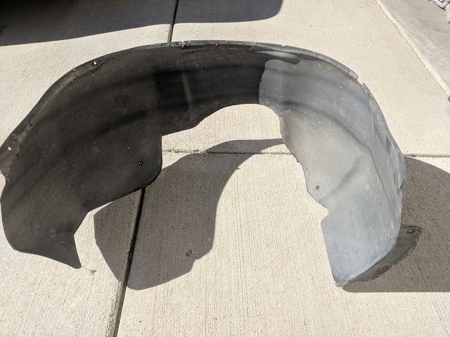

I have made some good progress in the last few days, car is back together and running again (for now). I painted the bracket for the circuit breaker and while it was drying I did the ICM cooling mod, then moved onto to pulling the wiring inside the car, cleaning up the fender liner and the coolant overflow bottle.
Everybody sound deadens their fender liners right?

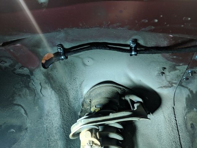

Fuel line and hood cable relocation in progress, almost done with the fuel lines, Im waiting for my grommets and braided loom to show up. I also washed the inner liner and applied sound deadener.
