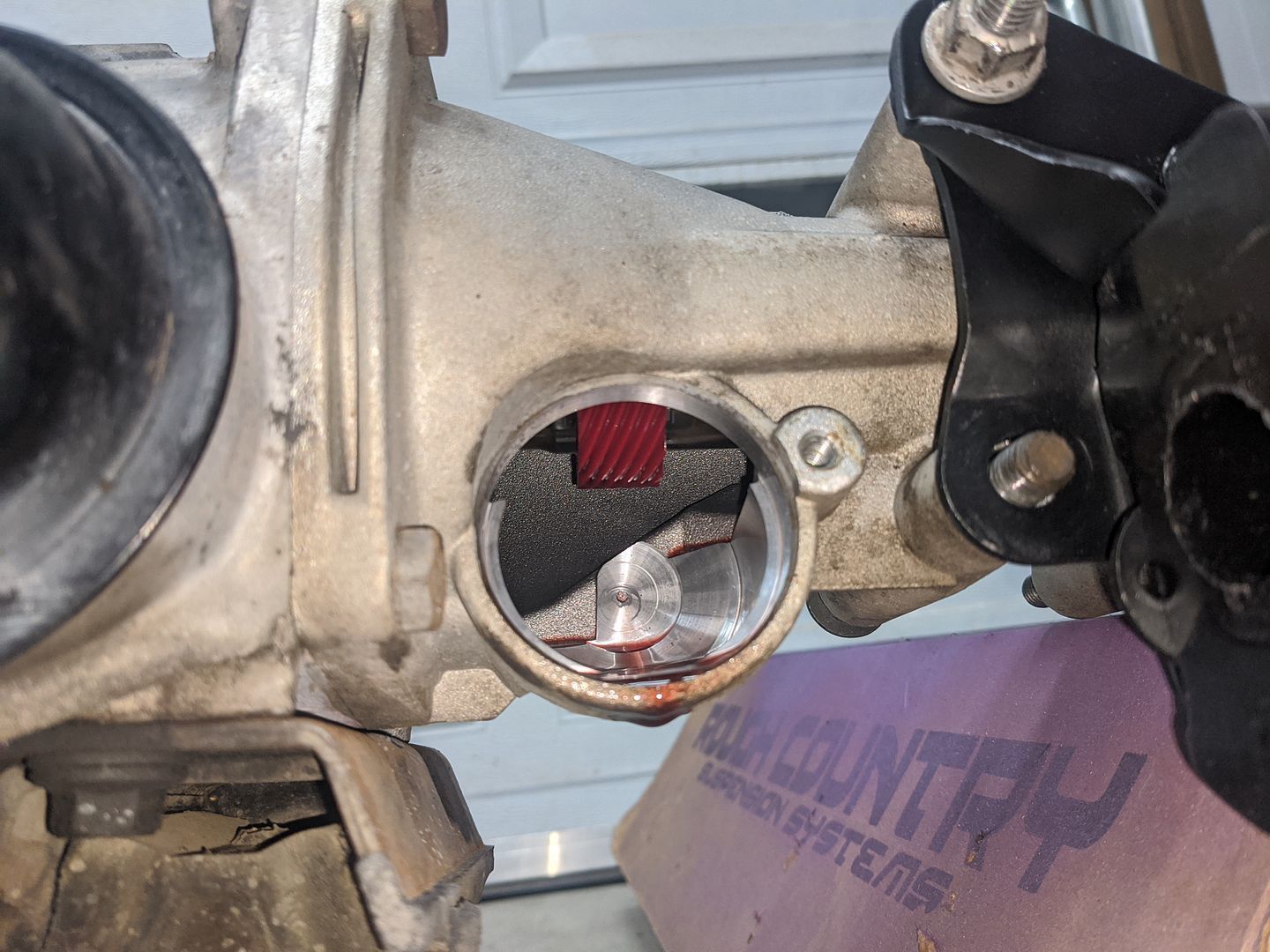

Since I will be delayed waiting on the correct flex plate, I decided to correct my speedometer. After putting the correct tires on the car, I noticed that the speedometer was off apx 9-10mph at highway speeds. I pulled the speed sensor yesterday and figured out why.... The trans has the "correct" red drive gear, but had a light green (34 tooth) driven gear. From the calculators I ran, I need a 43-44 tooth driven gear for my gear ratio (3.23) and tire size (245/50/R16). I ordered a new gear, so hopefully that corrects the issue.

Originally Posted by 95blackm6
Is this the one you pulled out of your trans? If so, that is the correct 44 tooth gear.....

It is and crap, really? So why would the speedometer be off so far? You think the rear gear ratio has been changed?
The rear may have been swapped out, the only way to know for sure would be to pop the cover and count the teeth. It wouldn't surprise me if it had been, swapping the rear is usually easier / cheaper than having one rebuilt.

Understood, I didnt even think to check it when I had the cover off...

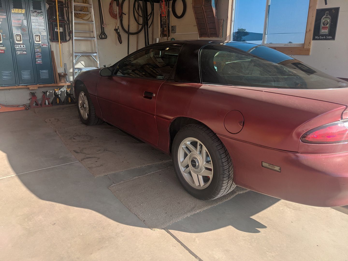

The car is finally moving in the right direction (no pun intended), no more oil leak, A/C blowing cold and seems to be driving well. I took some decent full shots of the car outside for the first time in a long time.

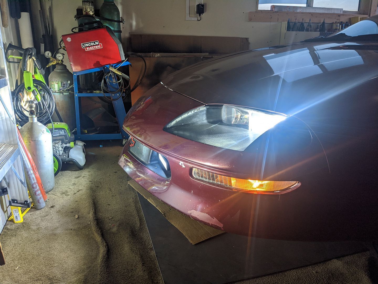

One of my factory driving lights was broken when I got the car, so I swapped to LED replacements for now. I cannot justify the cost for new factory lamps right now. After looking at the photo, I need to adjust them a bit, but at least they are in place.

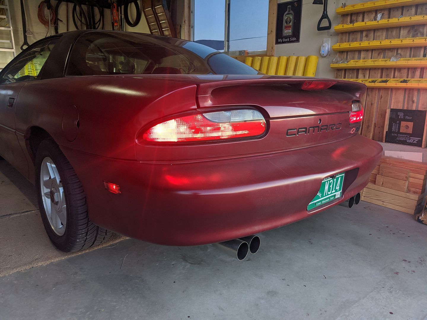

I also took some good photos of my exterior LED upgrades.
