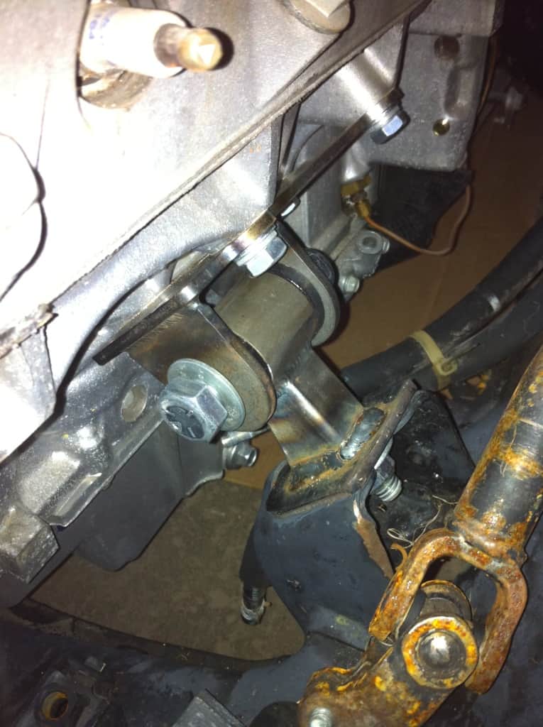

I built a LS1 powered 89 Supra. It really is amazing how easily these motors drop into this generation Supra. The motor mounts line up perfectly. The Camaro pan clears everything and the Corvette fuel / filter / regulator even fits in the stock fuel filter location at the rear of the car. CTS-V exhaust manifolds fit almost perfectly. We just milled the mounting flange a little to tuck them in tighter. Also the aluminum LS motor is lighter than the stock engine, sits lower in the chassis, and is almost completely behind the shock towers. Cylinder 1 lines up with the towers. It is a great swap for these cars however as stated before it pisses off the die hard Supra owners.

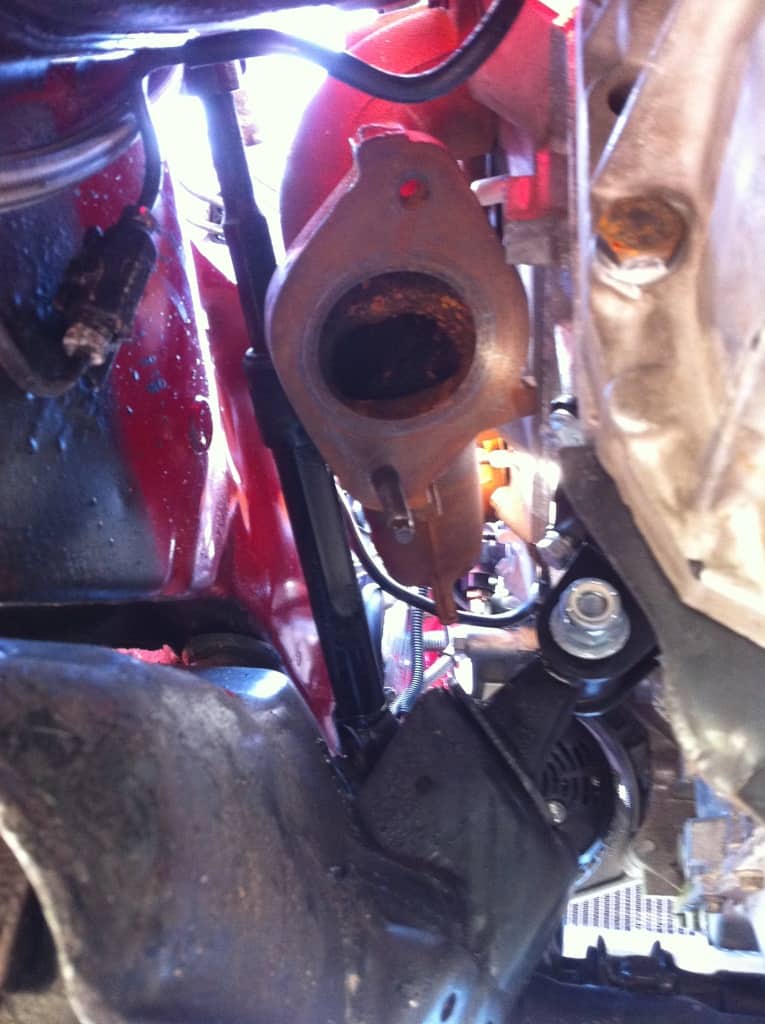

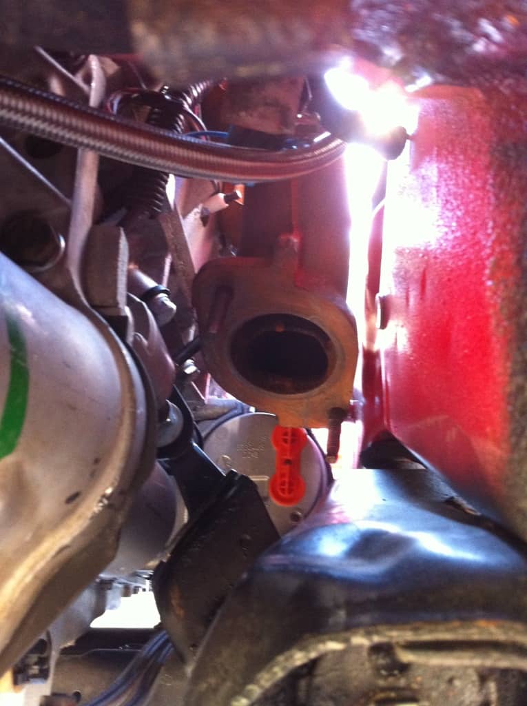

The V manifolds we used were first generation I believe. The passenger side flange hit the frame rail so we milled the flange that mounts to the head at a slight angle to tuck them a little tighter to the engine. I worked great and clears everything quite well. Looking at the 5th gen Camaro manifolds I suspect they would work as well and they are probably easier to find.

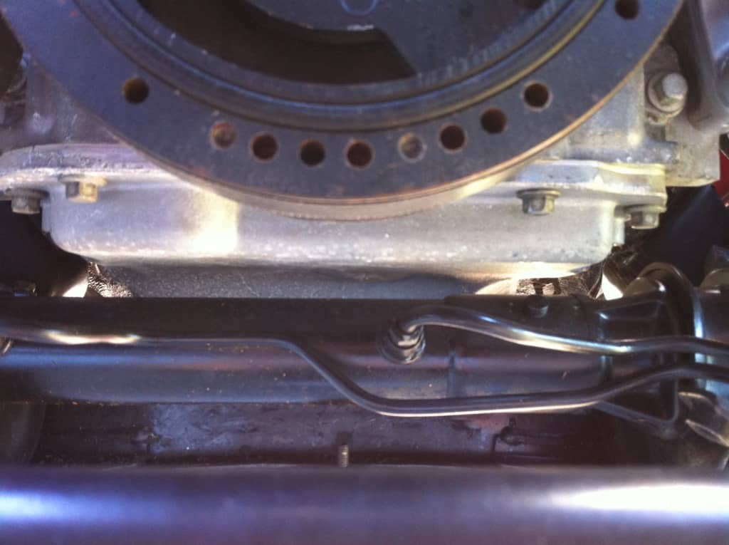

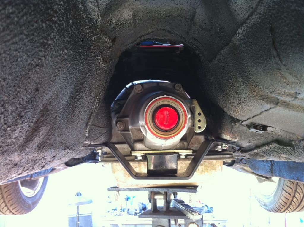

I don't want to hijack your thread here but I thought maybe some pics from my build would help you out. I never did a build thread on here so here they are.
Drivers Side CTS-V manifold stock
Passengers Side CTS-V manifold milled to tuck in closer to engine
Motor mounts

Simple transmission mount
4th Gen Camaro oil pan clearance to rack

Thanks alot for the pics,, that helps ALOT. Just ordered the V manifolds. Thanks again

No problem. Glad I could help. I do want to add that I know we milled the passenger side manifold. I can't really remember about the drivers side. I don't think we did but we might have to gain a little more clearance on the steering shaft. I do know that they did fit without any modification but we milled them to gain more clearance. Plus your engine location might be a factor too although it looks to be pretty much the same location as where we mounted ours. It should get you pretty close anyhow and the manifolds are usually cheap. I think we paid $50 for a pair.
