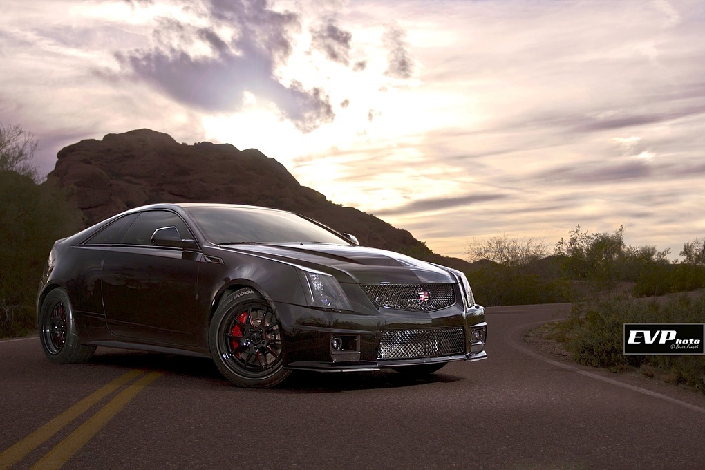

One of these days I'd love to meet up and compare notes as I go through my build
Here's my baby looking pretty, not as cool as a GN but I love her.

Love the Caddy! Bad azz car
