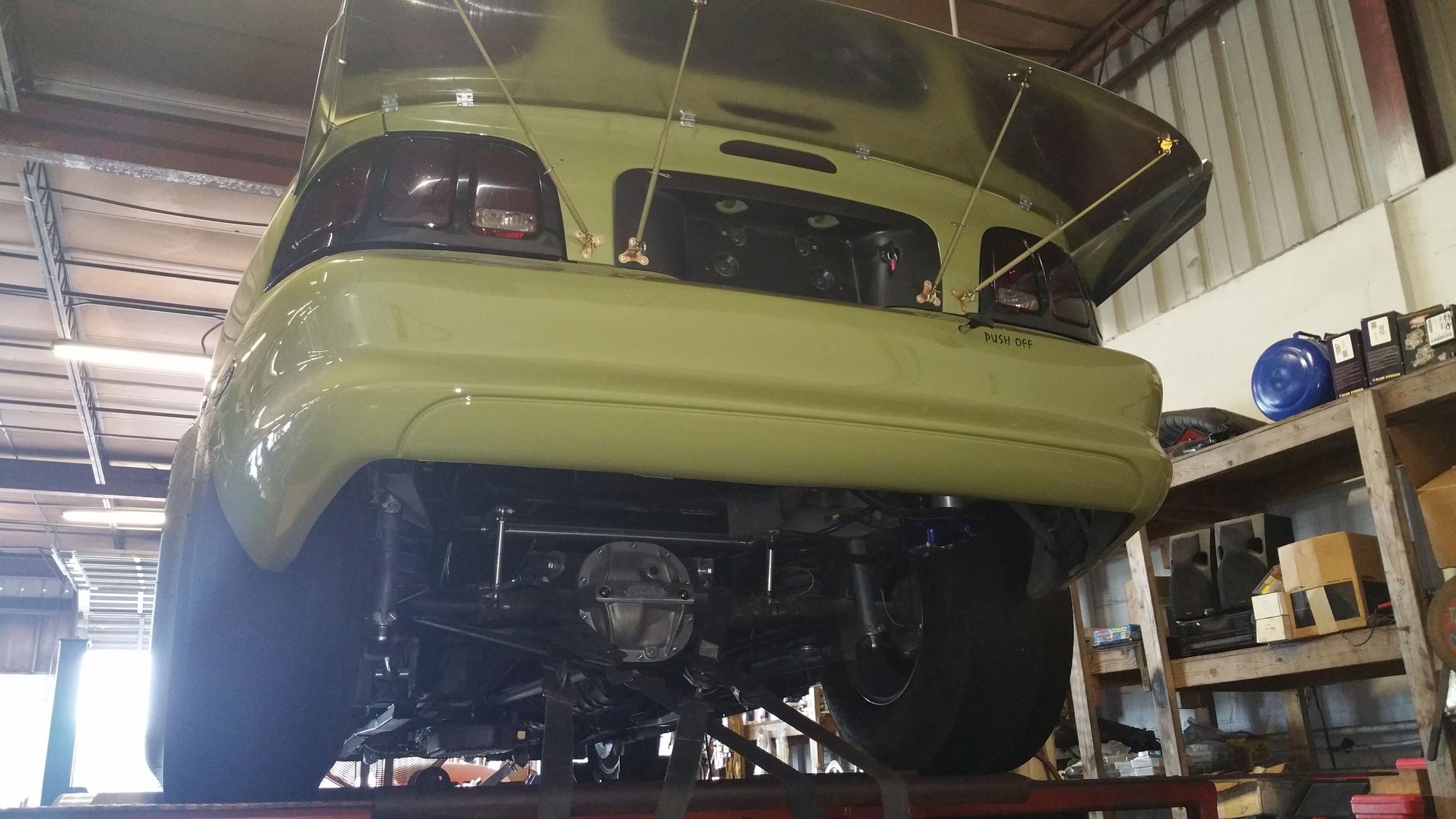

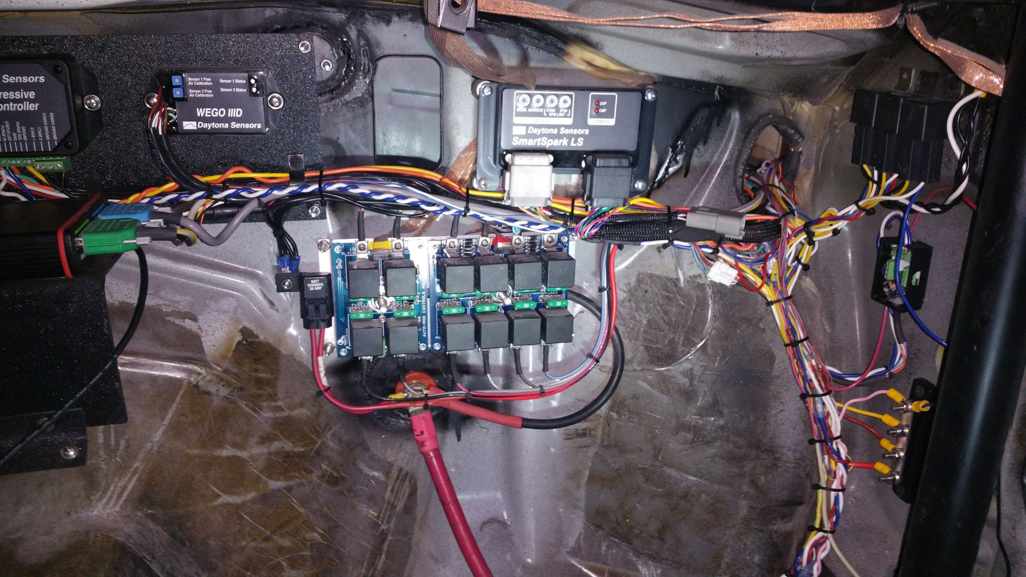

Finished up the wiring today. Moved car to dyno but wheels are rubbing. Going to have to change the wheels to fix it.

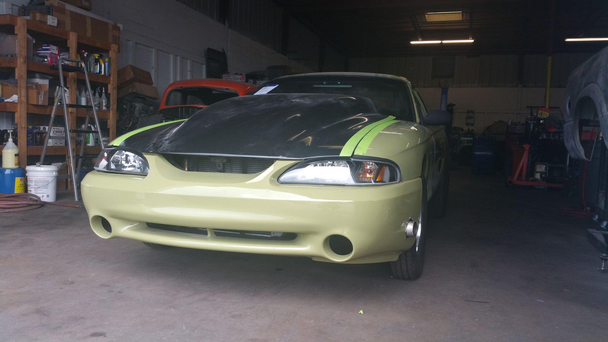

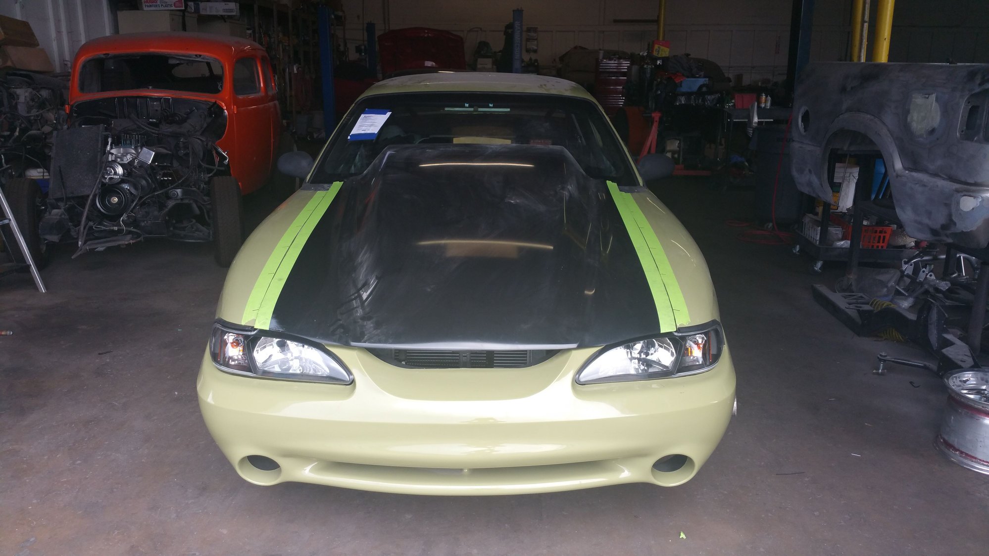

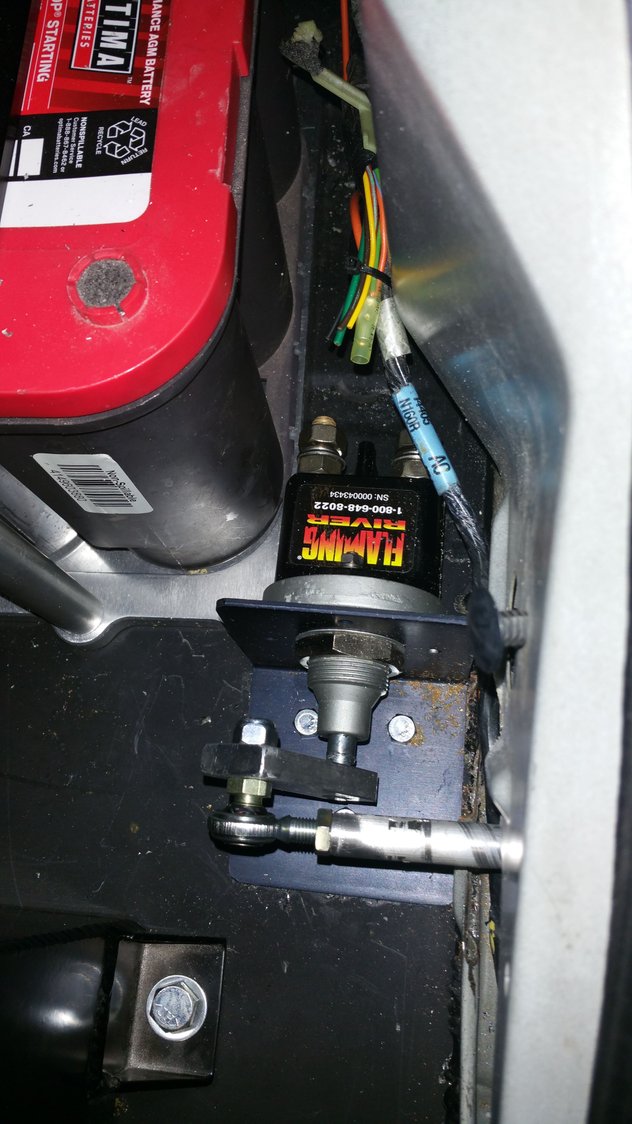

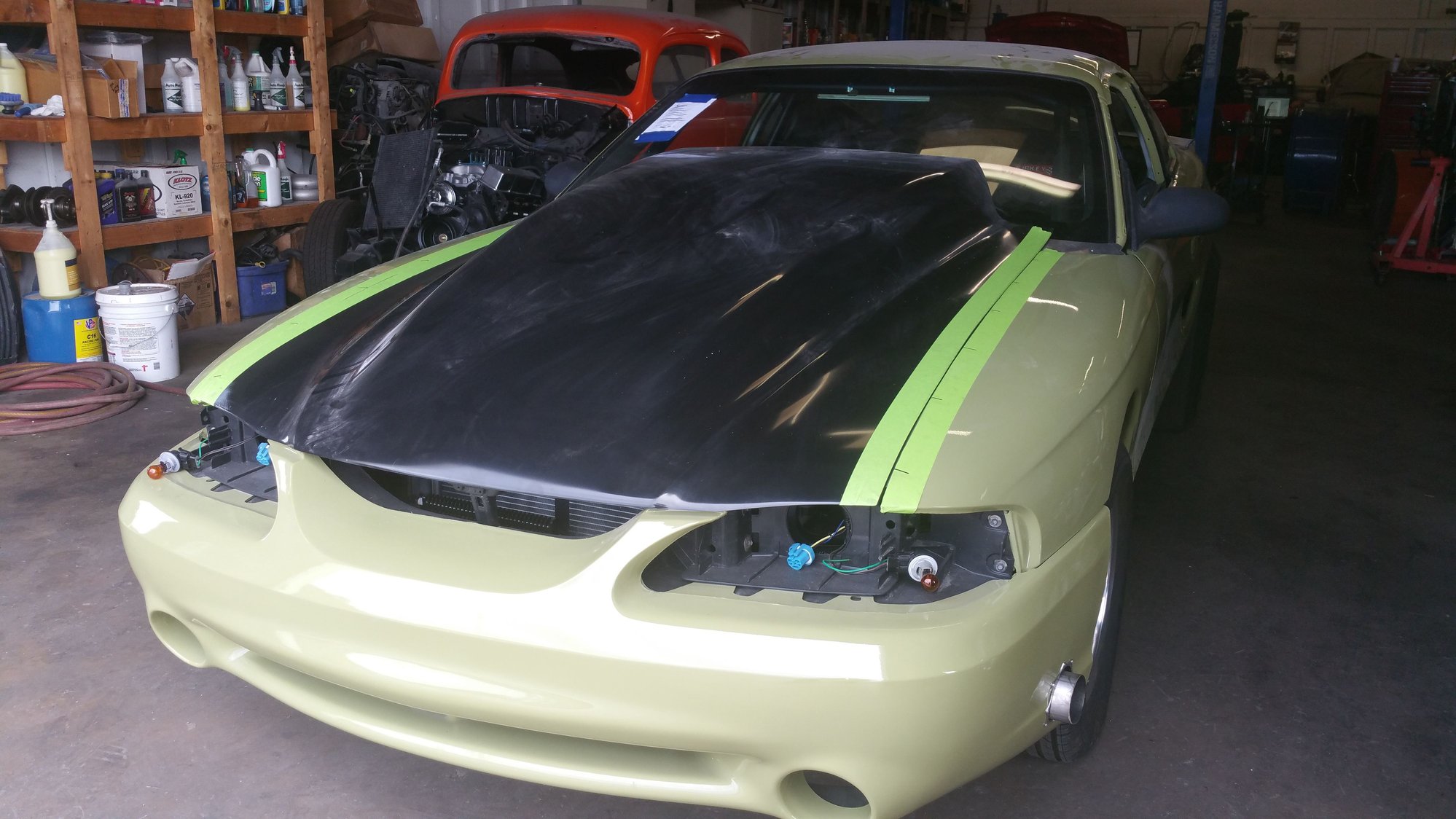

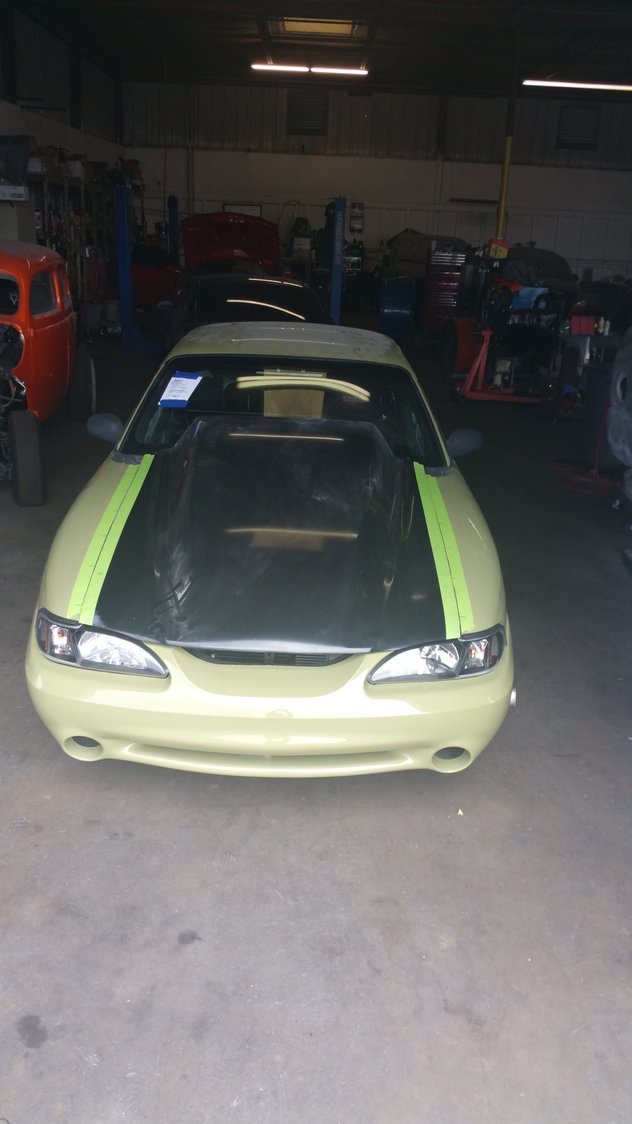

Working getting her finished up!

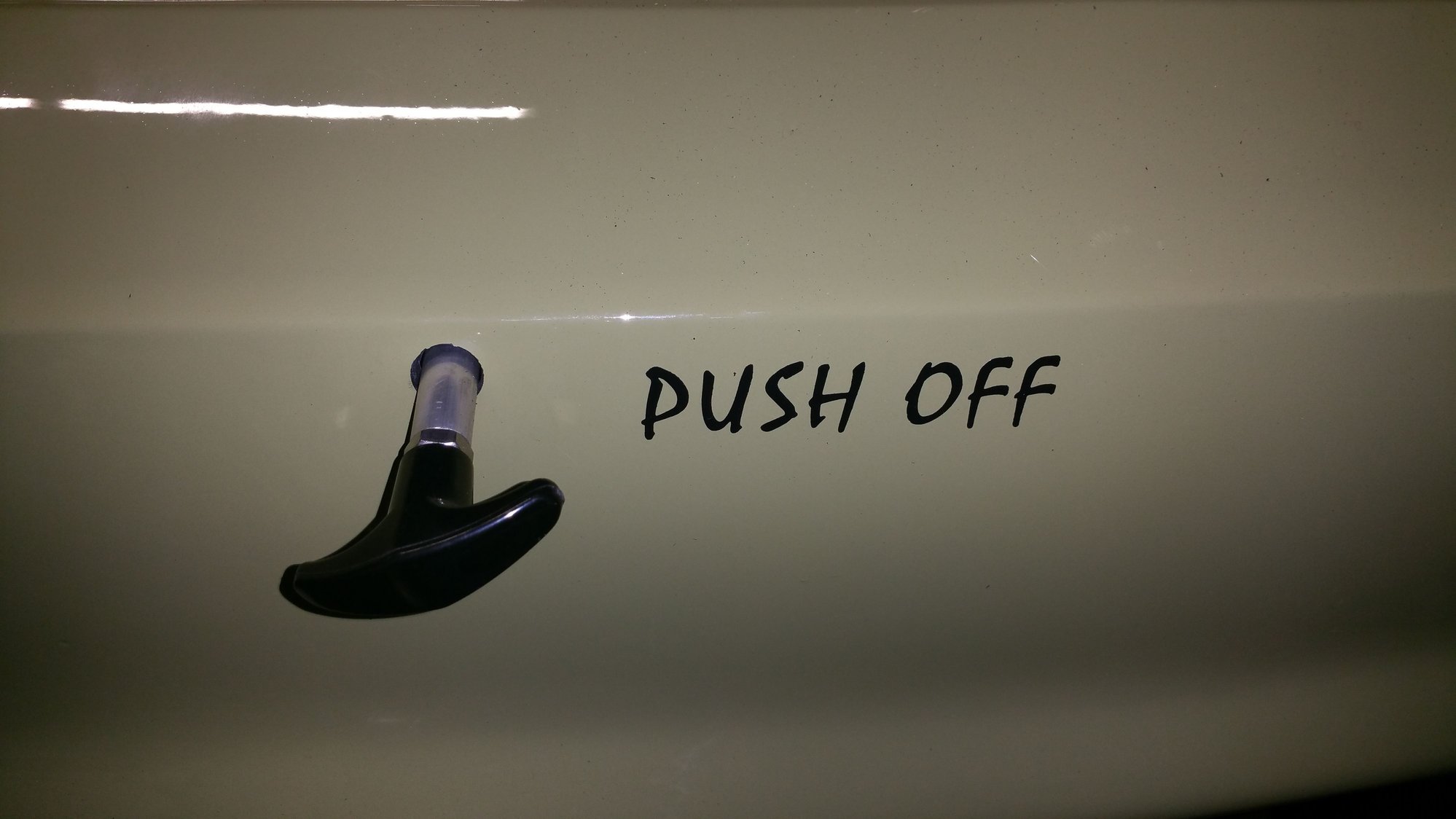

Push to kill
Master kill switch
Fitting hood

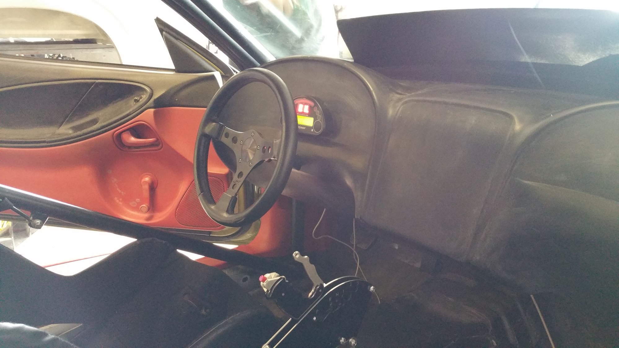

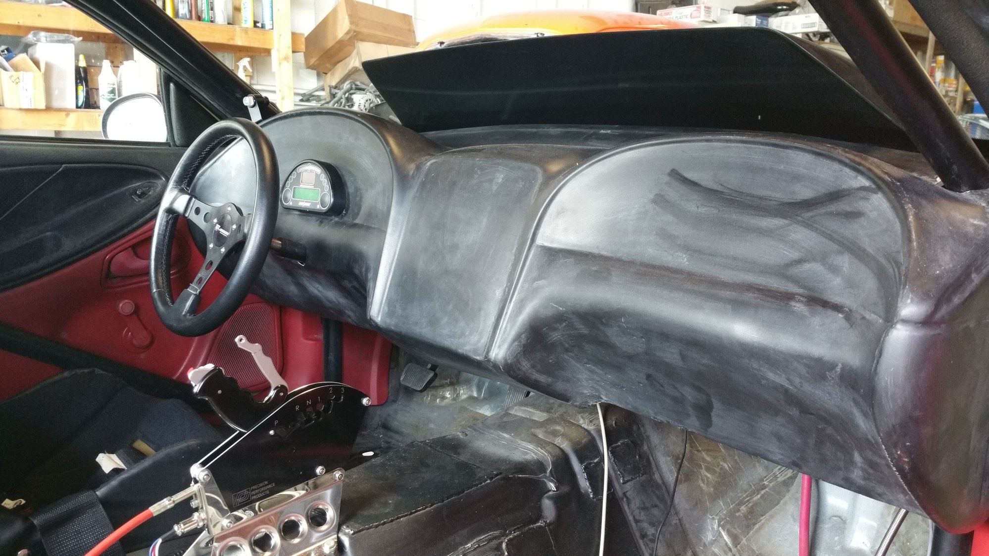

Plan on pulling the interior back out to paint, add a second seat, and carpet, but for know she is 99% track ready!

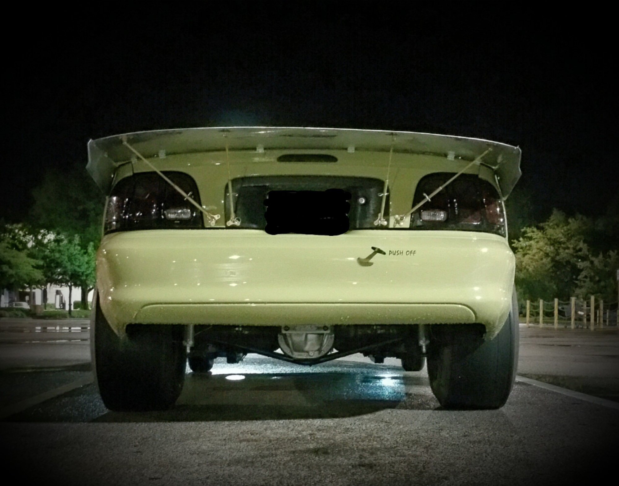

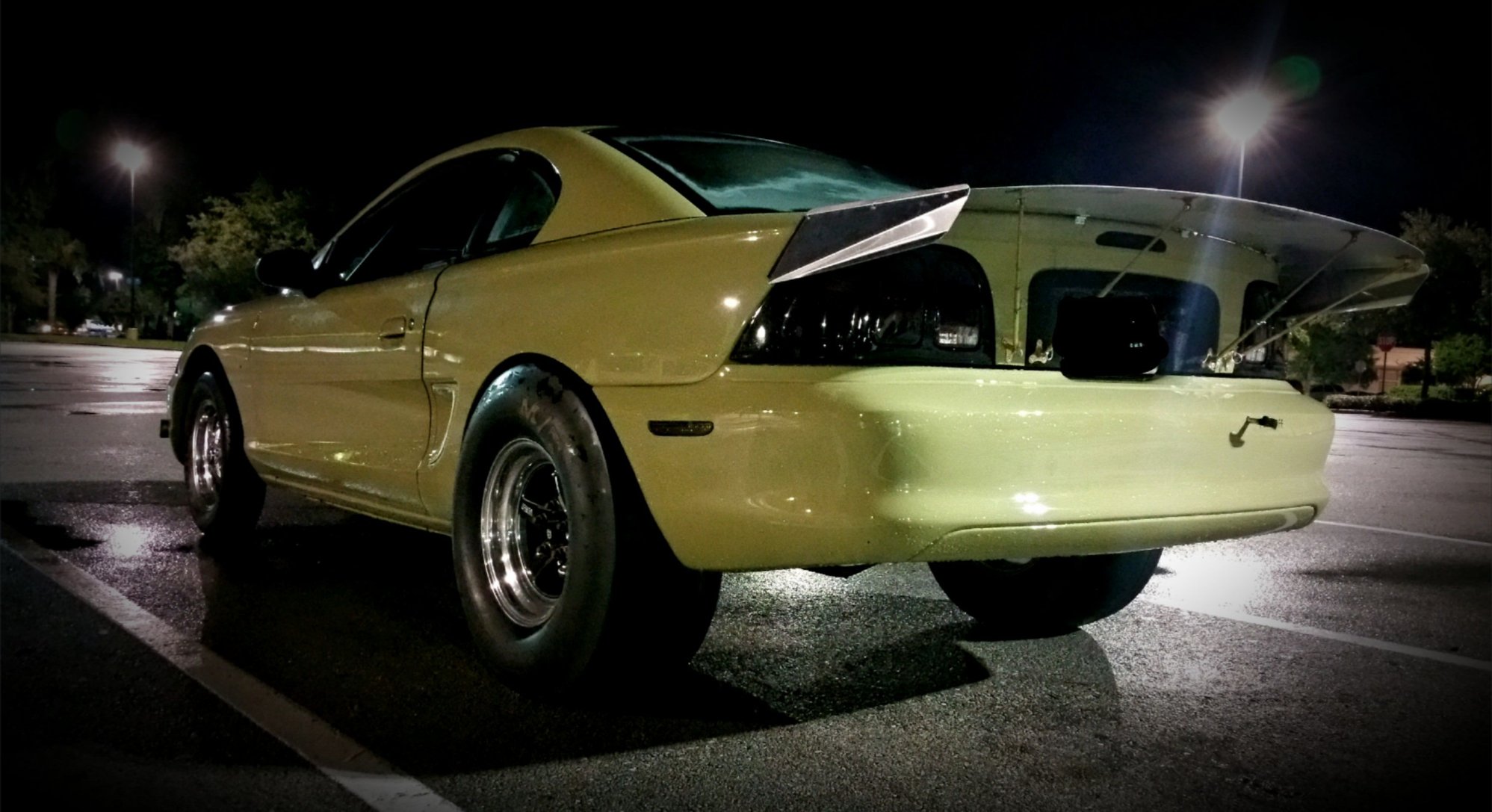

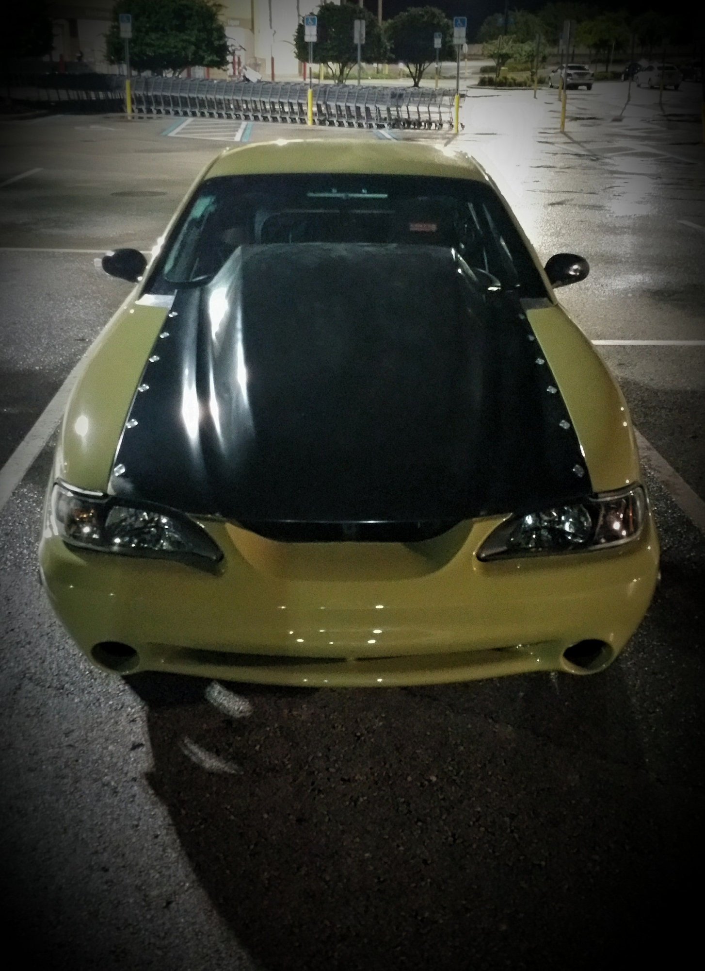

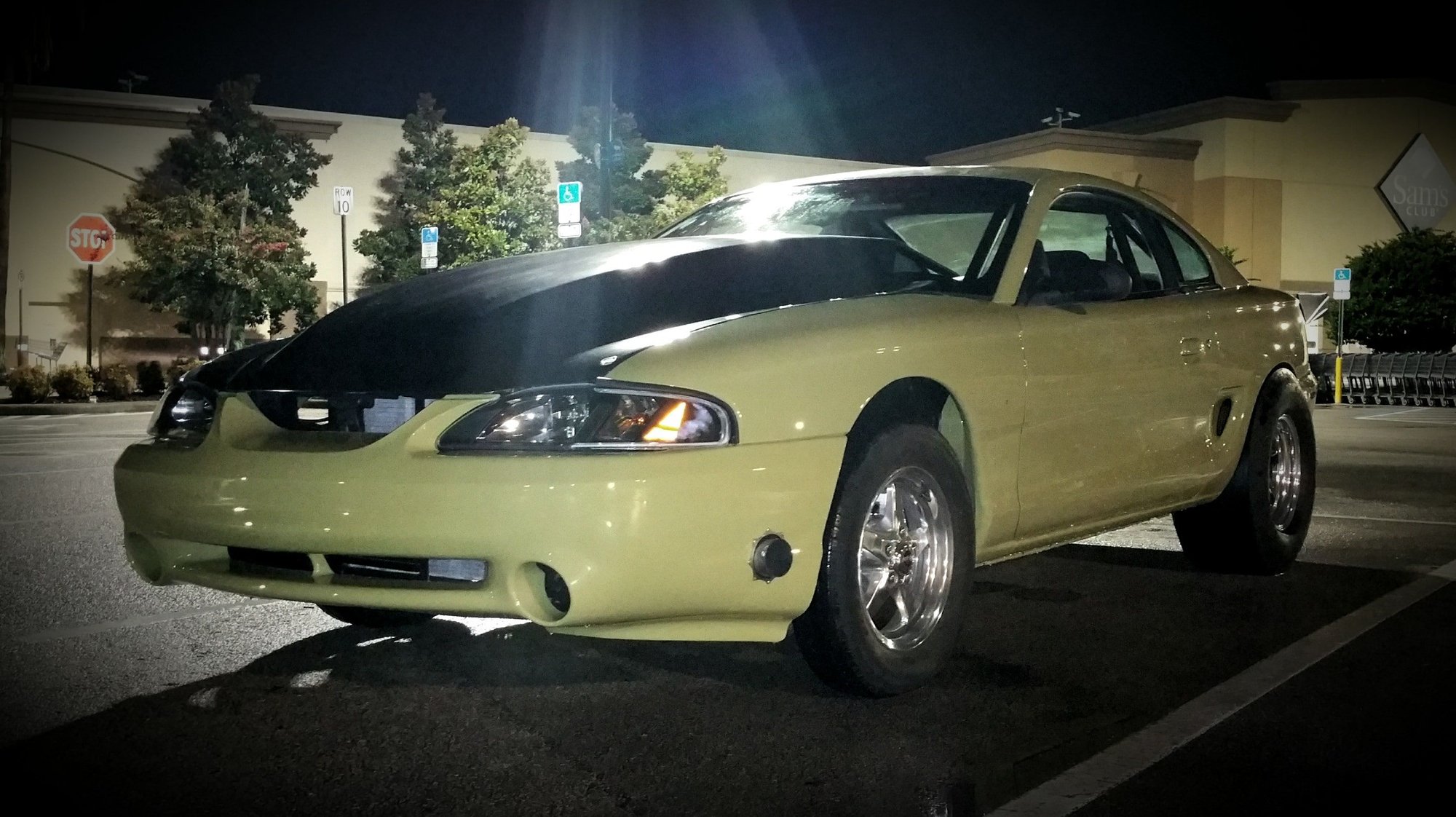

A few pictures from last night

The wheels that are on it are borrowed from a friend and are back spacing. We had 7.25 bs but had some issues once we set the ride height. The rear end is stock width 2001 mustang 8.8, and the tires are 29.5x10 ET drags. It looks like we really need a 6.5 which are back ordered or a 6.75" backspacing which of course nobody makes.

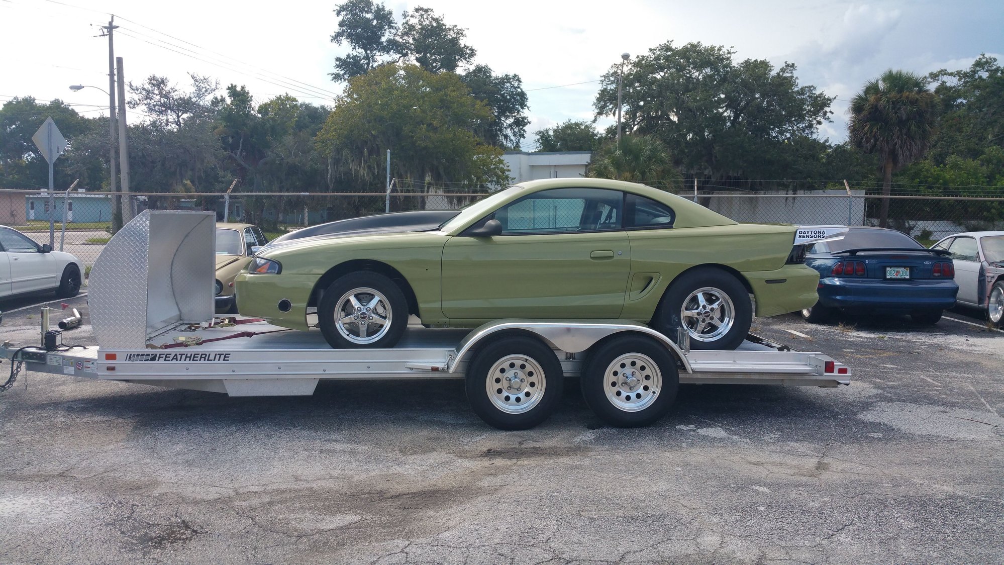

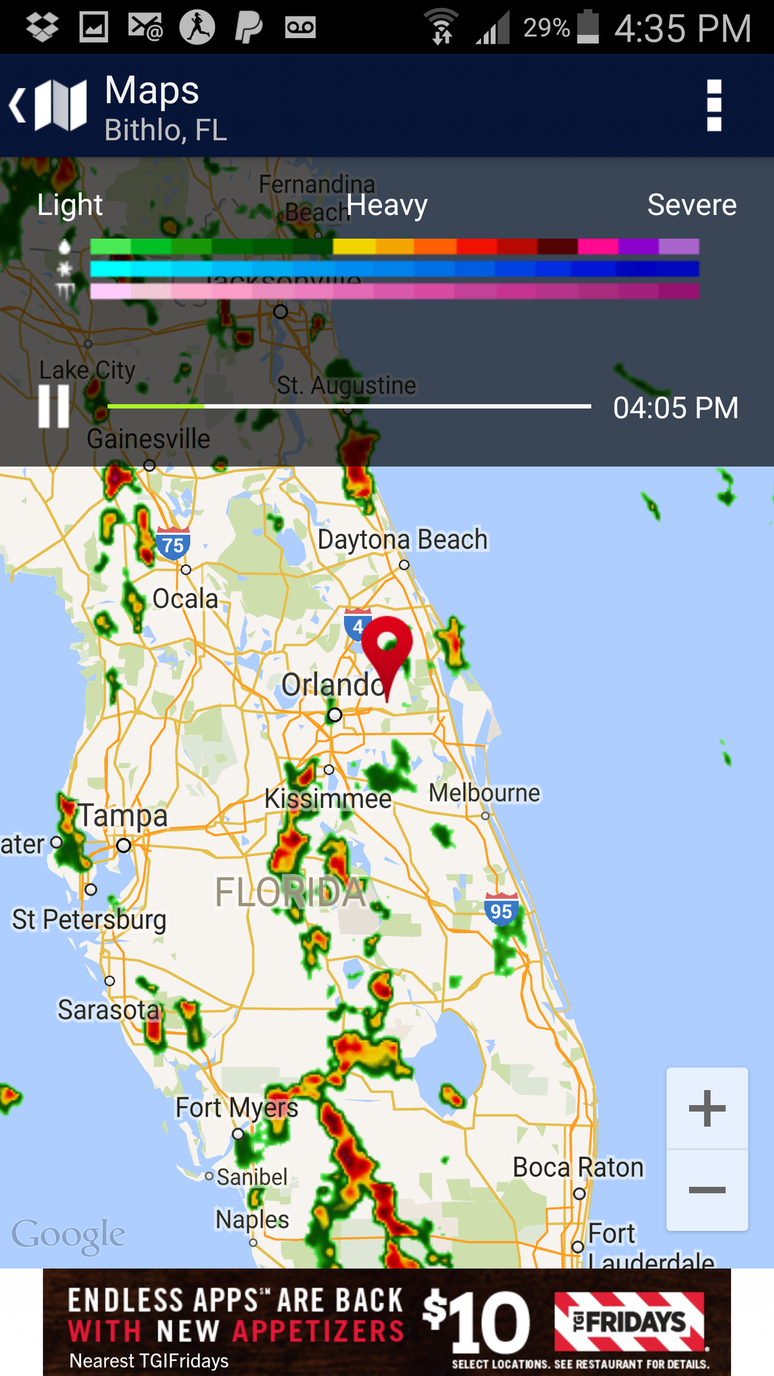

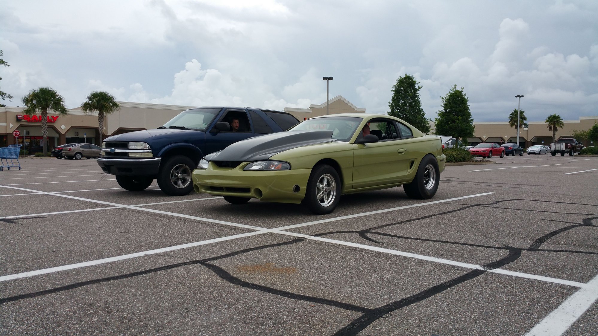

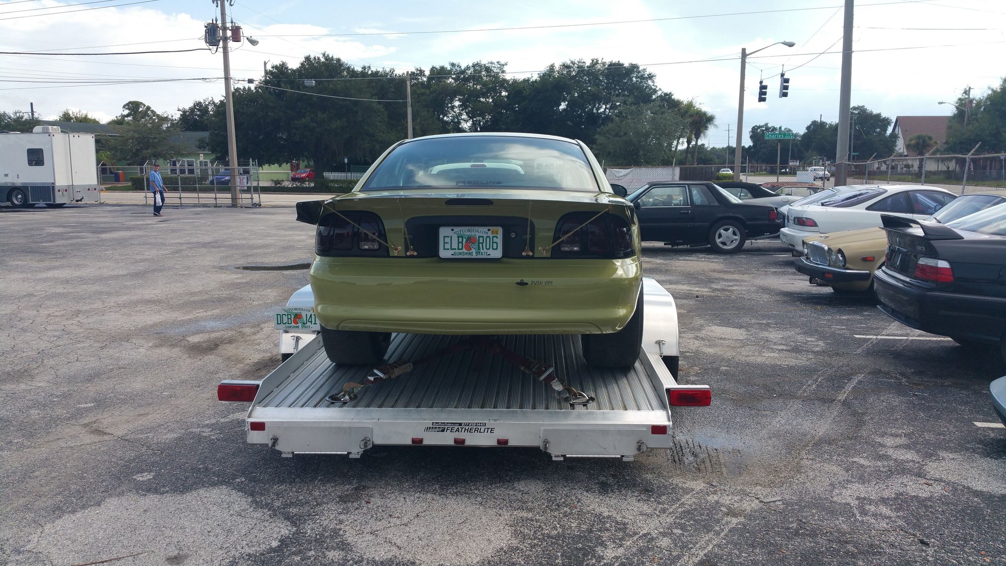

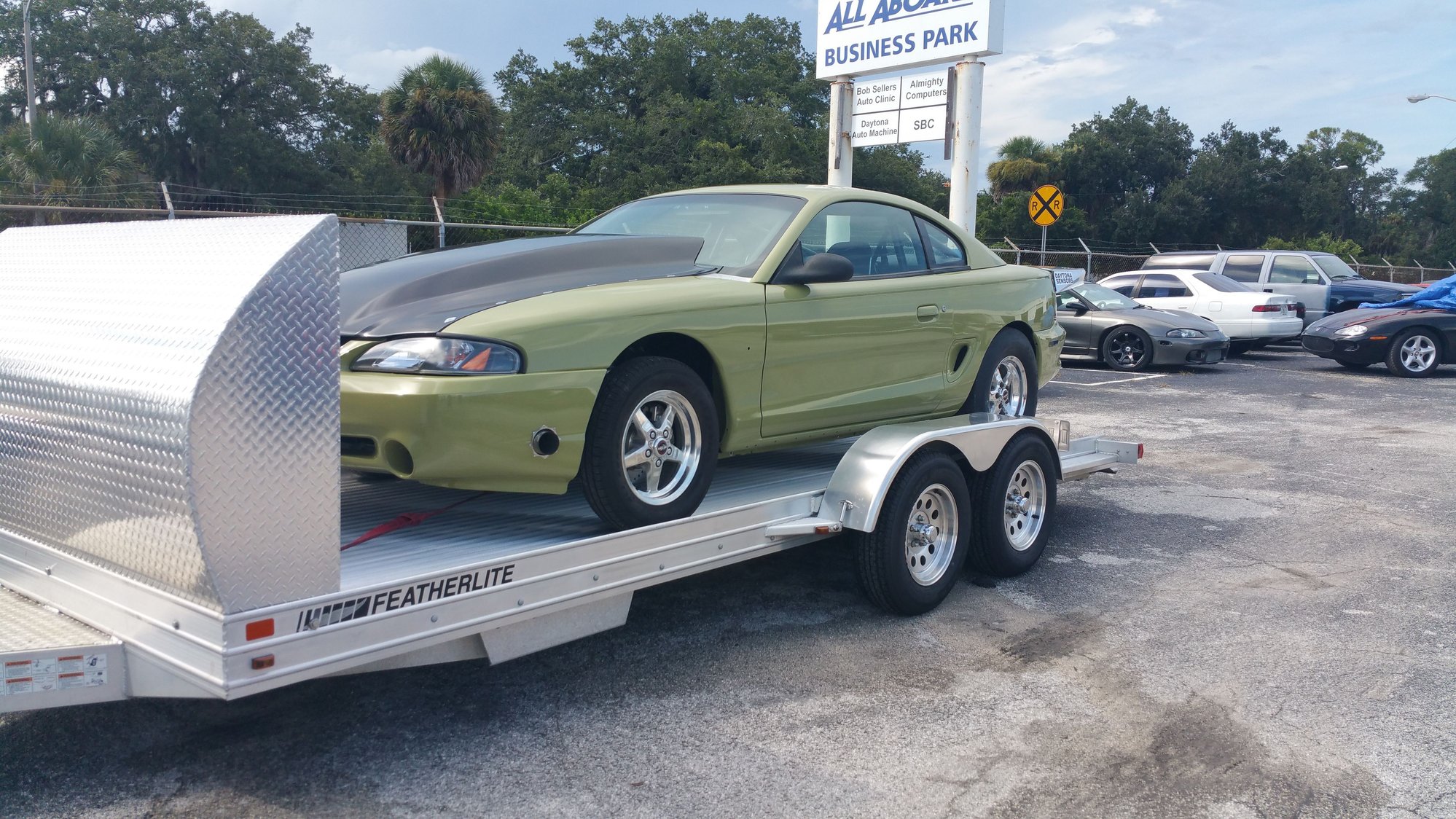

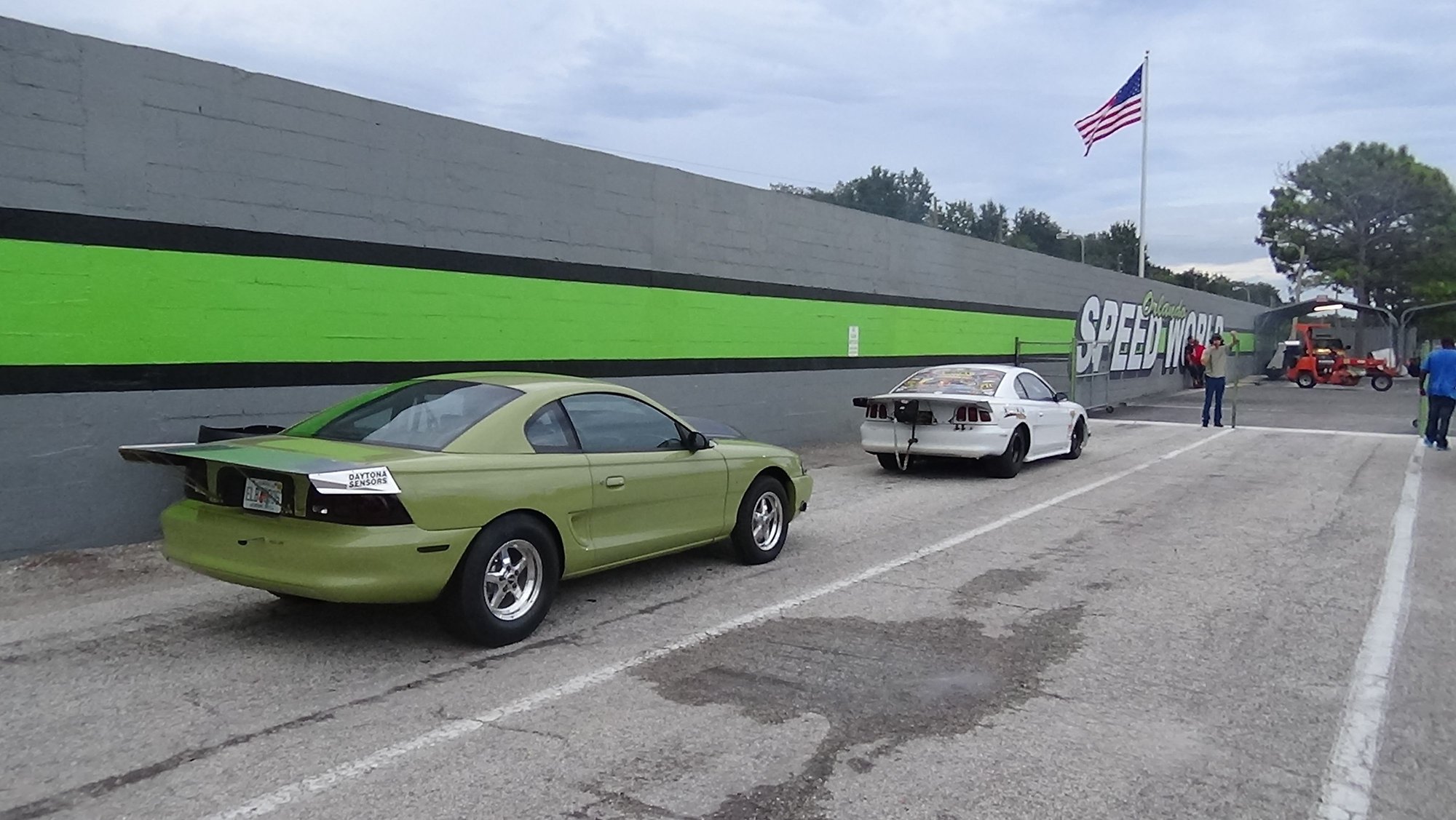

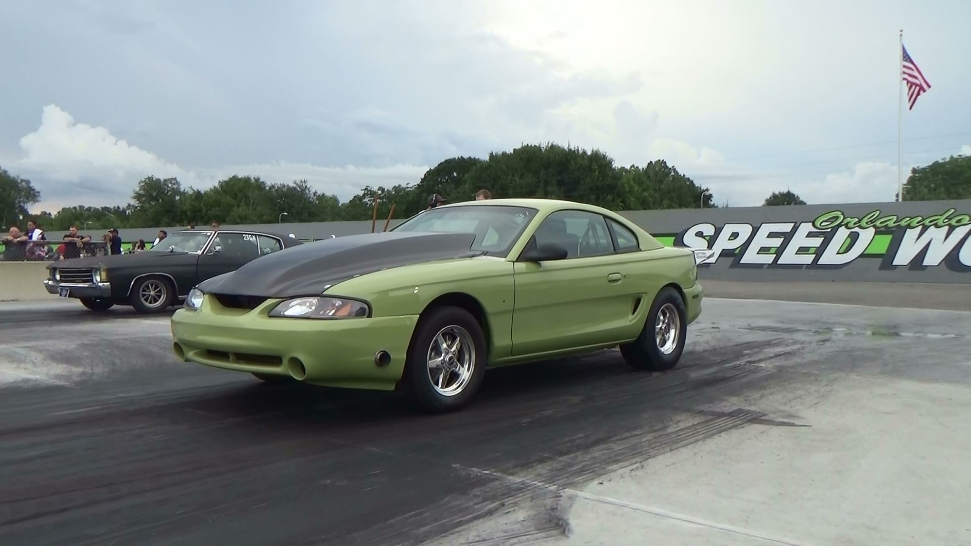

So the day have finally come! Doing my best no rain dance right now! Still have some work to do in the interior, but it can wait it is time to have some fun! We also put a 28" tire on for the track.

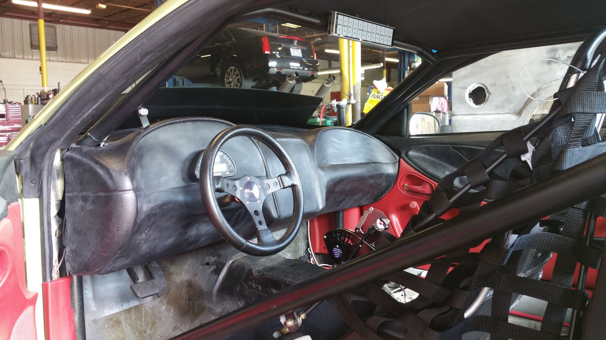

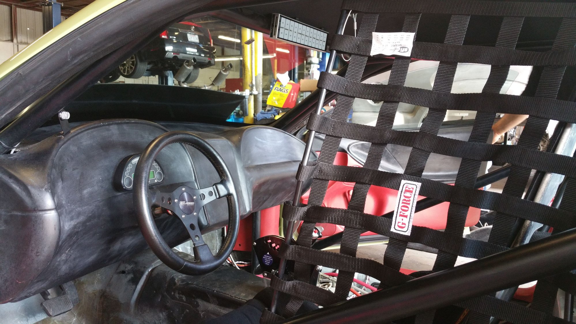

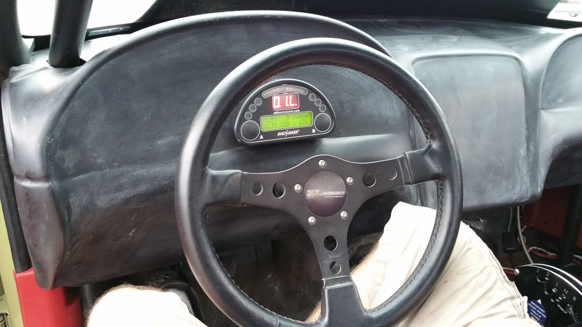

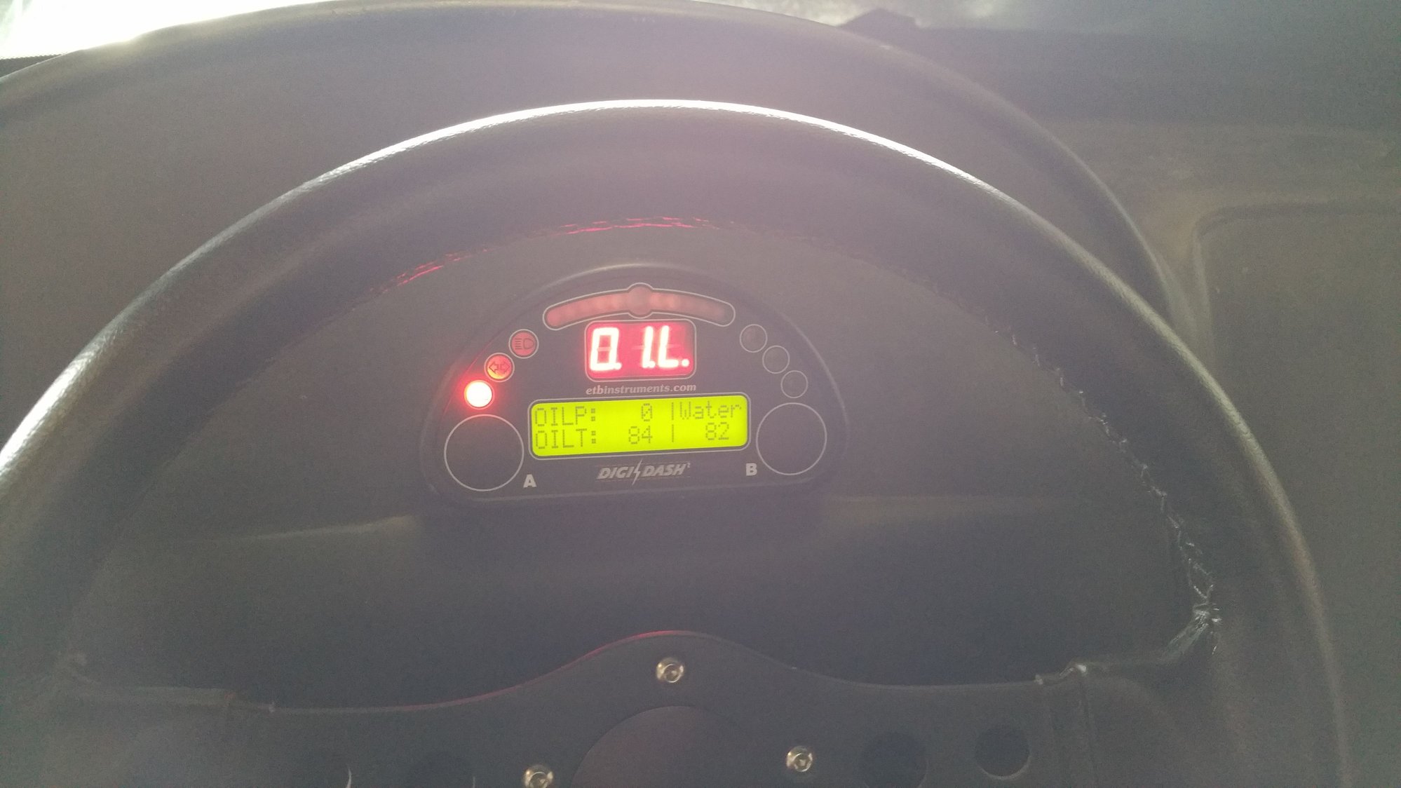

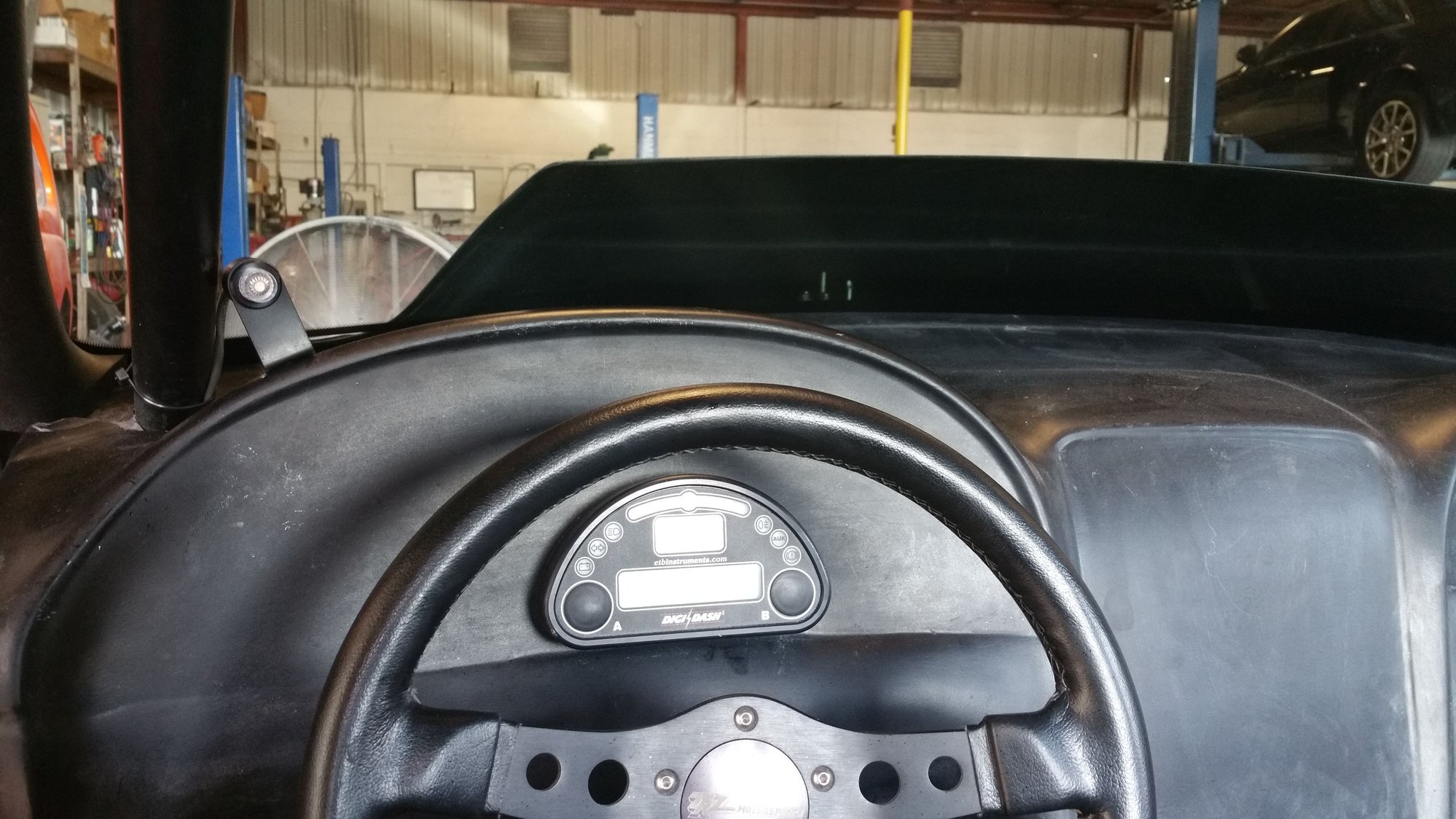

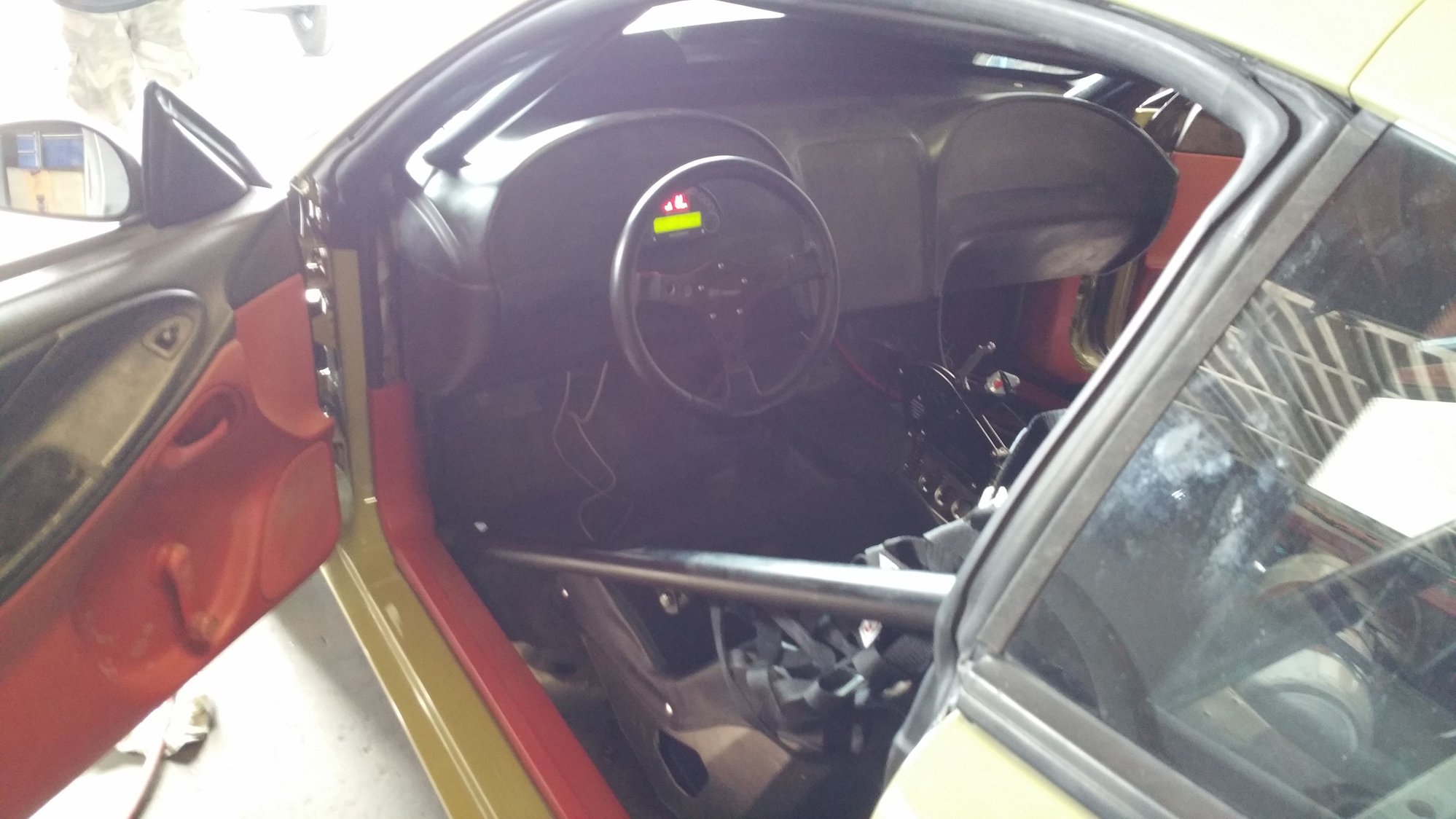

Added a shift light to dash
Swapped the 29.5's for a 28 <br/>

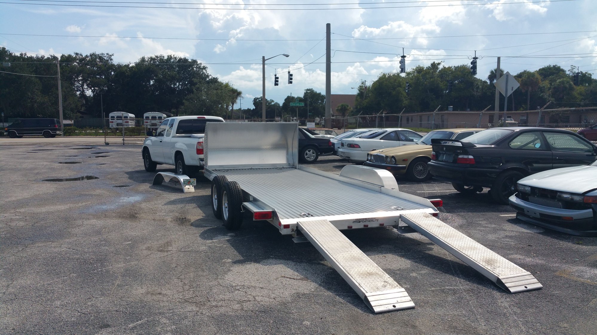

Tow rig ready!
All loaded up

Eclectic parking lot collection at the shop...see a few things I like.
Whats up with the Tundra? 2wd?

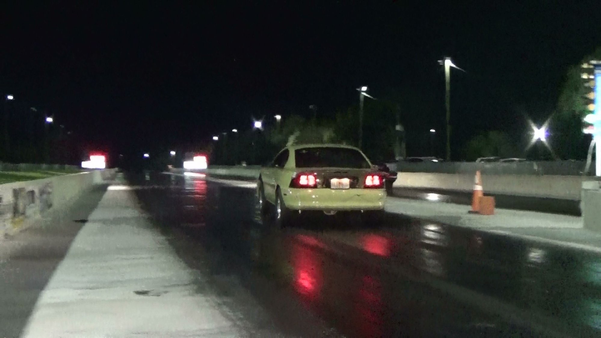

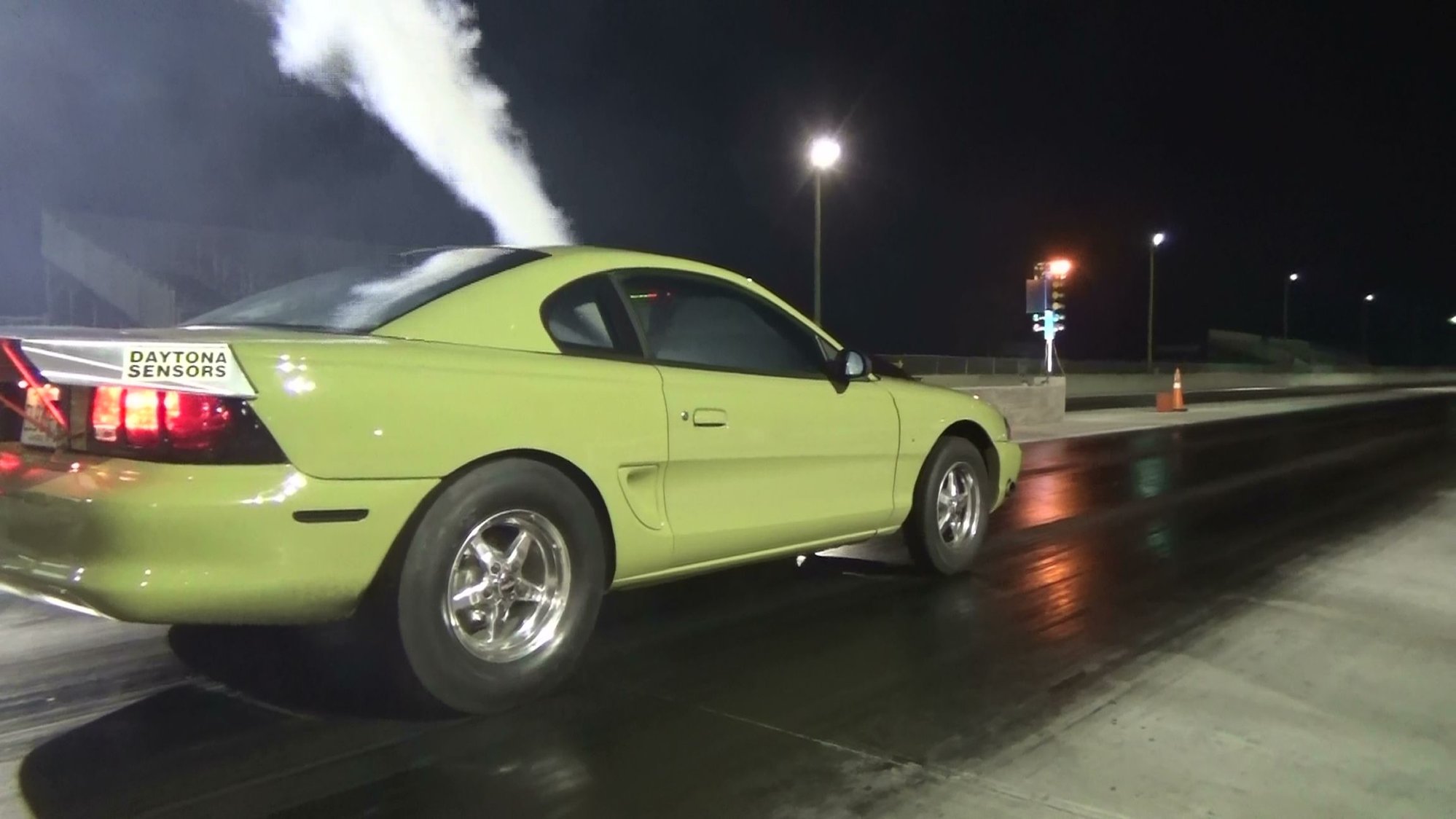

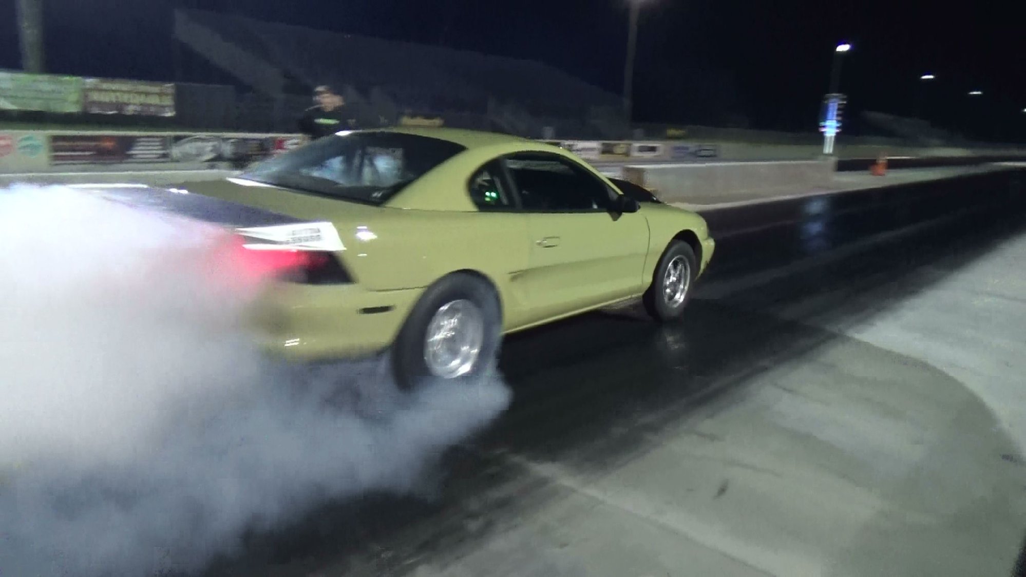

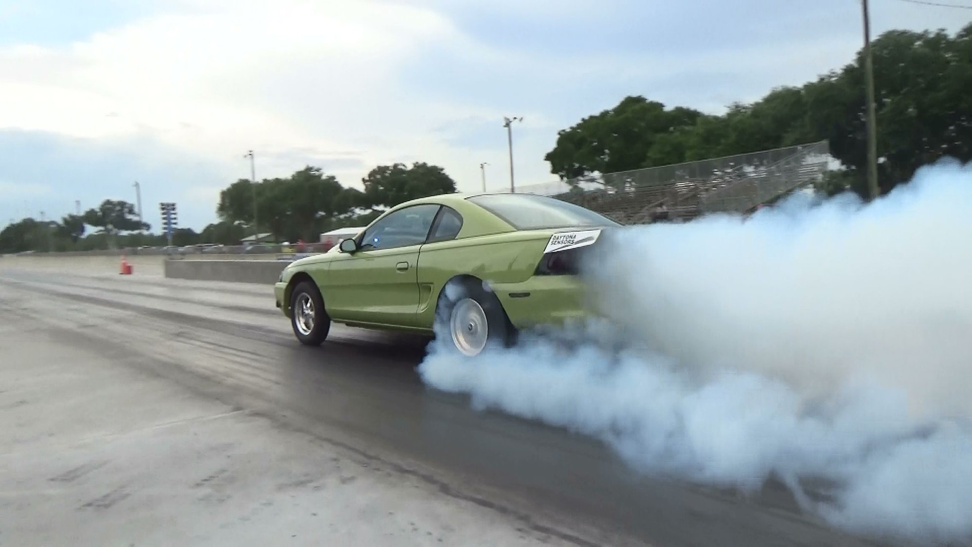

Had quite a few small gremlins, which I guess can be expected since everything on the car is new. Also found out that the converter is way tight on the motor. Car comes alive on the spray, but we had a few settings wrong on the progressive so it was only spray 50% for a second and then would shut off. Anyway here are a few pictures and videos from last night.
The first video is a motor pass, but the throttle pedal bent so we didn't have full throttle the whole pass. The second is the wheel stand.

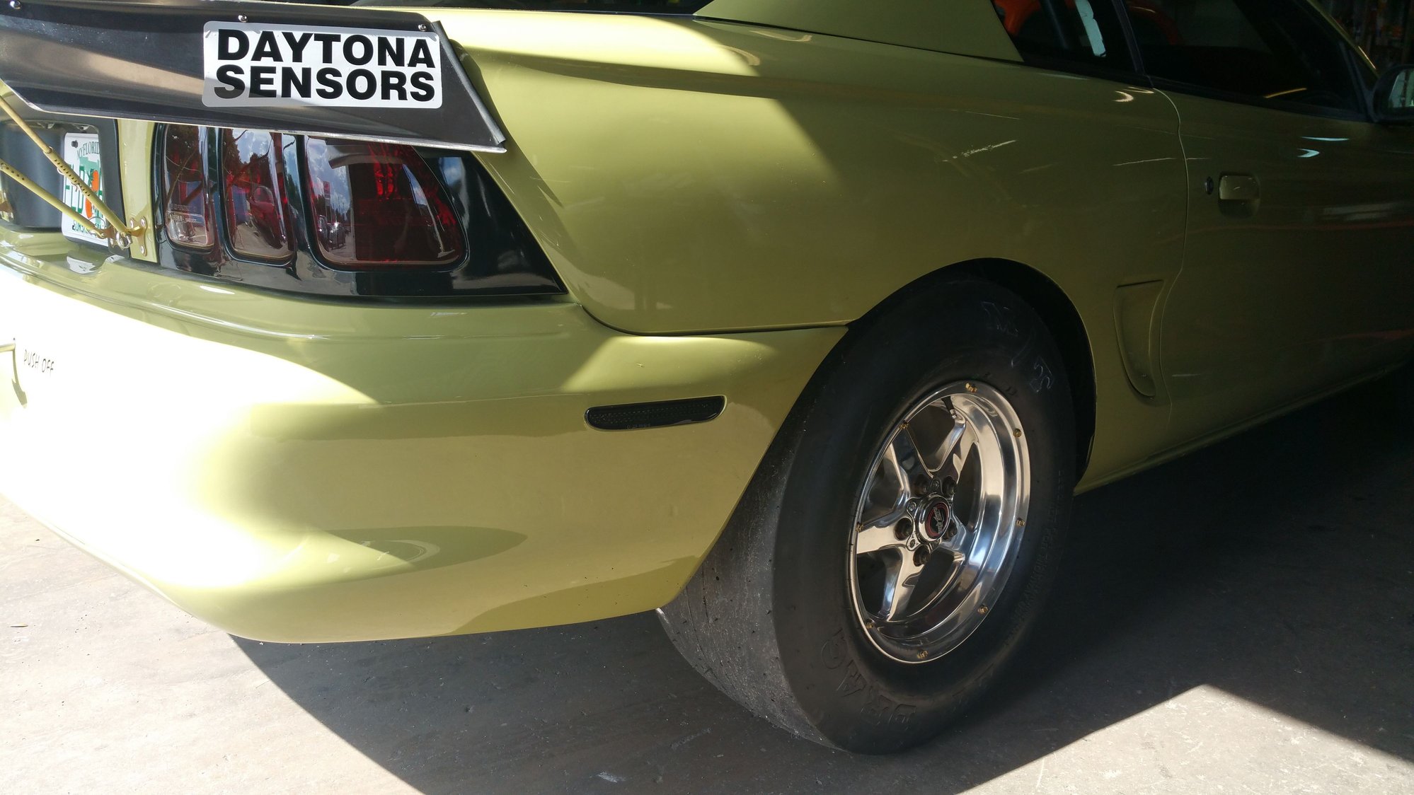

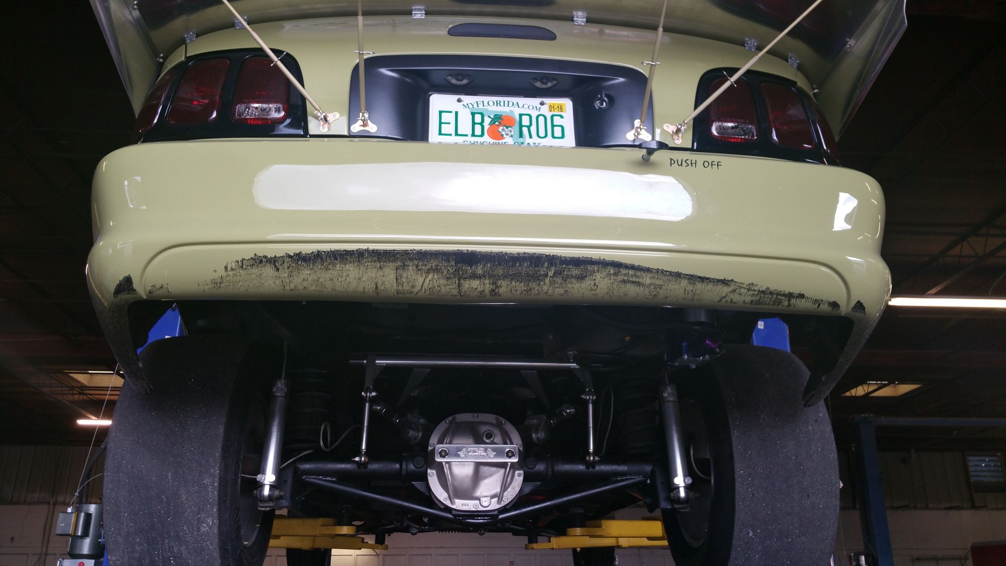

Nothing but the rear bumper!

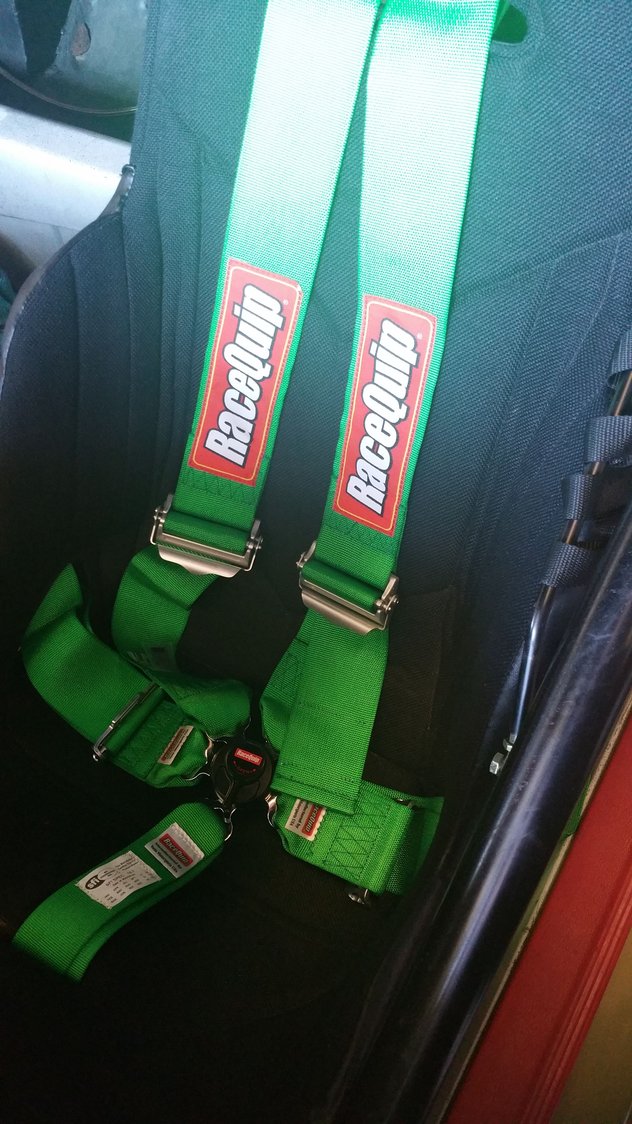

Thanks, Daytona Sensors for hooking us up with new green belts and sfi approve helmet!
