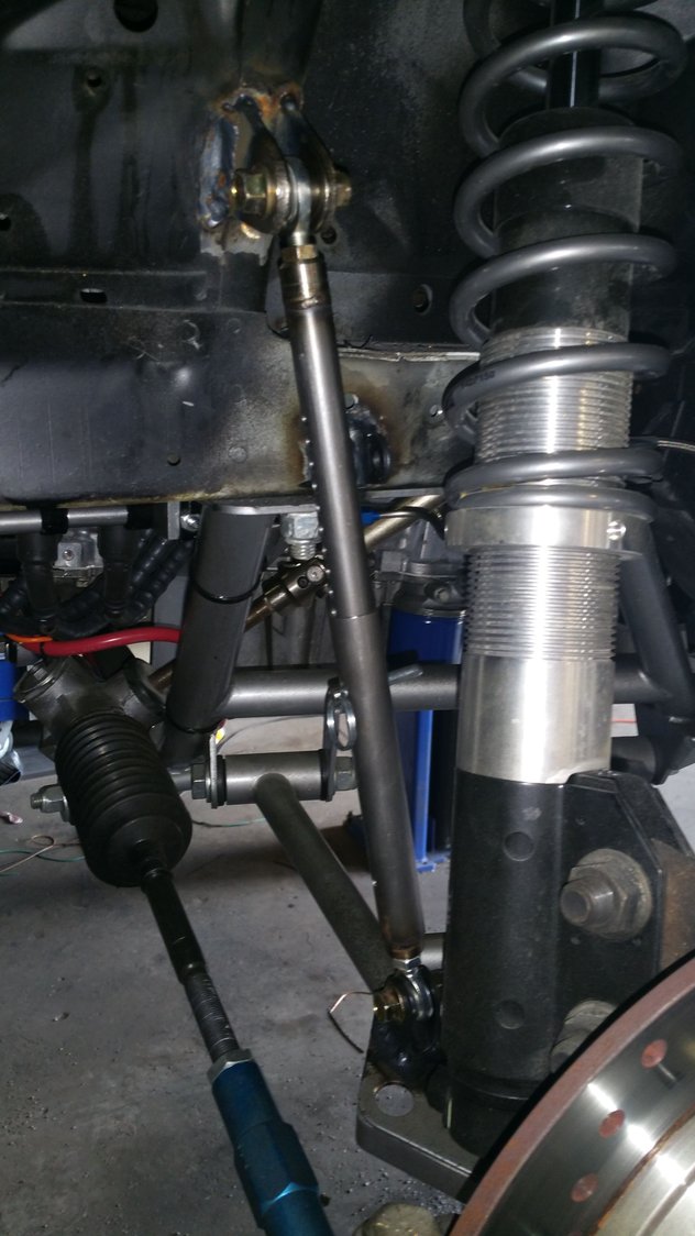

travel limiters on your list of to-dos? they should be!

Yes about to order them from innovative racecraft. Down loaded the logs and videos this morning. If it leaves on the kit it comes up.

Limiters are a crutch for shocks with improper valving. I would imagine you would save yourself quite the headache getting them revalved or going with a different shock in front. We had hell with limiters because the shocks just had too much potential energy in the front. PM me if you want to talk about it more.

We plan on swapping front struts I am waiting on viking double adjustable fronts to become available for the car. Right now it has strange singles on the front and viking doubles on the rear.

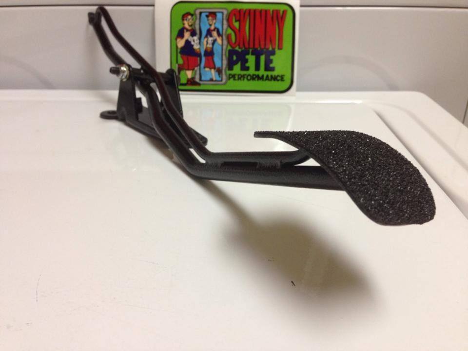

Finally, ordered limiters to try and keep nose down. Also ordered a new gas pedal. Maybe now the car will actually go full throttle all the time! If you are swapping a sn-95 don't use the stock pedal.

Where did you get those limiters from?

Troy Perez JR at Innovative Racecraft.

Those travelers are amazing. Best looking ones Ive seen so far. Good stuff.

What's wrong with the stock pedal? Not enough travel?

limiters ordered. Thanks.

Putting limiters on today. In the mean time here is a short in car video.

Limiters are in time to test!!!
