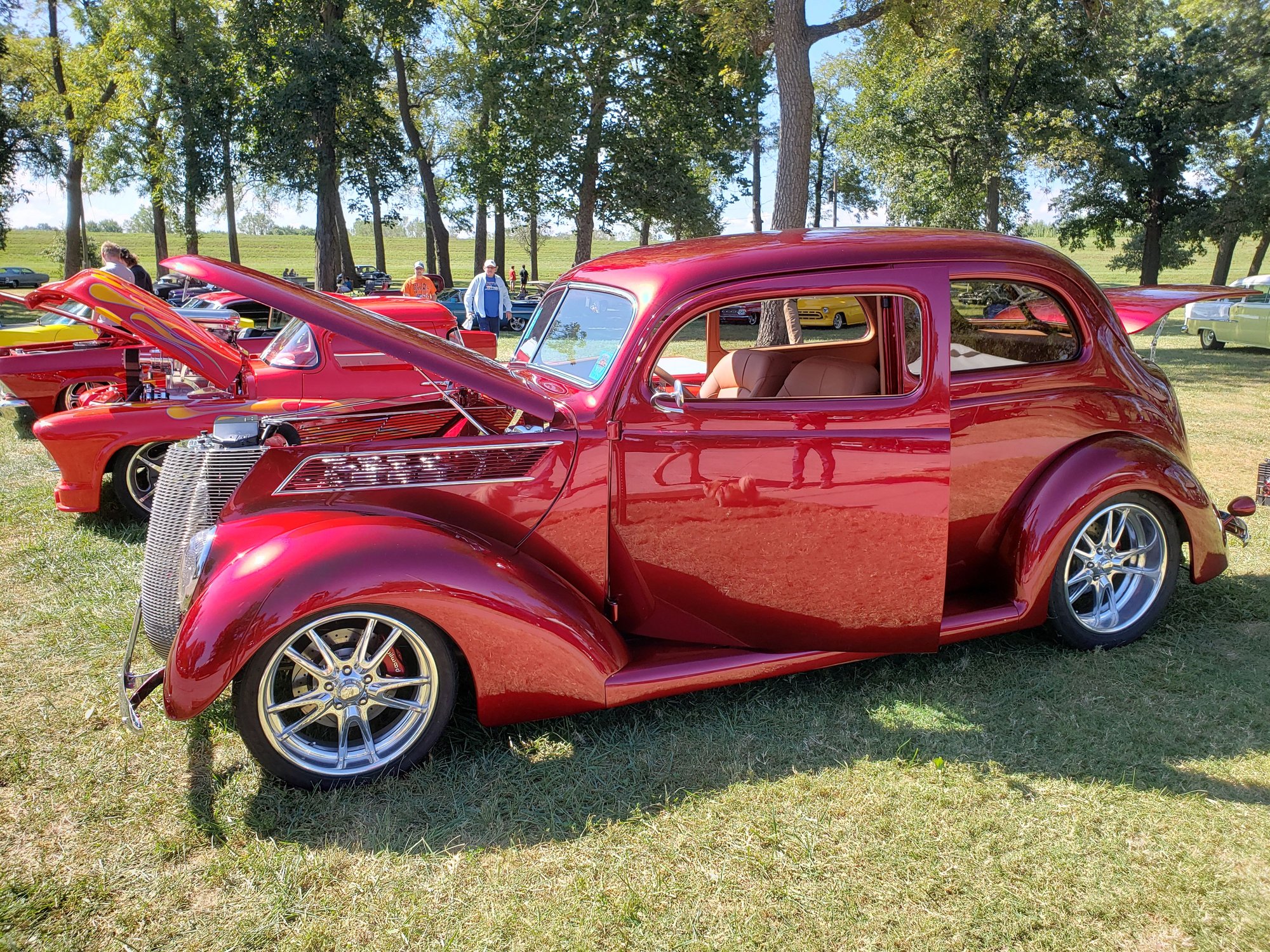

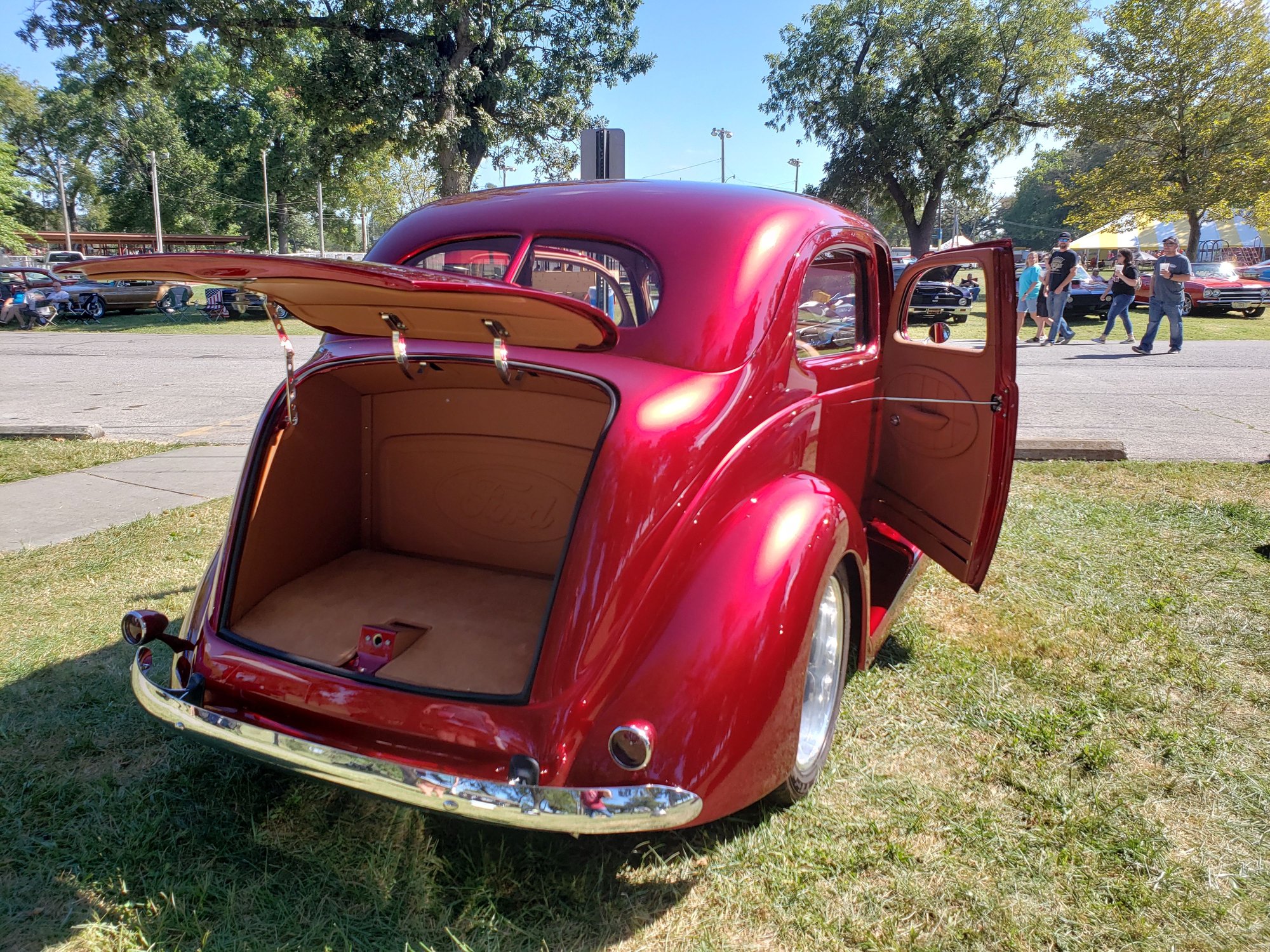

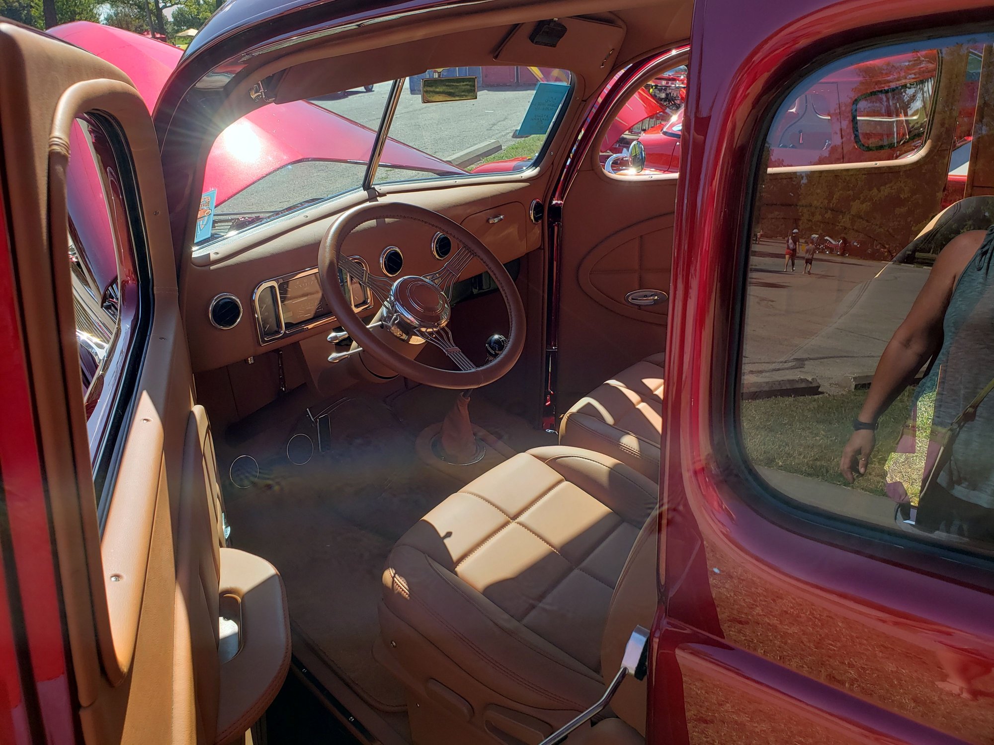

Saw this car this weekend at a local show. Thought for a minute that you had the car done and were holding out on us! LOL It was a super nice car, and an obviously new build. It had a Ford small block in it though....

Thanks for posting I like the car ALOT! Gives me hope

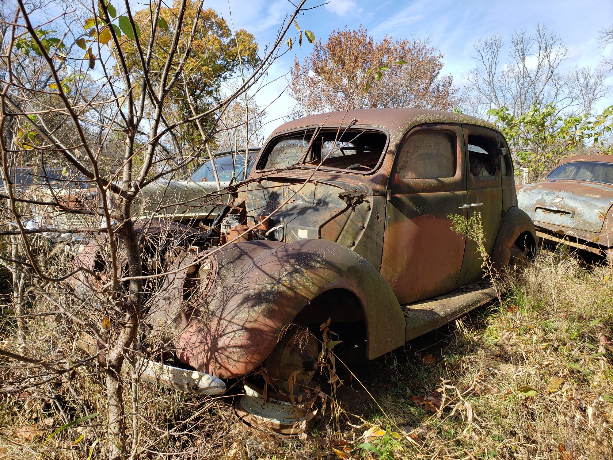

So, I'm going to need you to finish this thing so I know all the ins and outs on a '37. Found this over the weekend and am seriously considering building another car! It's a pretty solid car, and the price is right...

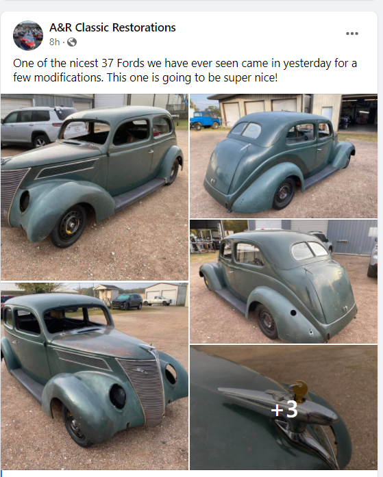

Eric looks like a cool project to me! As of yesterday my shop is currently empty . I've been waiting on the call from the body shop, The national part shortages worked in my favor last week as the body shop had some cars that were hung up on parts so mine got in a couple months early woo hoo!
Dash out, motor out, wiring out. Put the shell together to get ready for some steel work and some glass work. No paint yet. Going to drive it ugly and get all the bugs out.

Awesome! Did they give you any kind on estimate as to when you'll have it back? If it comes back fairly quick you may be able to assemble it over the winter and be driving it next spring, no?
Also, I can say I have never seen a locking hood ornament before, that's pretty cool!
