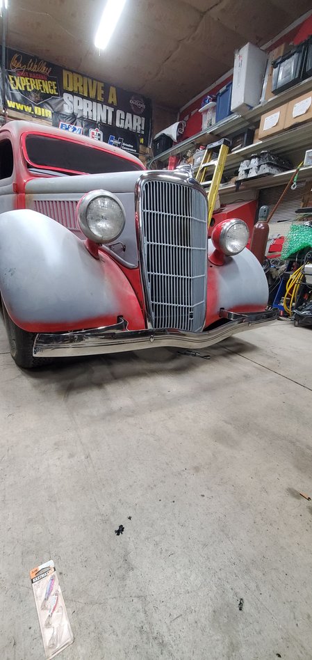

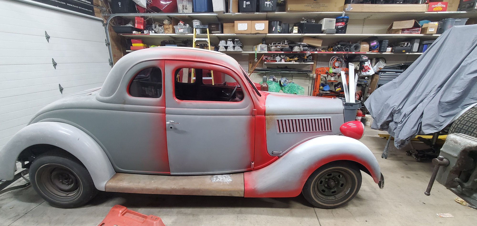

The car has been home for a little while, but I've been recovering from foot surgery. Thanks to Alan and Ronnie (A&R owners) for delivering it home since I couldn't drive. Here are some before and after pics.
Before
After - hinges removed, hidden hinges installed, fenders reworked for clearance
