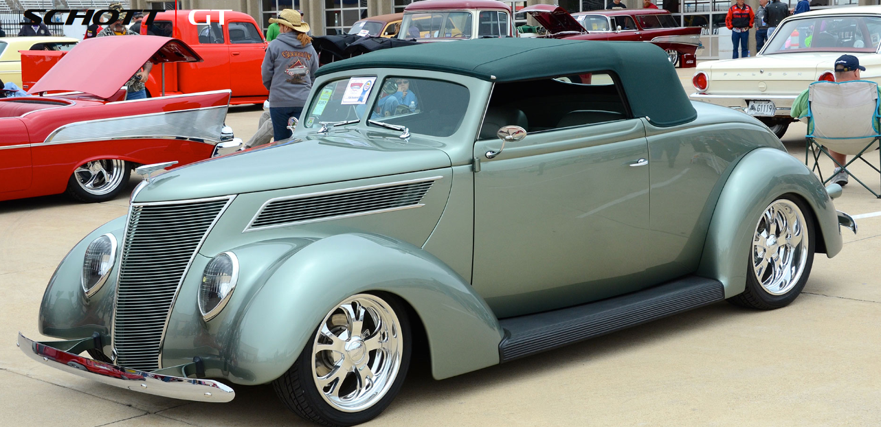

Wheels on order......loooong lead time . While I'm waiting on wheels I'm finishing knick knacks and nothing exciting or really post worthy, BUT I did get rid of the ugly exhaust tail pipes I had thrown on there just for cranking purposes. I wanted to barely see the exhaust and angled it down 20 degrees to get it away from the car but maybe not throw up any dust in parking lots. Also spent a good bit of time trying to make them even from side to side. Should be plenty good to start out with. Cranked it today and let it get up to operating temp
Old Jul 30, 2023 | 07:41 PM
  #727
ls1nova71's Avatar
Joined: Jan 2008
Posts: 4,406
Likes: 211
From: Liberty, MO
Exhaust looks good! What wheels did you go with?

Wheels are made by Schotts. They had this pic their gallery.
