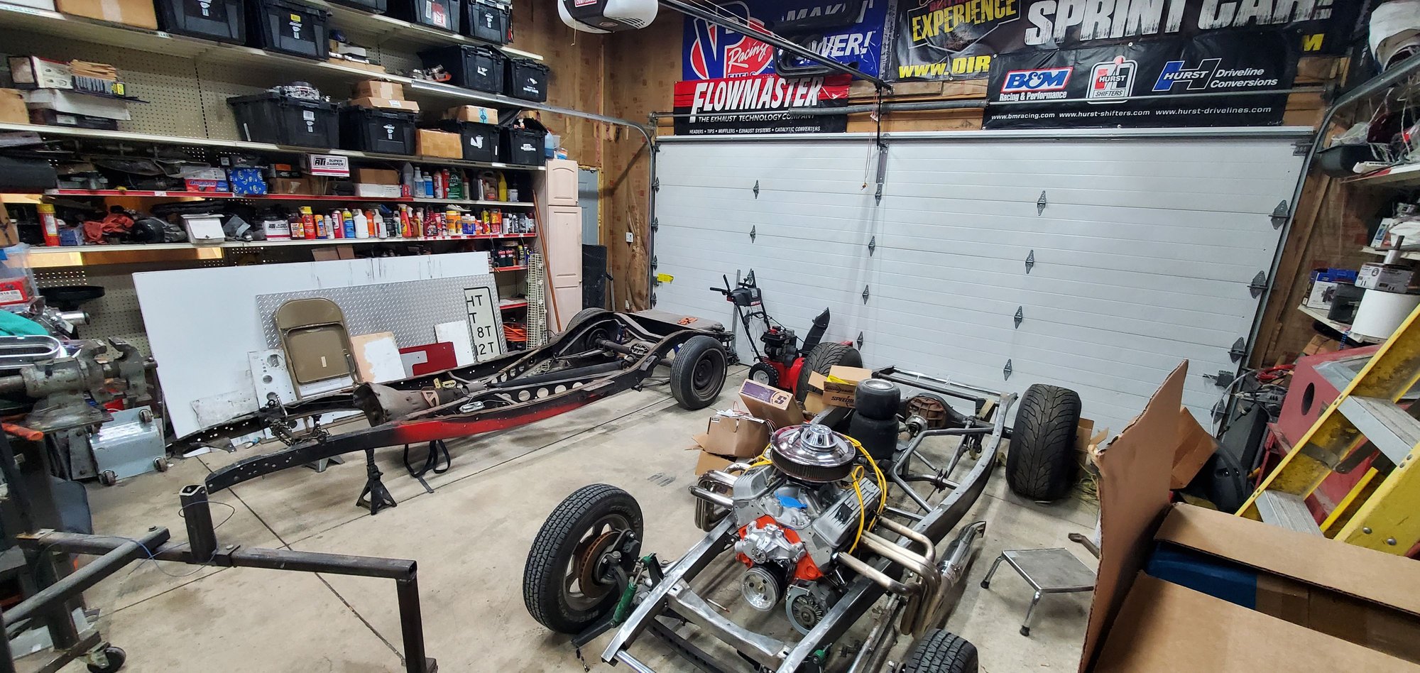

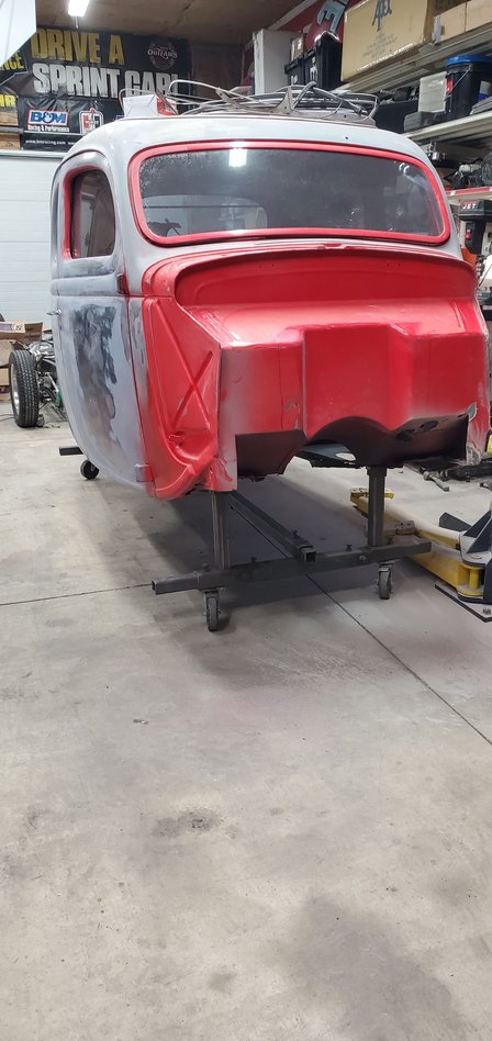

Not to hijack your thread but since you had asked if I had started a build thread on my 35 I figured it wouldn't hurt to post a couple pics here before I really tear into it and start my own build thread.
So far I figured out nobody makes the correct style fenderwell headers and there is no room for inside the frame headers that left me no choice but to go to a mustang II setup, While I was at it I found the firewall needs to be moved rearward to make the LS engine fit comfortably and will need to go back further yet if I decide to drop my 6/71 blown 408 into it.
The stock X member isn't going to play nice with my 4l80e so it's getting a fully boxed frame and speeway motors tubular X brace. I'm also trying to decide if it's getting a triangulated 4-link or parallel 4-link. I have plans to narrow/tub the rear for a bigger tire but how wide will depend on the engine that ends up going in it.
I know I won't be happy with a narrow wheel and with 500hp to 1,000hp it would be kind of pointless to have that kind power and no way to get it to the ground.
So here is where I'm at today. Frame on the left is my 35, The one on the right is my son-inlaws 32 we are building.
The body waiting to go under the knife.
