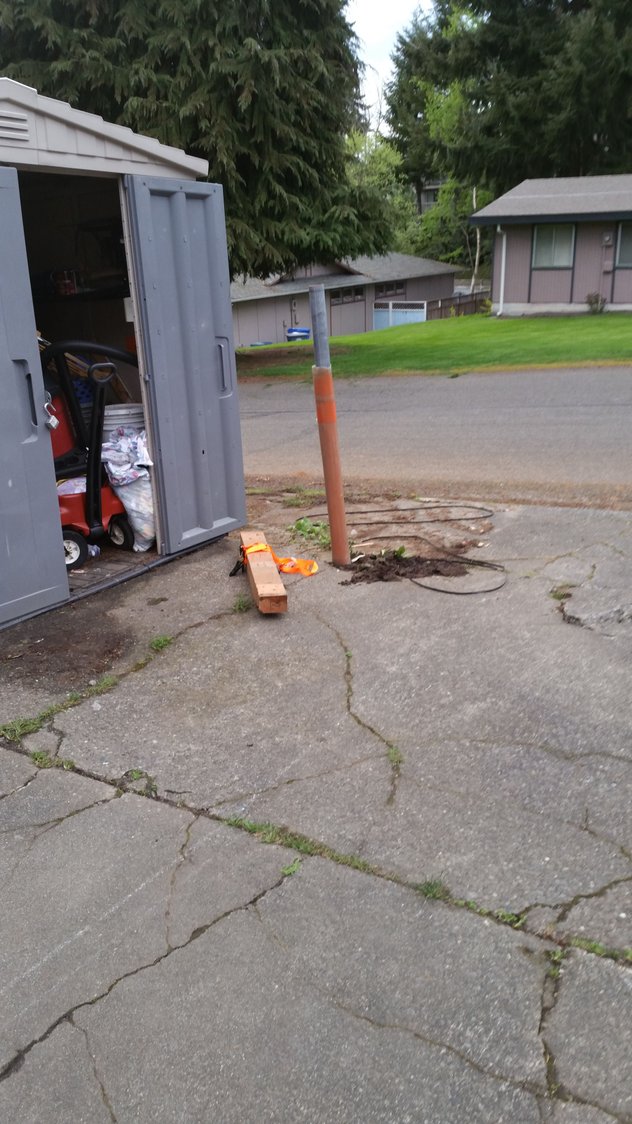

The eagle has landed! Picked it up this morning.....
put on my work shoes
Then tried to find a way to take it out, not hoist atm... oh right in my driveway. Pole, meet ratchet straps
I used the ratchet straps to pull the pallet, motor to the edge of the truck, then backed up on the lower part until the engine stand was about 2 inches off the ground.
now.... my motor on a stand...
