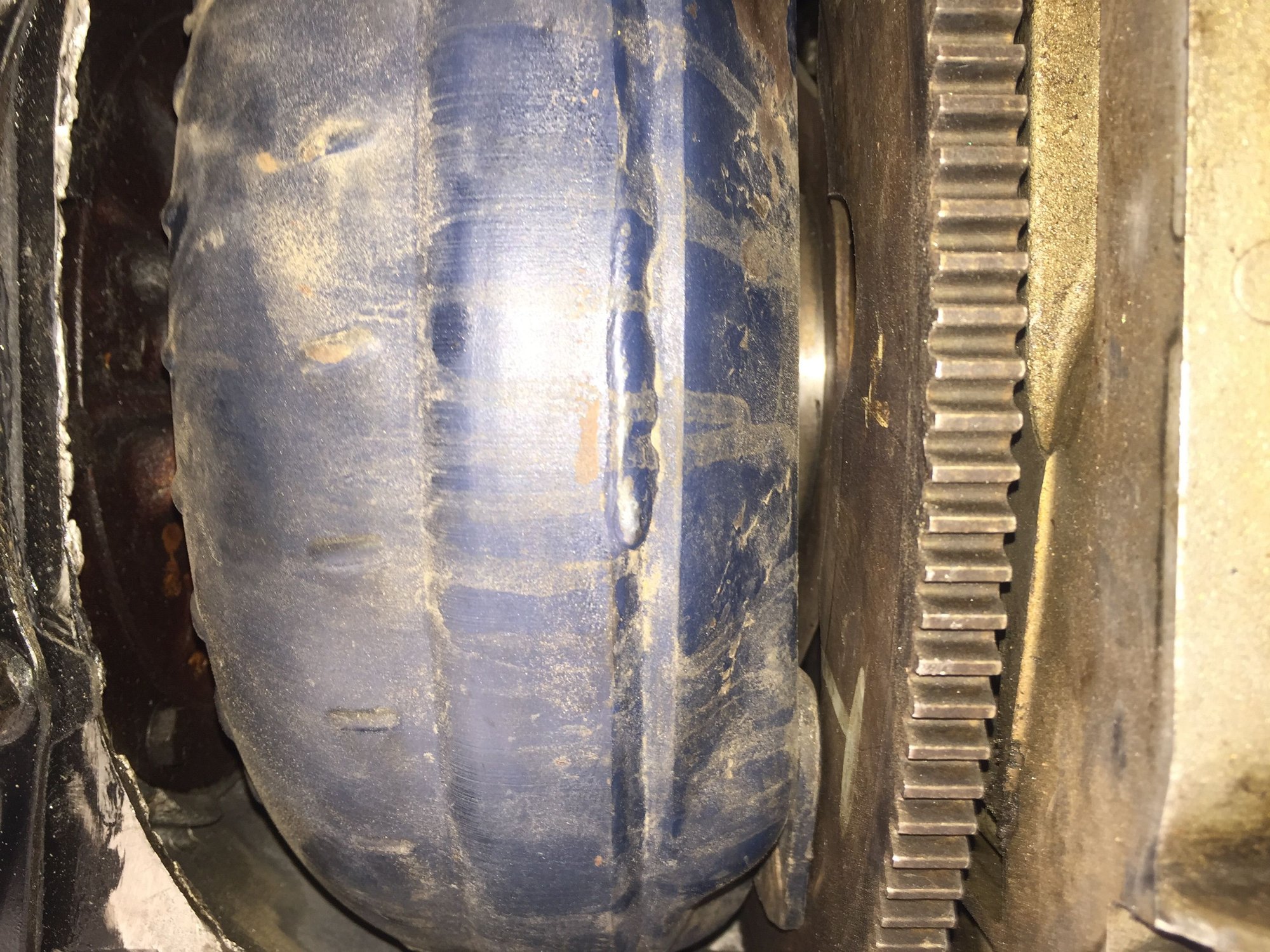

sounds like the torque convertor is not turning the pump gears in tranny pump. you shouldnt be able to get any fingers between torque convertor and tranny case in front of pan. If too far out it wont turn pump. other I would say pump gear is broken. If it was enguaged it would spit fluid out.

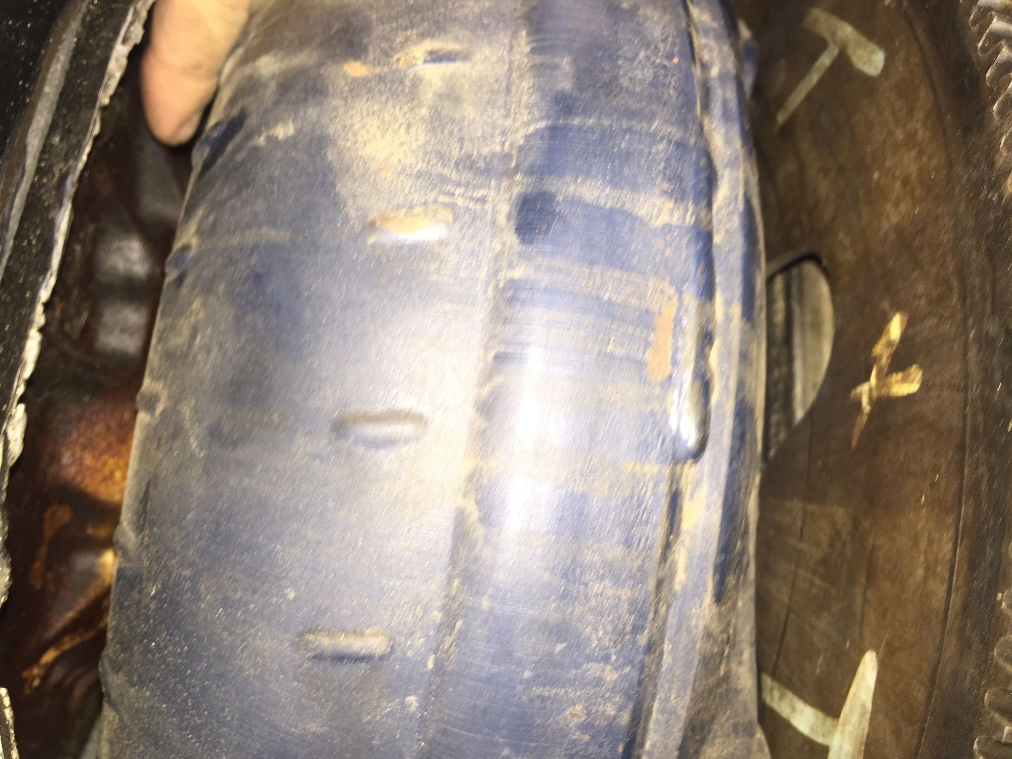

I went to check on the spacing I can barely get the tips of my fingers in there, not sure how else I can space the torque converter to get it to sit further back. I've tried some machined flat washers maybe a 1mm thick and it didnt help what so ever. Also when I put the washers the converter only moved 1/4-1/2" back and forward like it should?
not the greatest photo but heres the spacing

I done this same thing in past. the 2 ears that convertor enguages in front pump of tranny probably broke. pump cant be turning otherwise you would have fluid pressure. only way to know is pull the tranny & look behind seal for the notches on gear. do you have the adaptor on back of flywheel to center convertor?

normally you cant get finger tips in bottom(pan side) btween pump and convertor when all the way in. Are you able to get tranny and block tight together without forcing it tight? When tranny out there should be 3 clicks to get convertor all enguaged into front pump.

well if tranny mated to motor ok and torque convertor spins free your probably fine. If it don't turn freely then its not seated in pump rite. If spins free and you fell it needs to be back a little bit just put a washer between convertor & flywheel.
