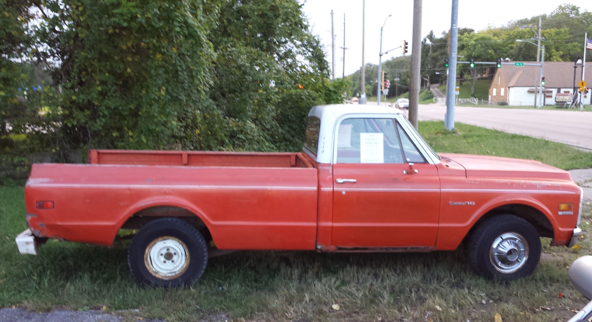

Since I haven't had much time to work on the C10 I'll just give a little background on it.
As it sat on the side of the road 2 years ago for $1000
