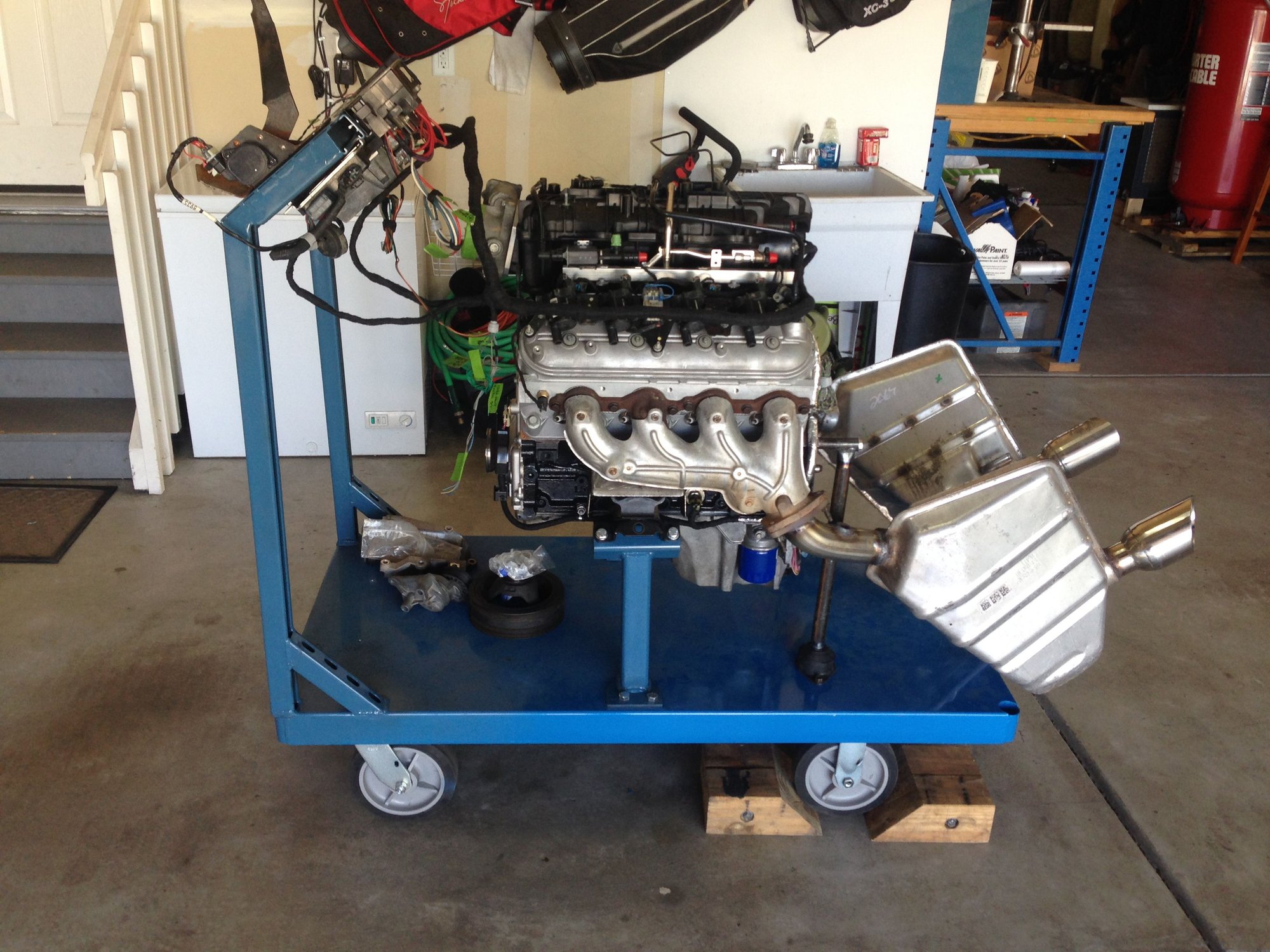

Here is my first run stand.
Sold it and built a better one.

The mufflers are off of a Gen 5 Camaro SS, got the entire OEM cutback for $20 off craiglist. I wanted something that has the CFM required but was still fairly quiet so I can hear the engine itself. You're run stands look great!

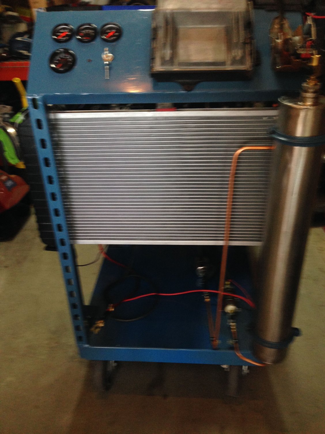

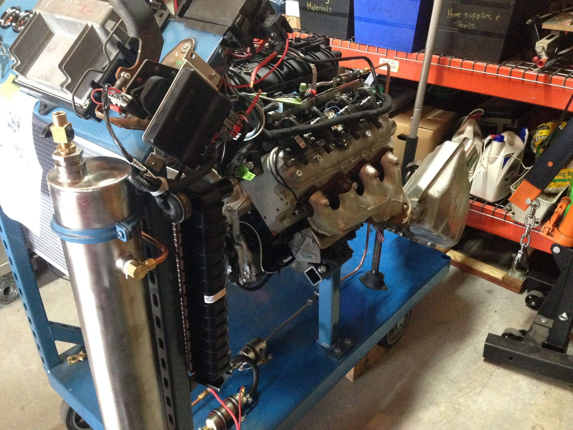

Built a SS fuel cell and used that inline pump ($25 brand new off Craigslist) and the Vette filter/regulator. Haven't run the engine yet but did run the pump and check for pressure and leaks. Looks good to go!
SS fuel tank
Pump and filter/reg

Default It lives!!!

Needs electric cooling fan and detachable bell housing cover for flex plate. Thx for not being stupid and pointing the exhaust directly at the control panel like other commercial versions.
Lots of fun testing on the engine run stand, huh. :-)

Picked up the e-fan and accessory bracket today so I can finish the cooling system. Gotta find a T56 anyway so I guess I could use its bell. Looking forward to running it at length once I have the radiator tied in. Only ran it for a total of about 20 seconds so far...

I love the variety I see in engine test stands. Some are absolutely scary contraptions waiting to maim while others are almost works of art designed by an engineering mind. Yours and aknovaman's fit the latter category.
I love the fuel tank, but it's a bit on the overkill side isn't it? Haha
Although I had to laugh at the battery hold down and temporary radiator cap.

Yeah, the clamp for the battery is funny looking. I got anxious to run it so I borrowed the battery from the car. It will be engineered properly soon enough. The "temporary" radiator cap was only to keep stuff from falling down in there, radiator wasn't connected at all during the video. As for the fuel tank, yep it's a bit overkill but as is the case on most of my projects I have more materials and fabrication time then money. It was cheaper to buy some stainless scrap from my employer and spend an hour tig welding it up then buying a fuel cell.
