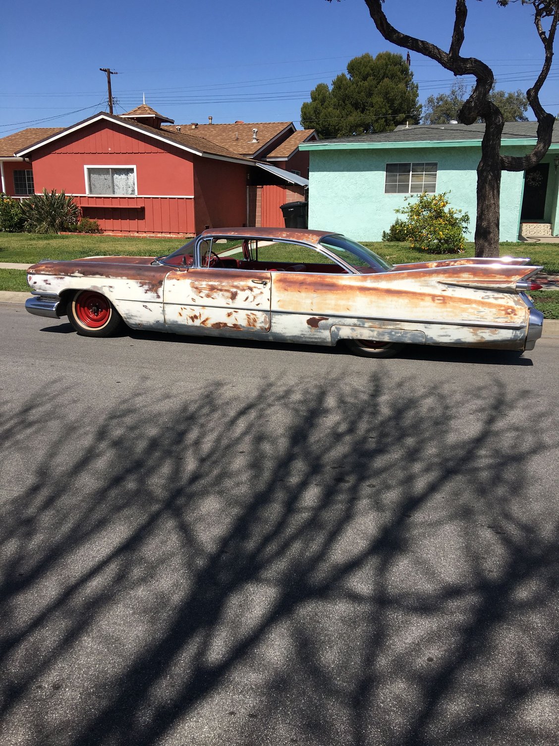

anyone done a 59 caddy ls swap? i bought a 59 cadillac on friday and i bought a 6.0 lq9 with 4l65 trans off a 06 ss truck. anyone have pointers or tips on what to do? fuel tank? gauges? do i need to cut anything?

This one is it

Wow that 59 looks solid. I think that would be an awesome swap. A couple years ago, I almost bought a 61 to do a swap with and decided to stay focused on the current build.
There was a build somewhere I remember reading and I recall there was a lot of fab work on the front crossmember.
Please keep us posted on which way you decide to go with the build.

That is a great looking Caddy. I love the patina. This should be good. Maybe make it a hot-tub Caddy.
