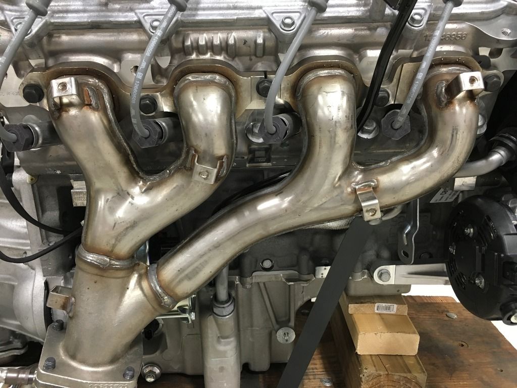

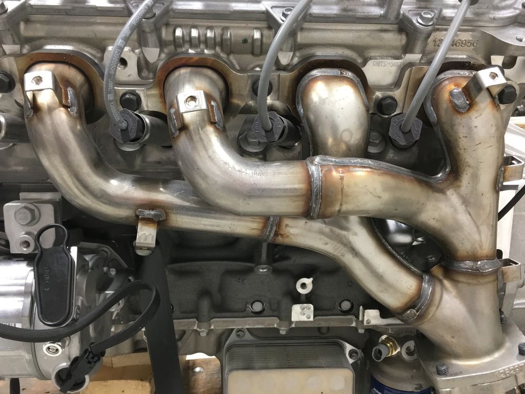

interesting it looks like tri-y manifold.

Yes, they are a tri-y type layout.

Very cool!! What are the diameters of the pipe and collectors if you don't mind my asking?

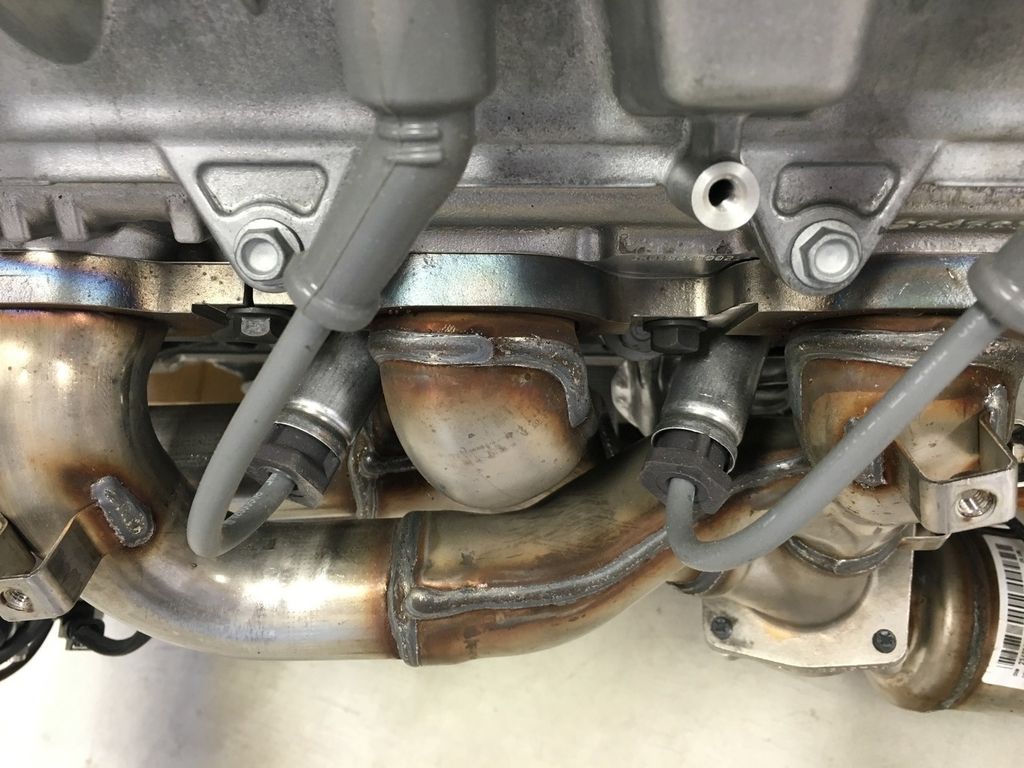

Any idea why the drivers side manifold doesn't have perimeter welds on the front two head tubes but does all the rest?

I don't know the dimensions of the exhaust or collectors right now but they are fairly small. They don't really look 650 horsepower size!!

Looks like cylinders 1 and 3 have tubes and I bet they have welds on the inside. The other cylinders have constructed sections and are welded together. I bet it has to do with fixturing, and robotic welding.

It's hard to tell from the angle of the pic, but none of the tubes are perimeter welded to the flange. It's some kind of clam-shell construction where different pieces are welded together, either to form the tubes or to add heat shielding.
Here's a view from the top.
