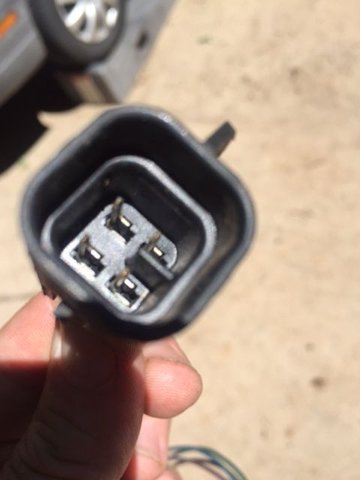

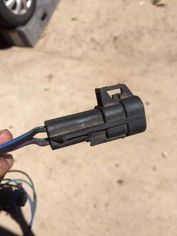

I dont know where you could get the plastic part other than off of another harness. Junk yards are full of them if you have one near by. As for getting the terminals out, I just used a paper clip. Just stick it in the hole part under the part thats sticking up, wiggle ot a bit and pull from the back side. There is a small tang that needs to pe pressed in to release them. Then it needs to be pushed back into position before putting the terminals back in. These pics arent the best, but I think you can see the tang I'm taking about.

As mentioned it's in the hole and on the same side as the metal protruding, you have to push it through and all the way, then just pull it out the back. When you re-install it, you have to push the metal tab back down into it's original position. Then put the connector back together.
