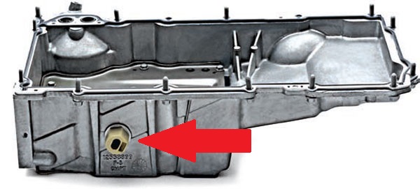

I have three senders on mine, two pressure senders at the back of the valley cover (extra one tapped in to the side of the riser for the OE oil sender. The third sender is oil temp, and is connected down by the oil filter, on a boss for my Improved Racing oil cooling system.
Old Jul 17, 2017 | 11:21 AM
TipsyMcStagger's Avatar
Joined: Feb 2007
Posts: 904
From: FL Gulf Coast
I put my oil temp sender in the pan where the factory quantity(?) sender was located.
Tipsy
