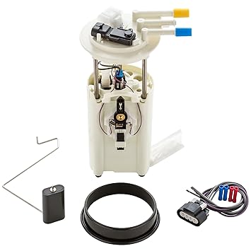

Here is the 04 Yukon Flex module, it does not have a vent or a return (not sure which) but if a new pump won't fit directly on the S10 module it may be easy enough to graft the S10 upper to a Yukon or other lower.
A '99 Yukon 5.3 pump looks more similar to the S10.
When I get a chance I will stop by the parts store and take a look at some modules.
I am looking at some 25+ gallon tanks but it may be a lot of effort for little return, and even 15 mpg would get me as far as my 2500HD, a gas sucking pig getting 12 mpg with a 24 gallon tank.

The 04 Yukon bucket has fuel out and return. The vent must be somewhere else on the tank. The return always goes back into bucket. The idea is to keep pump submersed in fuel, and when you goning around a corner and fuel moves, the submersed pump always has fuel to deliver to engine (no tank baffle needed). Air is an enemy and shortens pump life. There are a series of check ***** in bucket that help prevent air being sucked.
The earlier 99 5.3 module (if it fits) would eliminate any uncertainty. Since you are early in the swap, buy a correct ohm reading fuel guage for the modern fuel bucket. I wish mine was that way. I'm using the 1978 0-90 ohm sender. The new ones are better in my opinion.

Originally Posted by 243
That is a good point, in the short time I have been reading the forum I have seen a lot of guy's hack-fab some awesome solutions.
Be careful with the buckets that you have pictured above. They are quite sophisticated. See the MAP sensor that is built in? This is for a true closed loop returnees fuel system. The ECU monitors fuel pressure at the pump and adjusts settings (presumably through PWM) to alter the output of the pump.

Andrew, I think that is a tank pressure sensor on the '97 Blazer, I did not connect it for the TBI and ran the vent to the charcoal canister.
