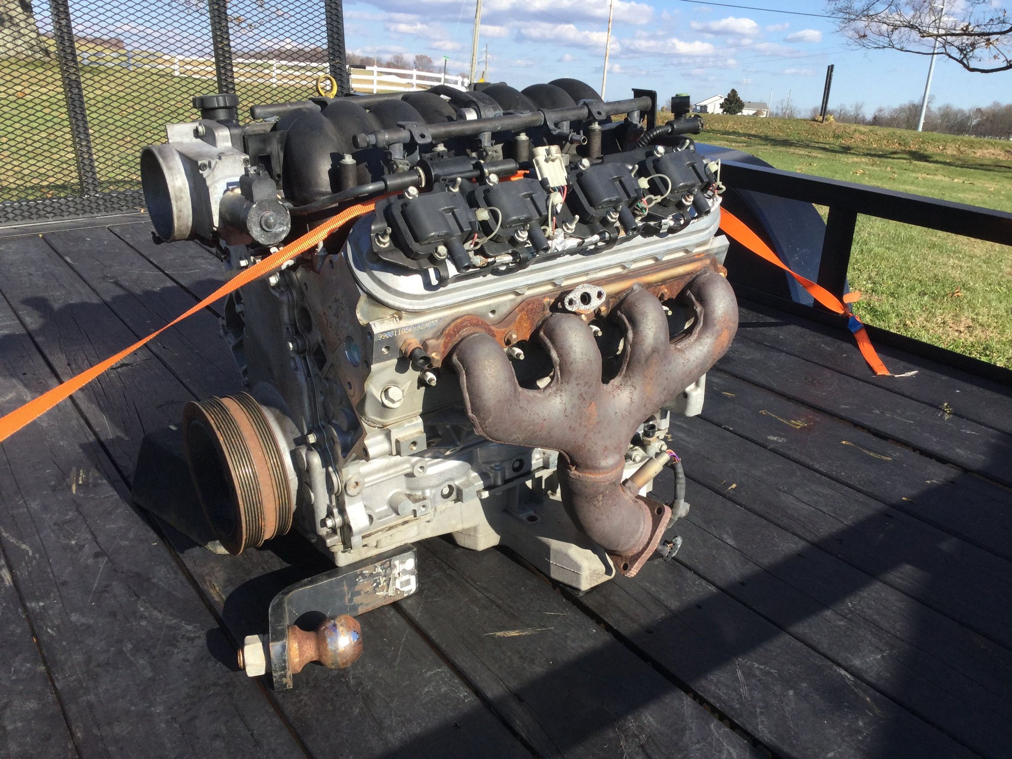

When I bought my 99 Corvette ls1 engine I did not get any of the harness or PCM. To put this engine in my Chevelle what should I be looking for to handle the electrical and ignition chores that will be pretty much plug and play?

Other than something like Fitech, nothing is going to be plug and play.

Ok, understood. So would a stock 99 PCM and harness be the best starting place, and then have the harness modified or are there other factory setups that would work just as well, understanding the the PCM will have to be tuned to my setup. If I go with a auto transmission, 4l60 etc. does it have its own pcm or would it run off the main engine pcm?
I just need to start sourcing parts and need to know what I need to be looking for.

If you can modify you own then a stock corvette harness would be your cheapest route. If you need to have it modified then you might be better off just buying a pre made harness from a vendor since you do not yet have the original harness.

Almost any factory PCM will work. Even the truck ones. If you want a wiring harness that drops right in, another vette harness is your best bet, although a truck harness CAN be made to work with enough effort.

I'd caution you a bit. The vettes are DBW, so a DBC ECM wouldn't work without additional modifications.

Did you get the TAC module and the pedal for the DBW? Because if you didn't, it may be cheaper to just get a cable throttle body since the Vett TAC modules are expensive. Then, if you change to cable TB, you could just get a 99-02 Camaro harness and mod that to work in your car. This would probably be the cheapest route if you don't want to buy an aftermarket harness.

Well you have options then. Switching to DBC wouldn't be difficult at all since you dont have a PCM or wiring harness. You could get a throttle body from a 99-02 truck for less than $50 at the junk yard and the PCM and harness too. You'd need to change the fuel injector plugs as they're different, then have the truck PCM tuned to your engine. Or you can get a corvette TAC which I'm told are like $200 used, and go that route. You would need a corvette harness, but you could modify a truck one to work, it'll just be more work.

I got a 2000 Corvette LS1 with harness, but I didn't get the pedal or TAC module. When I found that a TAC module is $450 on eBay I decided to go DBC. I got a 2000 Camaro throttle body (and sold the Vette one). I repinned the Corvette harness to match the Camaro diagrams, so it works with the Camaro throttle body and also with the standard non-Vette 4L60E. My plan is to have the PCM flashed to be a 2000 Camaro, which I think will give the PCM all of the DBC functionality. Since you don't have a harness at all, you could get a stock Camaro harness and thin it down, or buy an aftermarket DBC harness which should be pretty much plug-n-play.

A junkyard truck DBC throttle body, PCM, and repinned wiring harness would be the way to go on a budget. People have been doing that for ages. The LT1swap website is a godsend for info.
