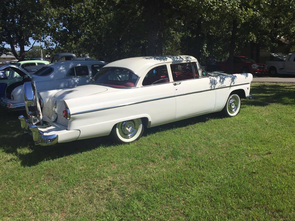

The travel trailer we will be pulling with the 55.
After years of research, I have finally decided to pull the trigger and come over to the dark side. I have been a 265/283/327 guy my entire life. I struggle starting to learn everything all over again at 50. I just helped my 80 year old dad transplant a LS1 into his 1968 El Camino and we busted it off for the first time last weekend. I learned a lot, mostly what not to do.
I have a platform that will make the Ford purists cringe. I am getting ready to pull the old Y block out of my 1955 Ford Customline and go LS.
We are within a few years of retirement and we are looking to travel the US, pulling our vintage travel trailer. I don't want to work on old junk anymore. Time to enjoy my life!
With that said, I am trying to decide what powerplant to transplant into the 55. It is a front sump like the GTO. I have a local salvage yard that is the GM outlet and they have a lot of 5.3's with less than 10 miles on them. I called Speartech and they said the later engines are harder to install and more costly, but it can be done.
The LS1's all have 100K plus these days. What would you guys do? It's not a performance type car, just a sled.
