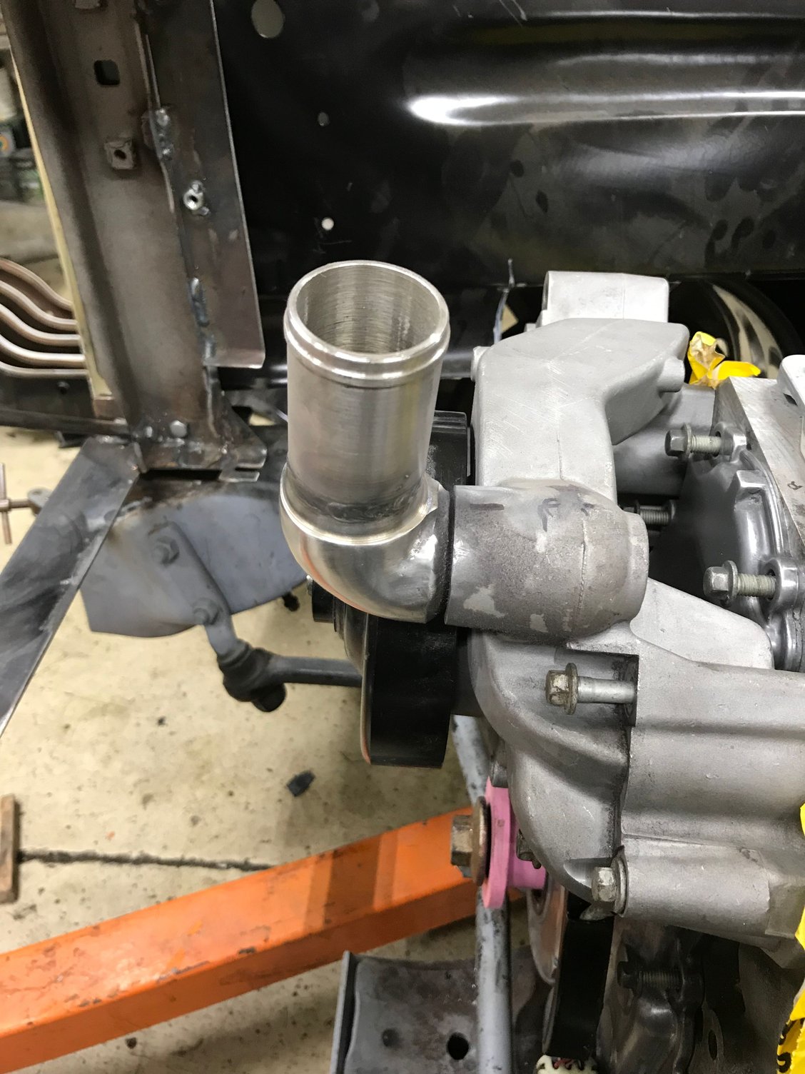

Got elbo made. Get it tig welded tomorrow and should be good.

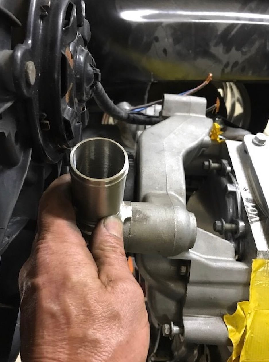

If you can fit your hand and that in...there was easily room for silicone.
Although you clearly have a lot of room there, you could have cut the tower off altogether and welded an alloy pipe to the pump and come off vertically.

A lot of room?? LMAO. The neck was 1/2 inch from fan.

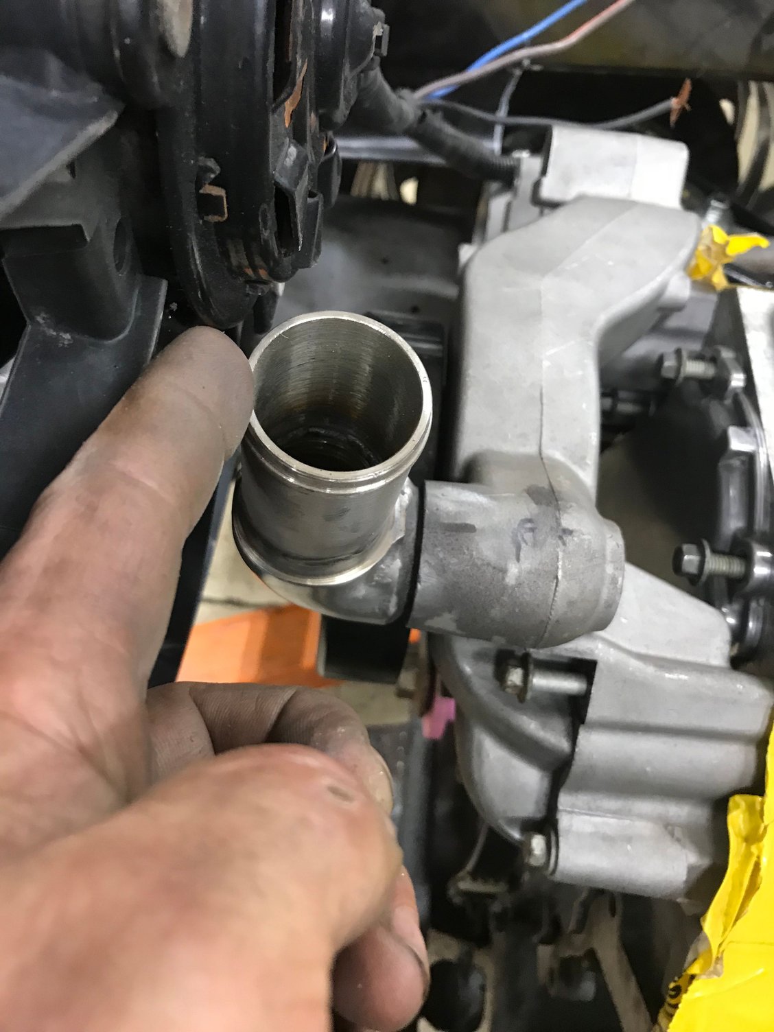

Thin fingers then ?
It's nowhere near the fan motor, and your fingers clearly have room to be there...even a skinny finger is going to be 3/4" ? And it's just a plastic shroud...no big deal.
Plenty of options there, no moving parts.

Other than the thickness of the material, a silicone 90 is about as short as you'll find for that sort of thing
but if you've already cut the pump, may as well just weld an alloy pipe onto it.

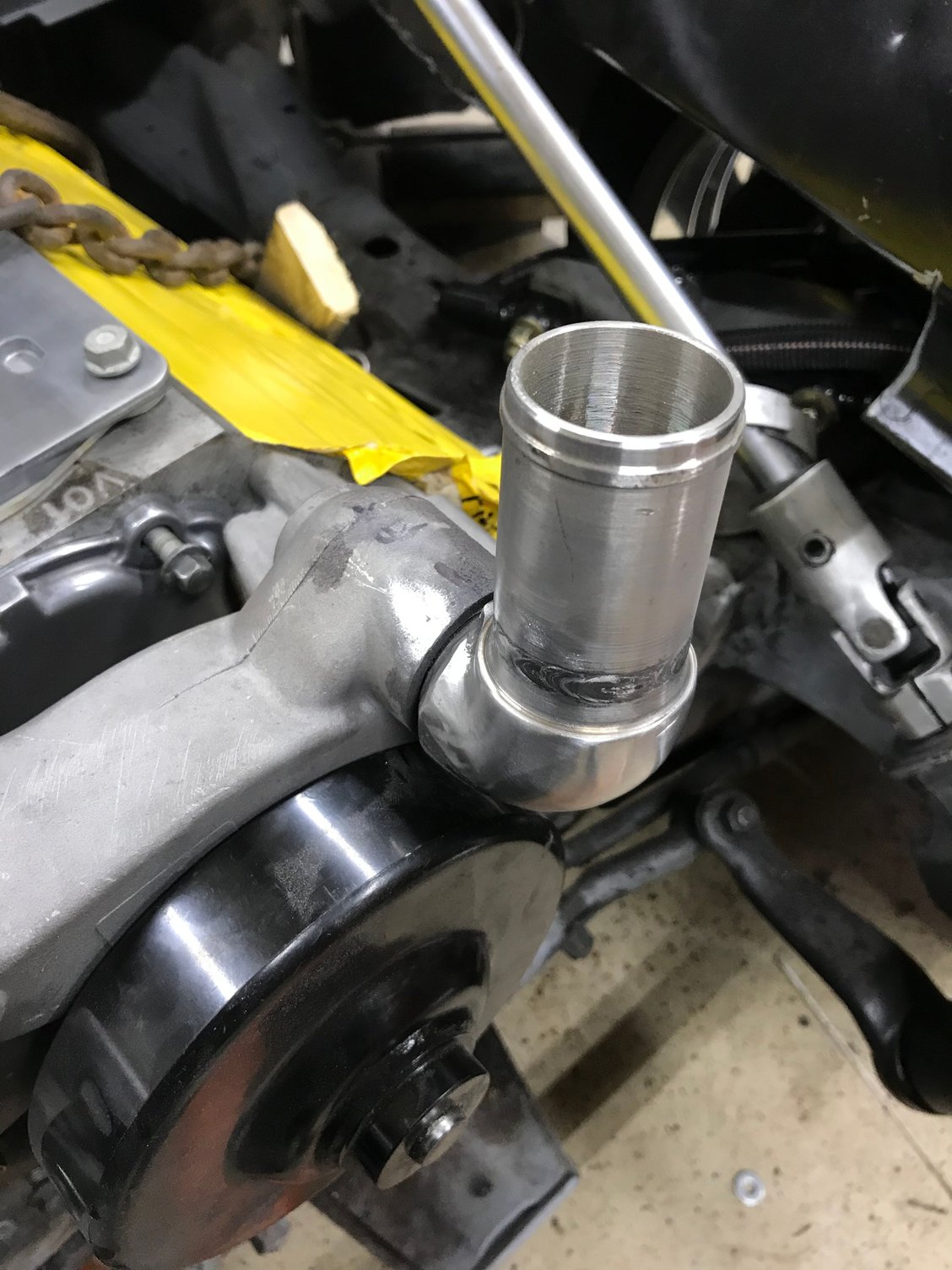

done. A lot of work but it’ll be good.
