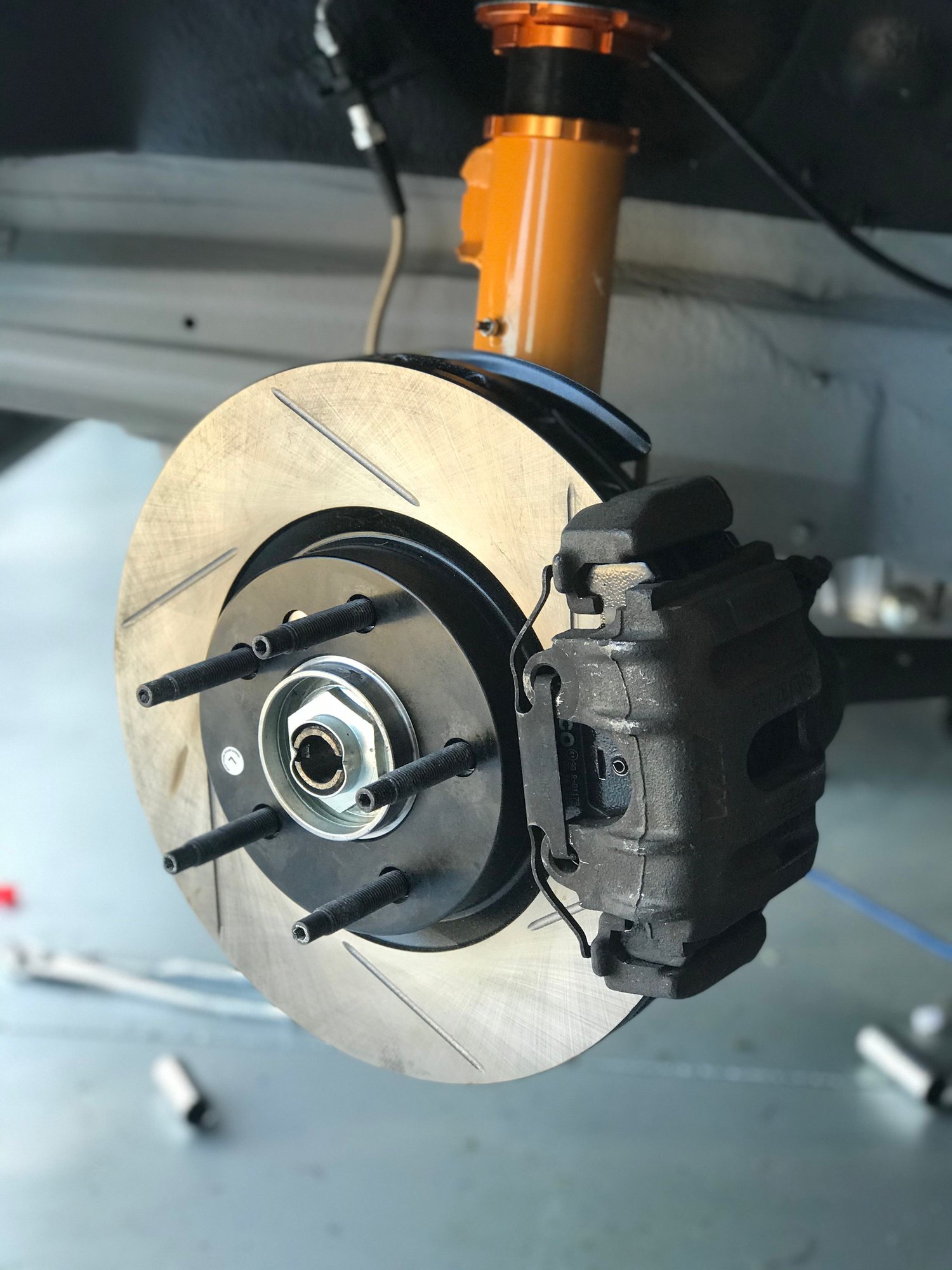

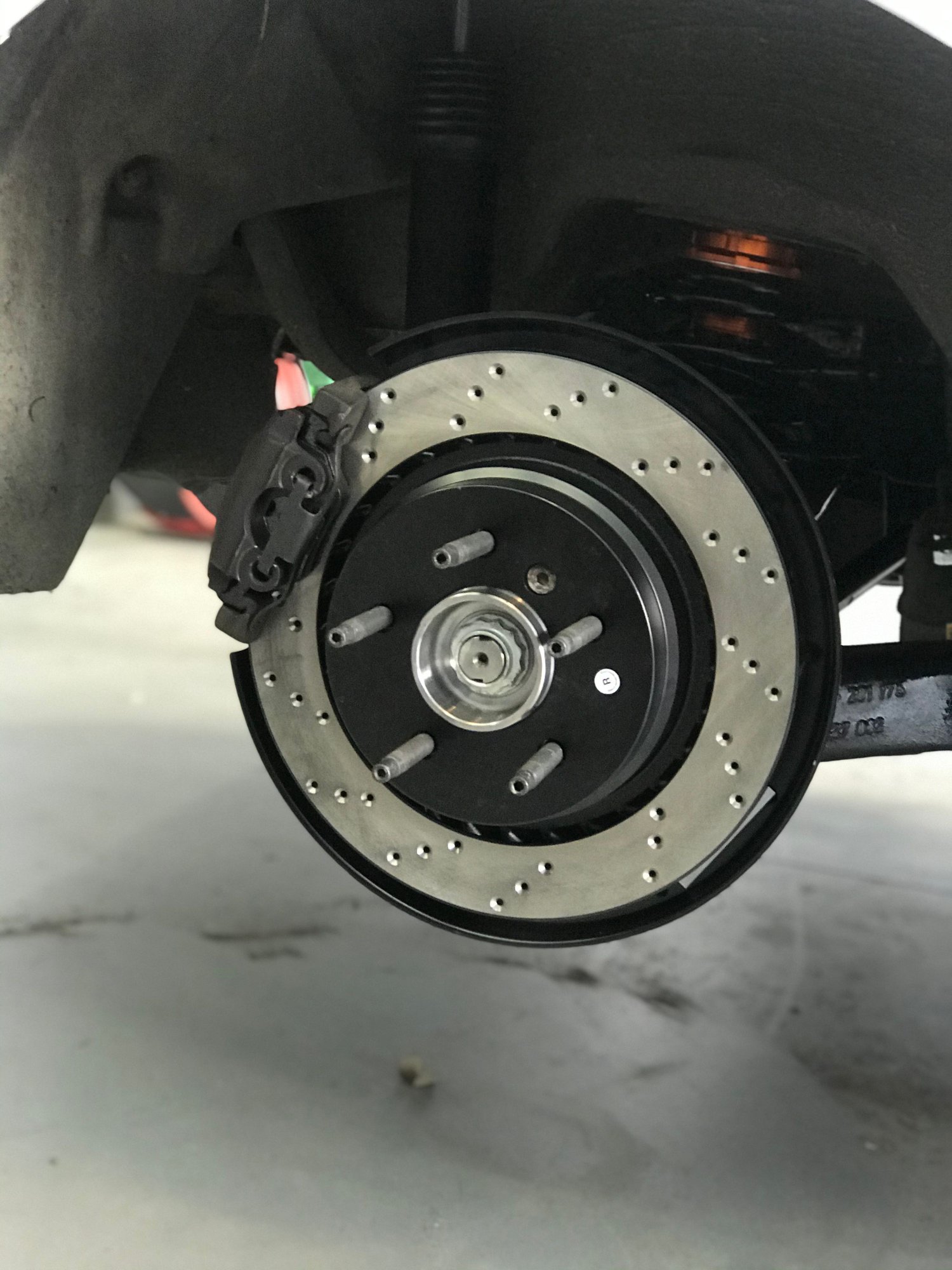

Quick update. I got all of the brakes on the car, but I am waiting for my Willwood brake bleeder cap to come in. Hope to have it today.

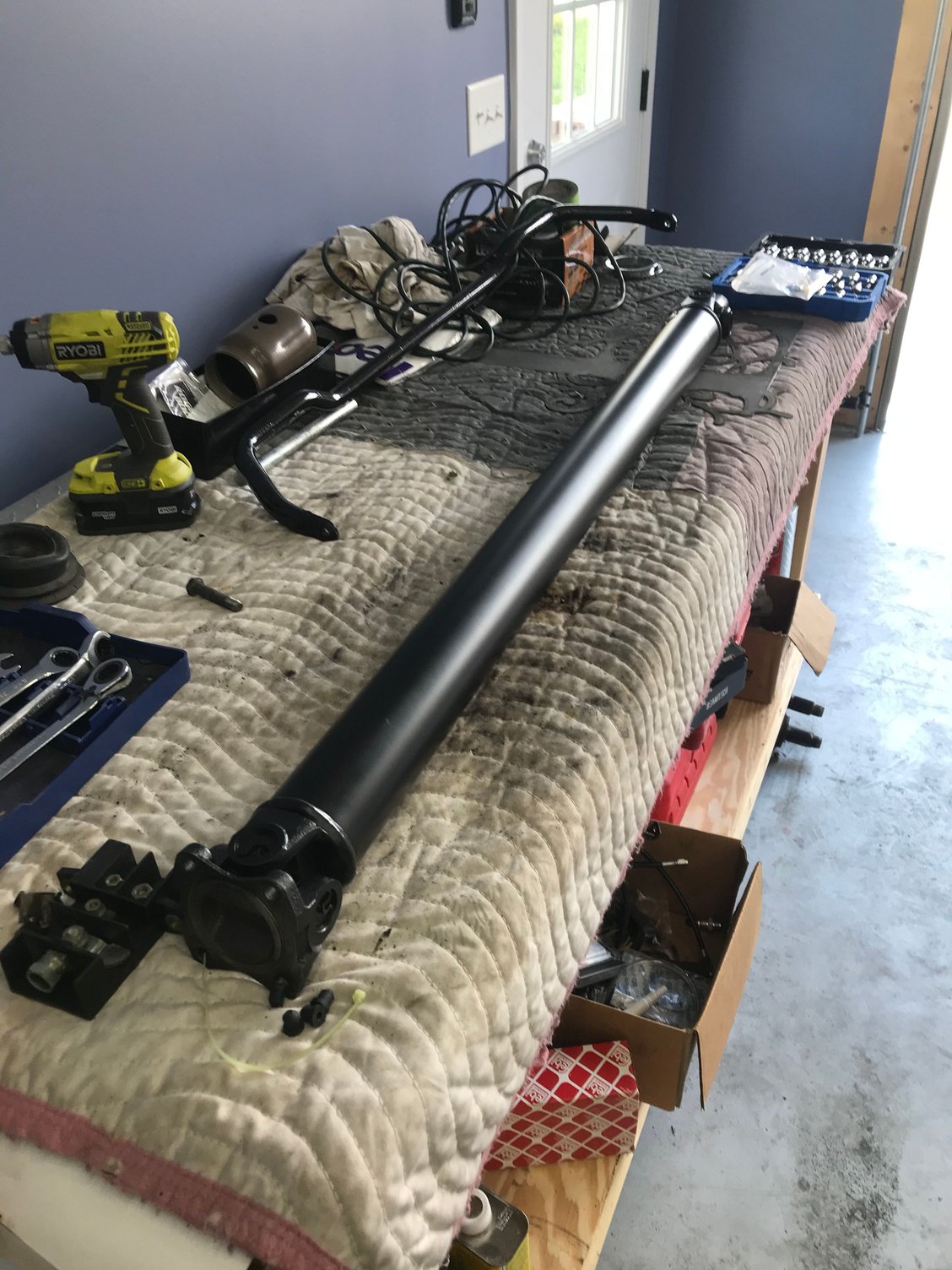

I also got my driveshaft in, and installed.

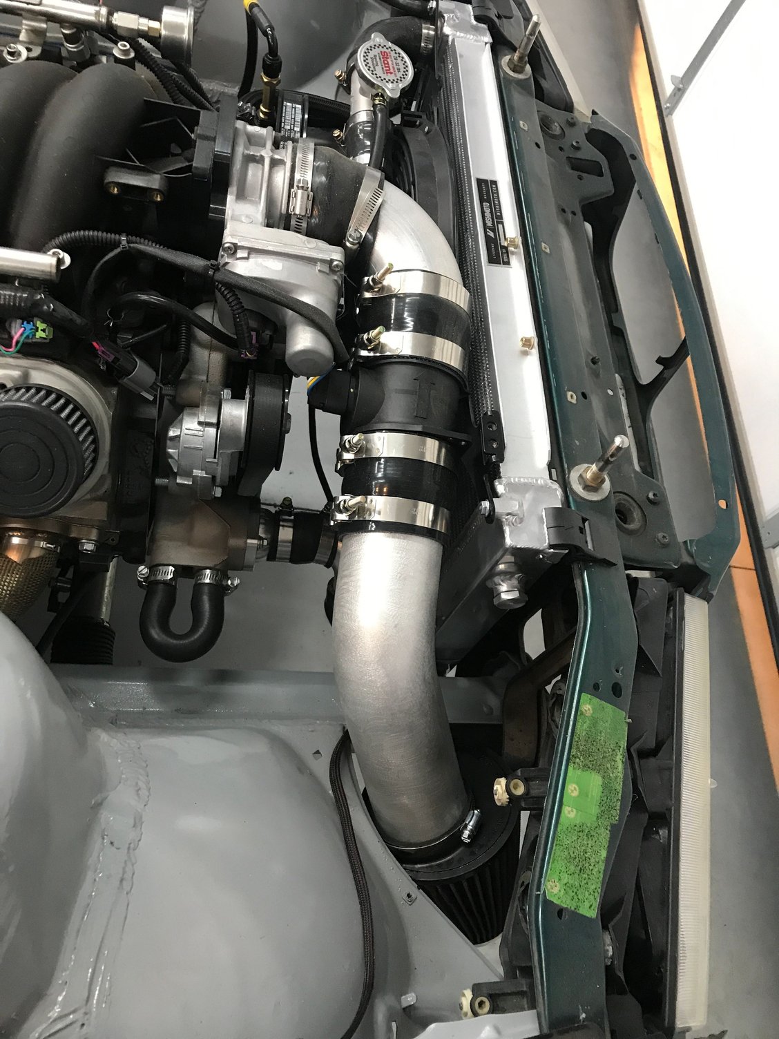

Lastly I got the last of the intake finished as well.

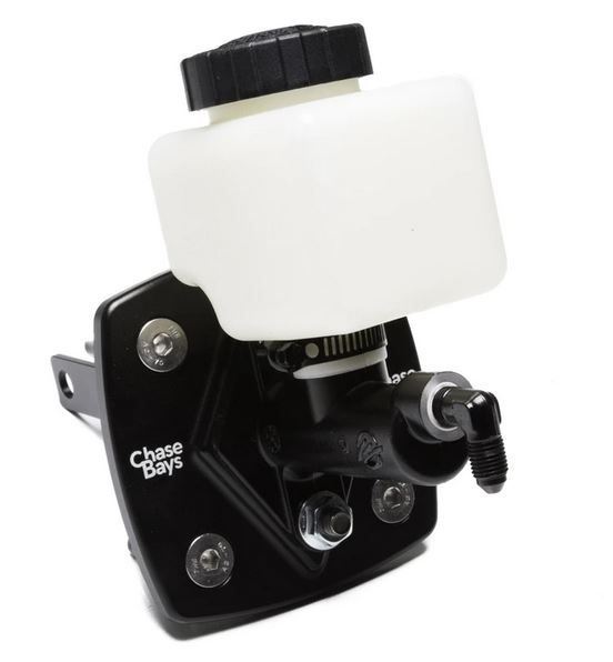

@Michael Yount since the master cylinder is now dry I am going to "bench bleed" it in the car.
This is the master cylinder I have (see below). I am going to take a piece of hose from the fitting on the front of the cylinder and run it back into the reservoir. I plan to then pump the pedal till are no more bubbles in the line then do what you were talking about and cover that little hole on the top while I reconnect the lines to the cylinder. Do you think that will be good enough to bleed the mater cylinder?
