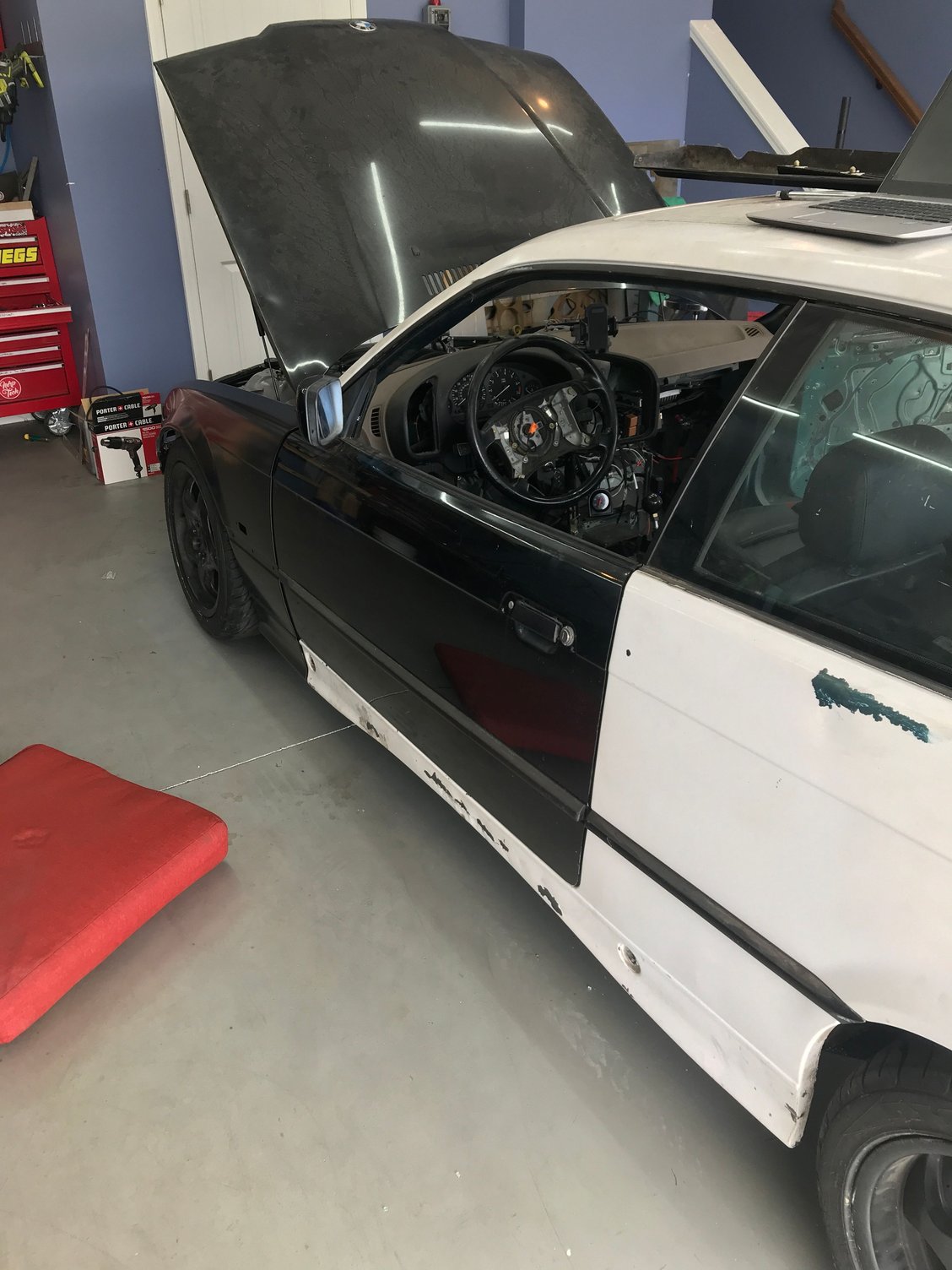

So I am still on the fence. I used to have a M3 that was Imola Red and I loved the color. Because of that I was thinking about going with a like a gloss lipstick red (see below).
However I have always liked the thought of a very deep and dark blue. Something like the Cosmic Blue color below.
Also I was toying with doing a wrap, but the current paint that is on the car is in really bad shape. When I say really bad it looks like the previous owner painted it with a brush, and you can chip the paint off with your finger nail. Because of that I would have to remove all the loose paint and fix the dents before applying a wrap, and at that point I might as well paint the entire thing.

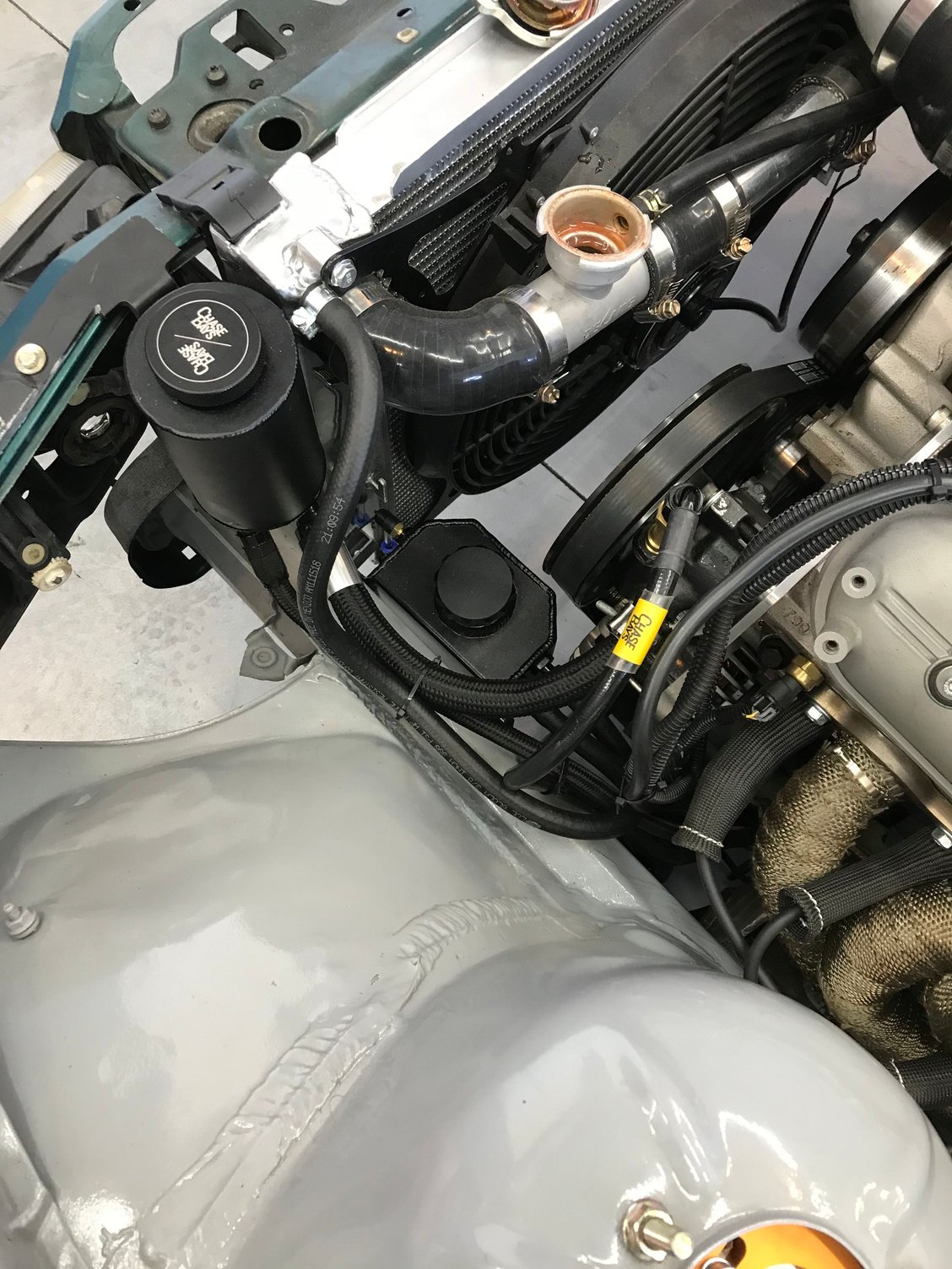

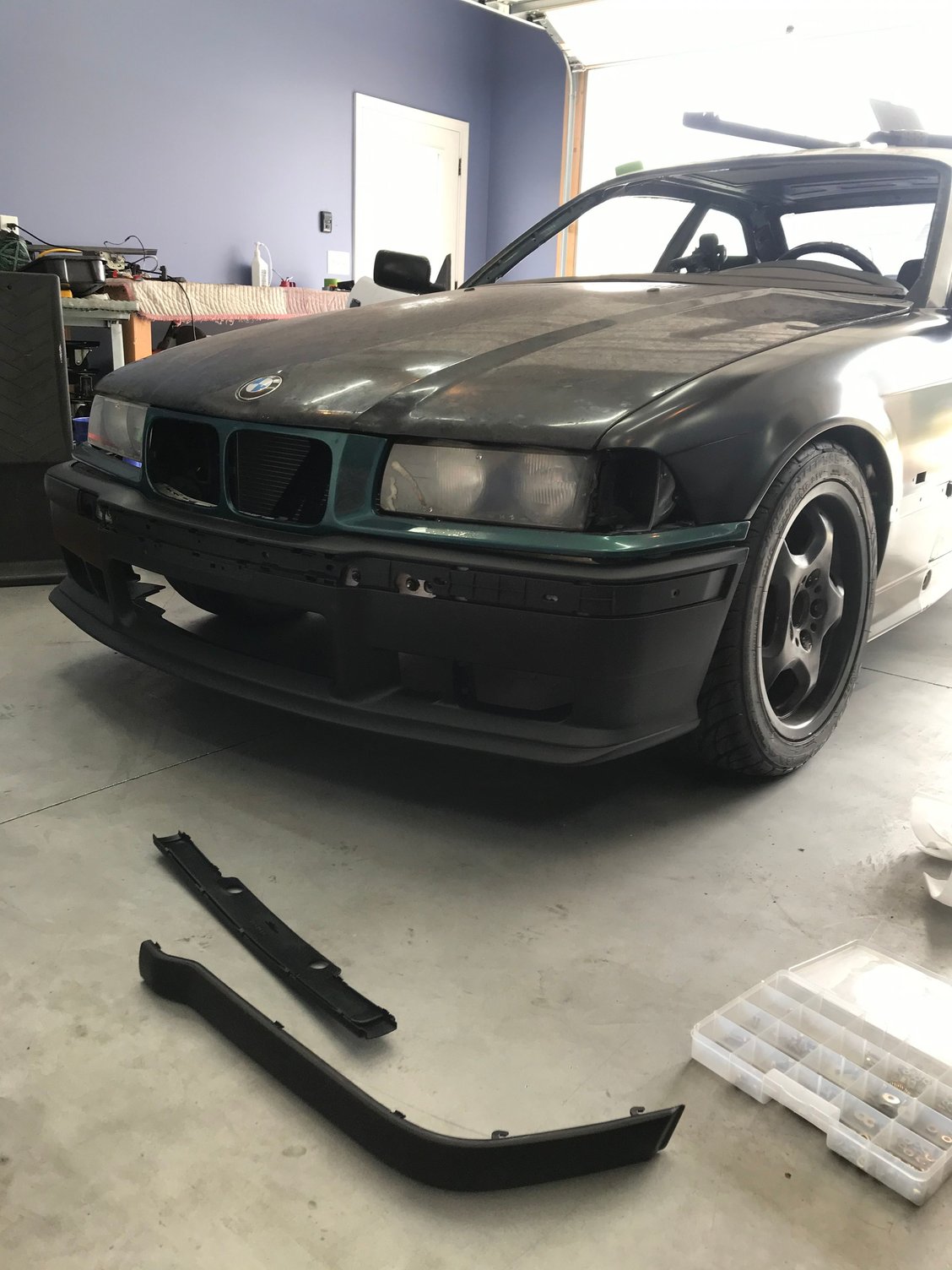

So a quick update. I have driven the car out of the neighborhood, and down some country roads. I don't want to go to far since it doesn't have a windshield, seat belts, any working lights, and up until a few days ago no hood haha.
Here is a quick video from the last test drive. The car feels strong, but I have yet to really lay into the pedal.
Right now I am wrapping up a few little odds and ends, and getting the body to a point where I can start getting it ready for paint.
I installed a new coolant overflow tank since the last one I made was wayyyy to small. This one has been working great so far.
I also picked up a new hood, a pair of clean doors, and a M3 bumper. The hood was a PITA to get mounted and aligned by myself, but it is on there, and in good working condition. The bumper is just loosely laid on the car while I am waiting on the hardware to come in. I also have a set of amber turn signals, and pair of seat belts on the way as well.
Next items are side skirts, and then stripping the old paint, and getting the car ready for body work. That will be a good winter project.

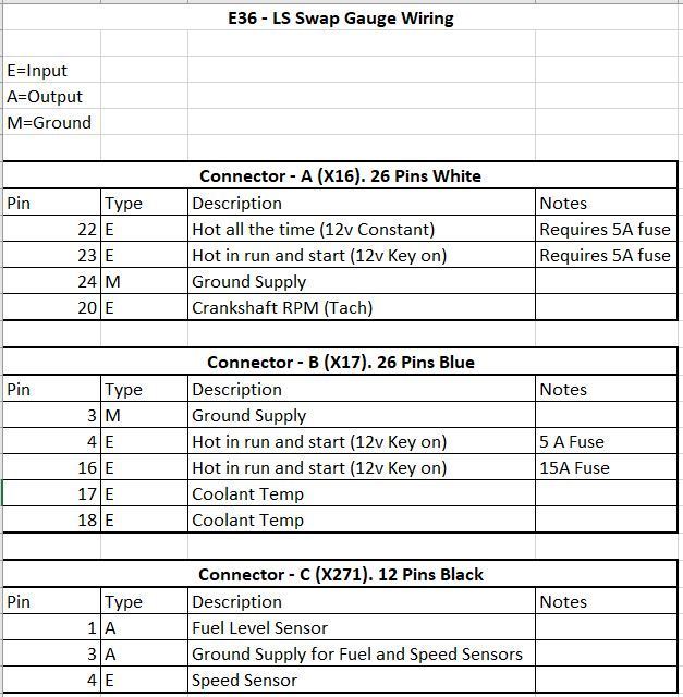

Not a ton of progress lately, but I have been working on the wiring and some other odds and ends. I was able to get all of the BMW Gauges to work (Fuel, Speed, Tach, and Temp). Below are the pin outs if anyone else is doing this kind of swap.
I have been driving the car more, and it is feeling good. Next I plan to wire up all the lights on the car, and get a proper tune done. That will basically leave paint and body for the winter time.

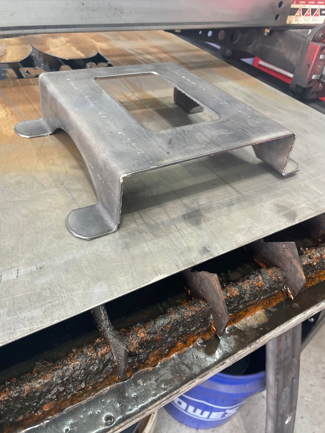

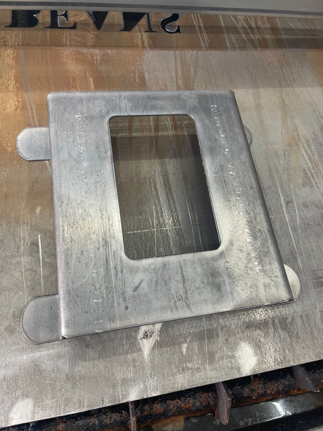

Hey This is Marquel i was wondering do you have any of the measurements for the transmission mount that u made or can you make another for me ? im trying to figure out a way to fab up some mounts for my engine and trans but im using the cd009 with a vq35de in an e36

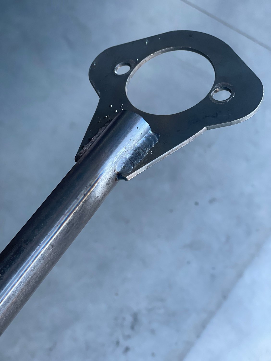

Quick update since it has been some time. I just got the car dyno tuned last week, and make 304hp to the wheels. Everything held together, and the tuner said it all looked good so I can't complain about that. I haven't been able to see how the car drives after the tune due to the weather, and throwing my back out.

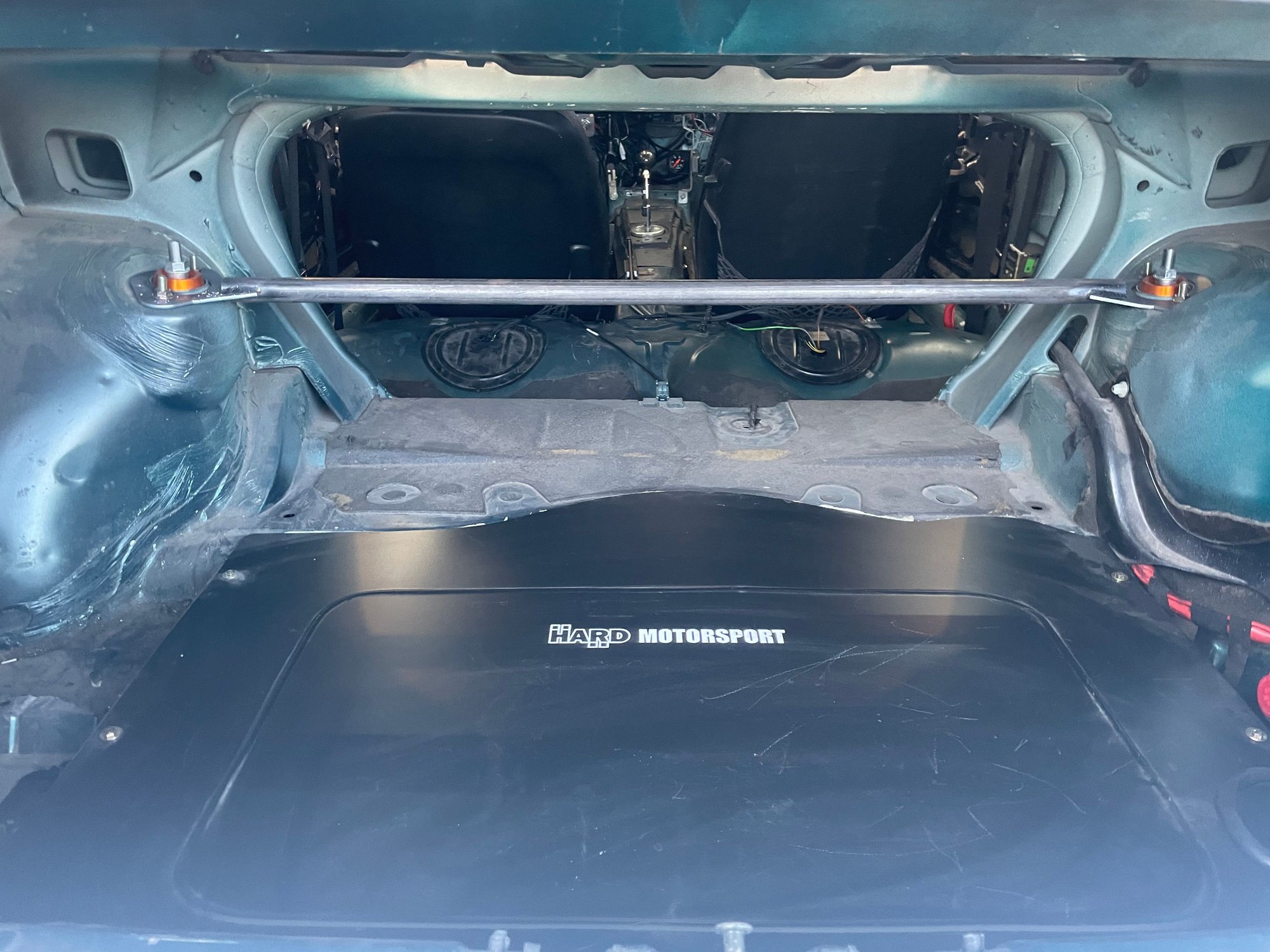

I have been doing a few small odds and ends putting off the wiring the body. I made a rear strut tower bar for the car, and plan to start on one for the front shortly.

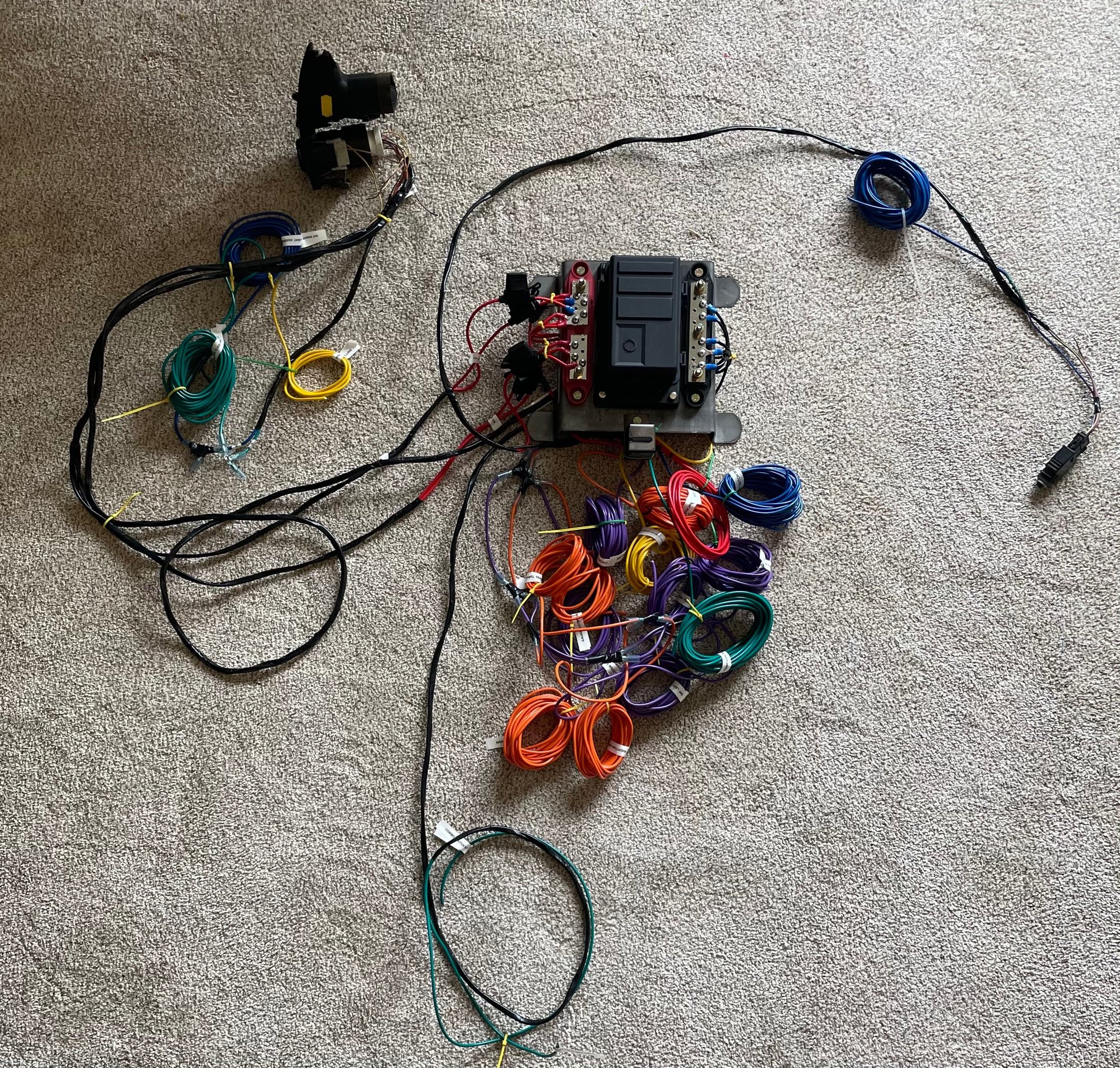

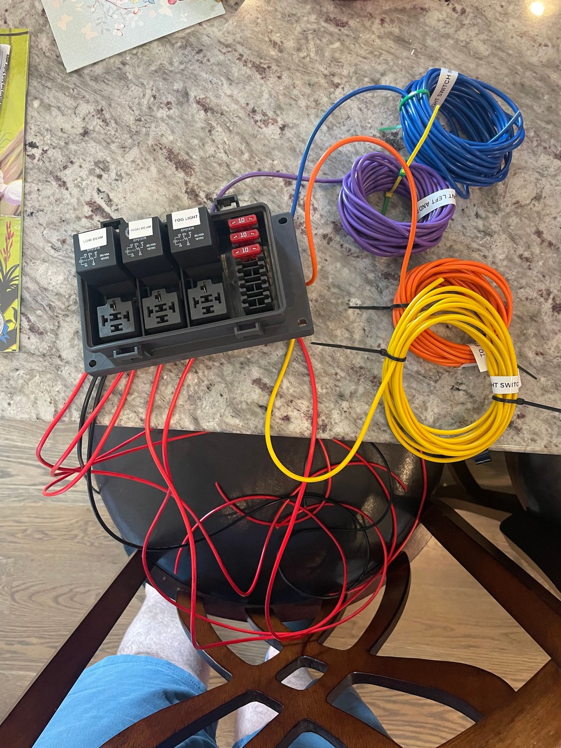

I am also finally getting around wiring the body. Started to pre-wire the the relay/fuse box, and made a small stand to mount everything up.
Next steps are to get a windshield put in the car, finish up the body wiring, and then get the car registered and ready for the road by mid April. Unfortunately over the last four years of owning this car I have moved three times and somehow I have misplaced the title for the car and can't find it anywhere. I am now going through the process of wading through the paper work to now title the car in my name......wish me luck haha.

Quick update. I finished the body harness, and got everything mounted. The back of the car is all wired up, and everything works. I started to pull the main loom into the engine bay, and should have the front of the car wired up before the end of the week. After that I will just be waiting on the title, and then the plan is to get on the road!

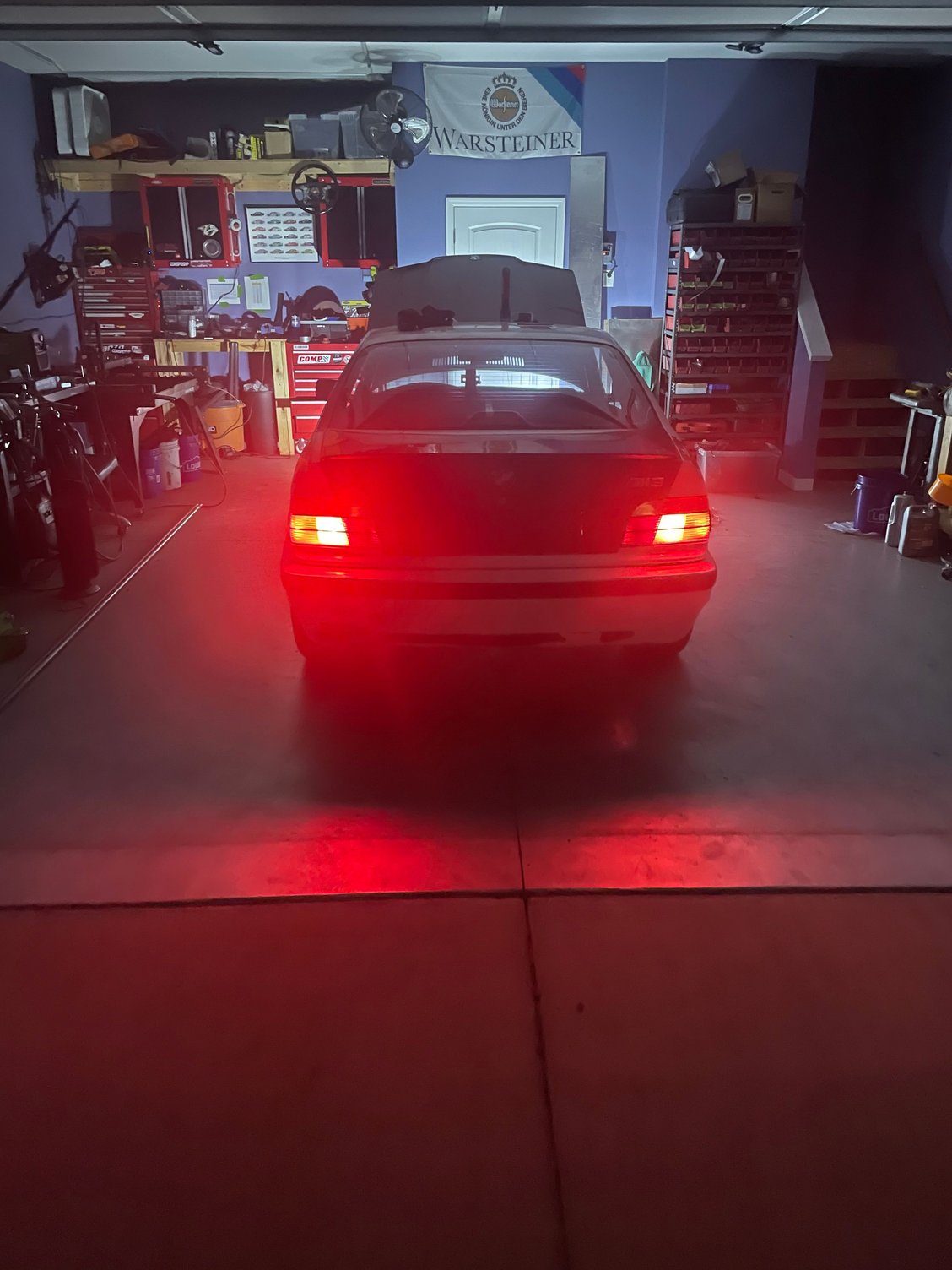

Posts: 253
Likes: 98

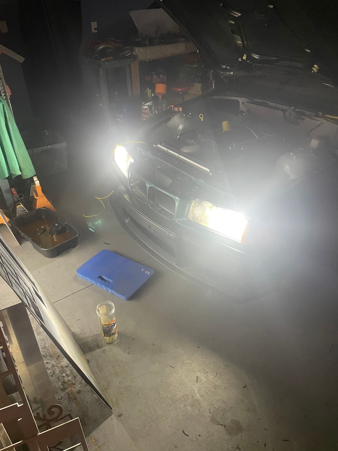

We have lights! I have a few odds and ends to clean up but everything works as it should through the factory BMW switches and *****.
