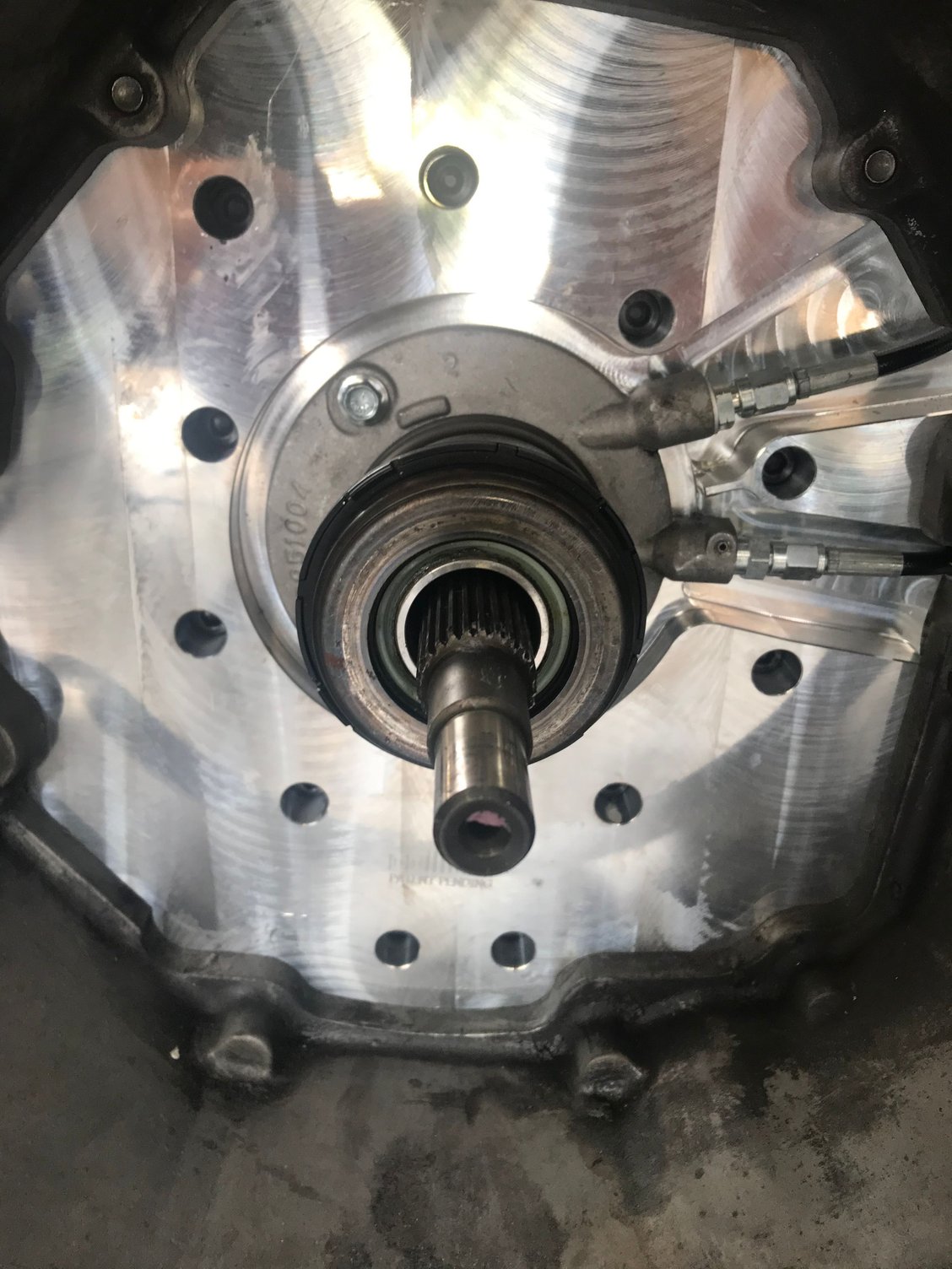

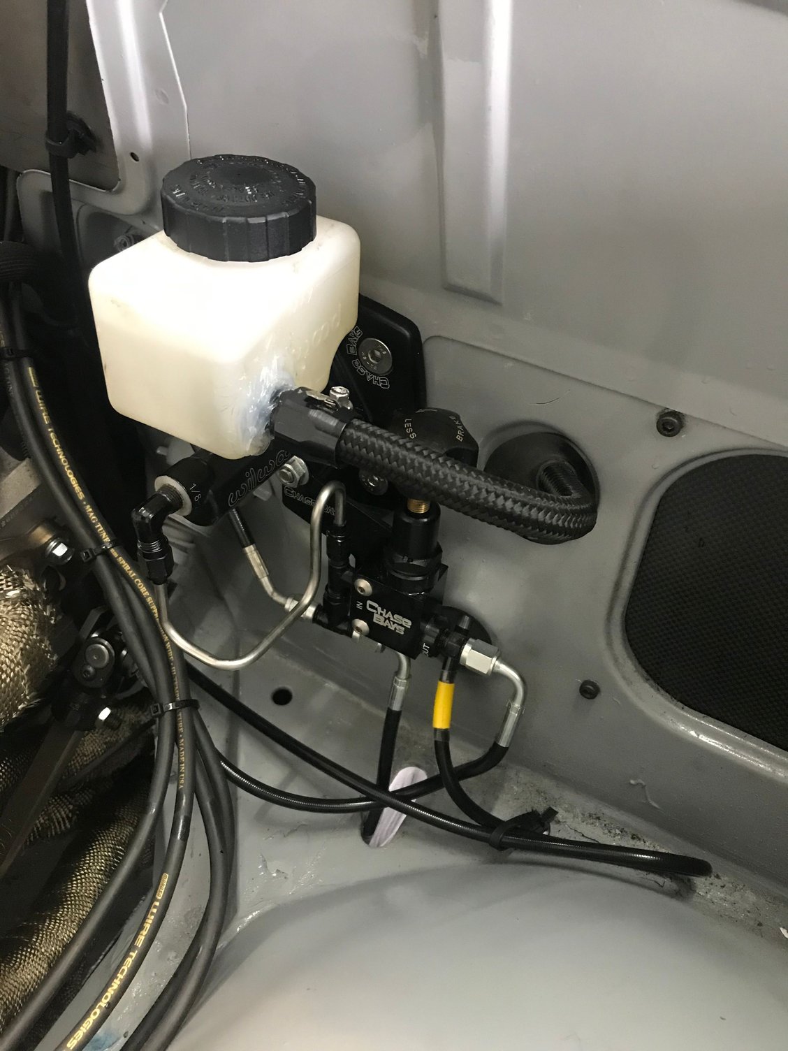

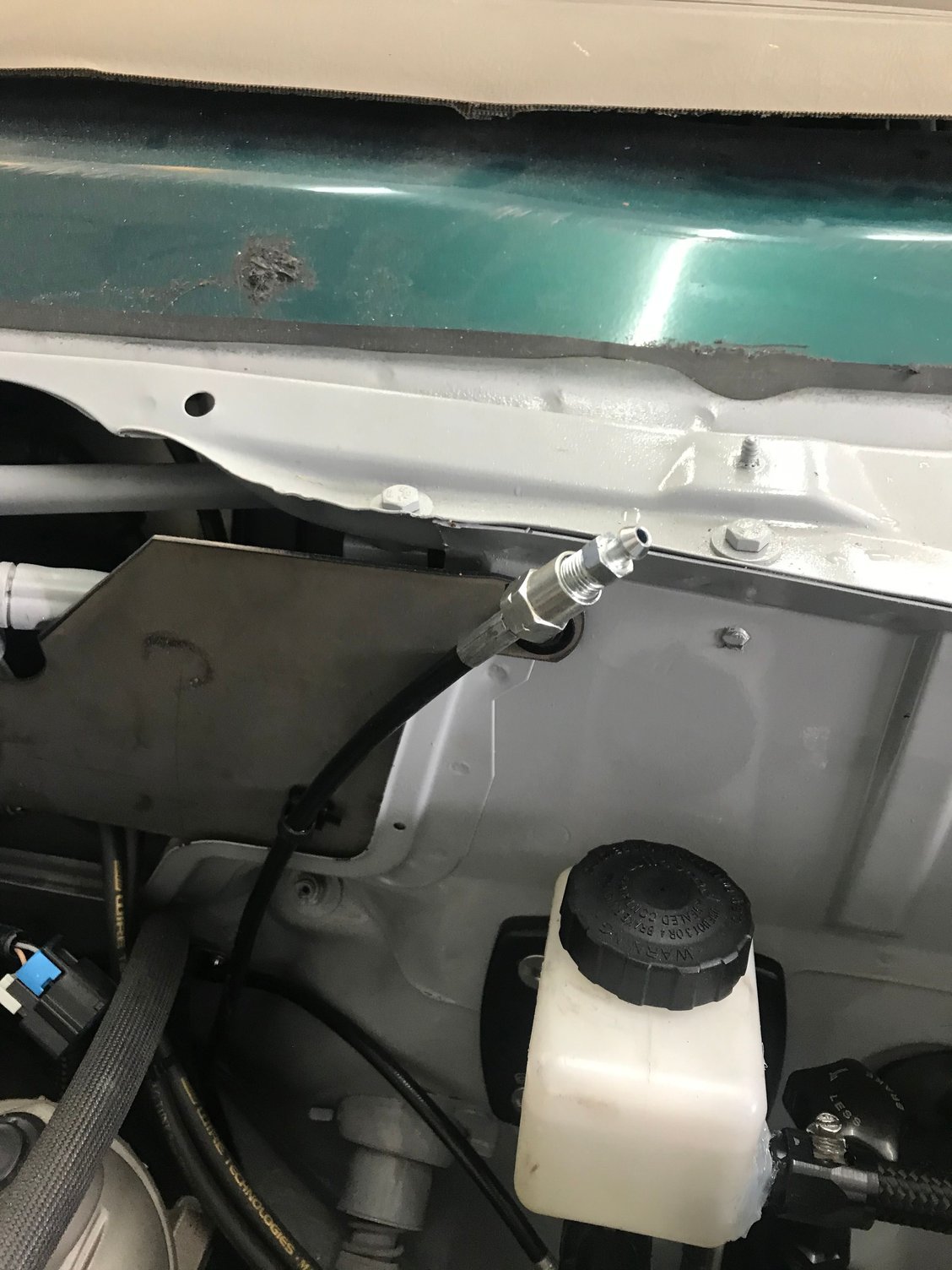

@Michael Yount This is the setup I have. It does have a proportioning valve. As you can see the brake and the clutch system share the same reservoir. The T56 internal throw out bearing.

Should be able to get air out of clutch set up no problem. So if air is out you need to confirm TO bearing is set up/spaced properly. Have I told you how much I hate hydraulic TO bearings? (Chuckle)

Is there an access port of sorts where someone can look at what’s happening to the pressure plate when the clutch pedal is depressed all the way? I’d want that info BEFORE I pulled the tranny. If the TOB is moving, but simply not enough to fully disengage the clutch disc - then the spacing on the bearing is set up incorrectly.

Unfortunately the only access ports are where the clutch and bleeder hose come through between the bell housing and adapter plate. They are located at about 2 o’clock on the transmission (facing the drives side transmission tunnel). Not sure I can even get my phone in there with the camera on to see if the throw out bearing is working. I will

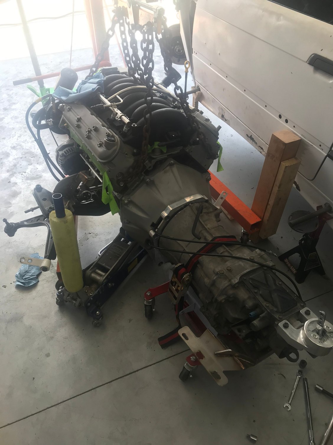

So I got the engine pulled, and it was pretty easy. I had everything out, and the trans off the engine in about an hour and a half. I would like to get your guys input on what could possibly be going wrong.

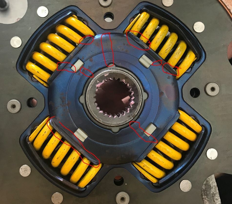

First the tips of the fingers on the pressure plate look to be blued. Take a look at the pictures below. What would cause this?

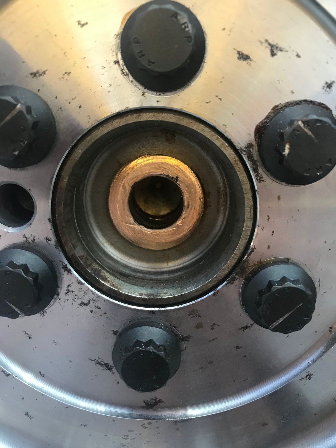

Second when I separated the transmission from the engine there were some very fine brass shavings on the tip of the trans shaft. Here is a pick of the pilot bearing. Also I noticed that some of the flywheel bolt heads have some marks on them.
Third I took a look at the throw out bearing, and nothing was leaking and the bearing moves on the shaft of the transmission.

Is that TOB binding up on that adapter plate causing the bluing?

Well I have determined the issue, and it is a product of my own stupidity and mongoloid strength.
When I was mating the transmission to the block I was in a rush because we had sold our house and I needed to get the car into storage ASAP. That meant I had to get the engine and trans in the car quickly. When I was mating the two together it took a good amount of effort to get the bell housing to mate to the block. I thought it was due to the pilot bearing being tight, but it was really because I didn't have the teeth full aligned from the shaft of the tranny to the clutch. Because of this I had smashed the clutch up against the flywheel, damaging the clutch and essentially rendering the pressure plate useless. You can see from the pictures below how bad I cracked the center of the clutch disc.
