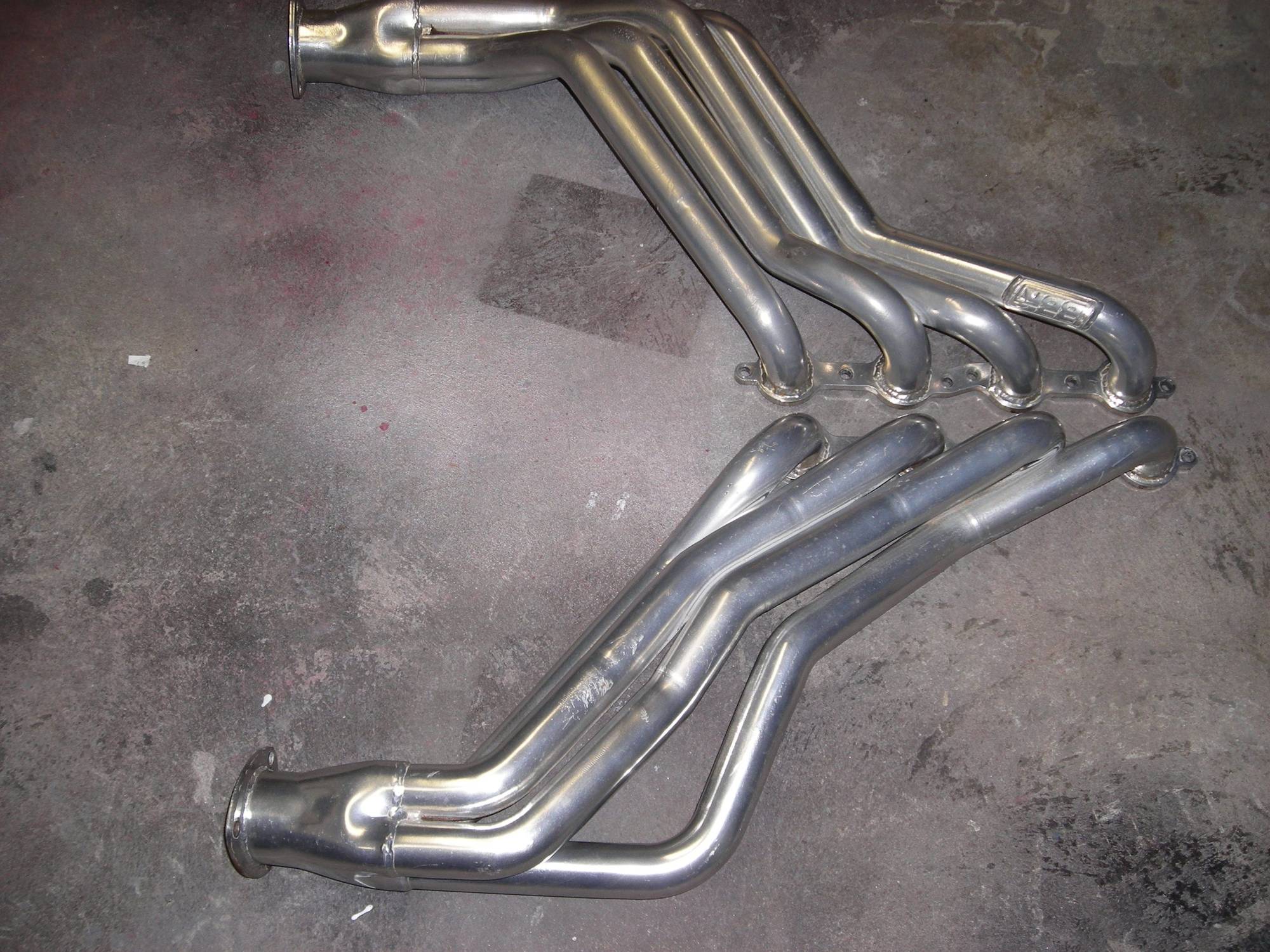

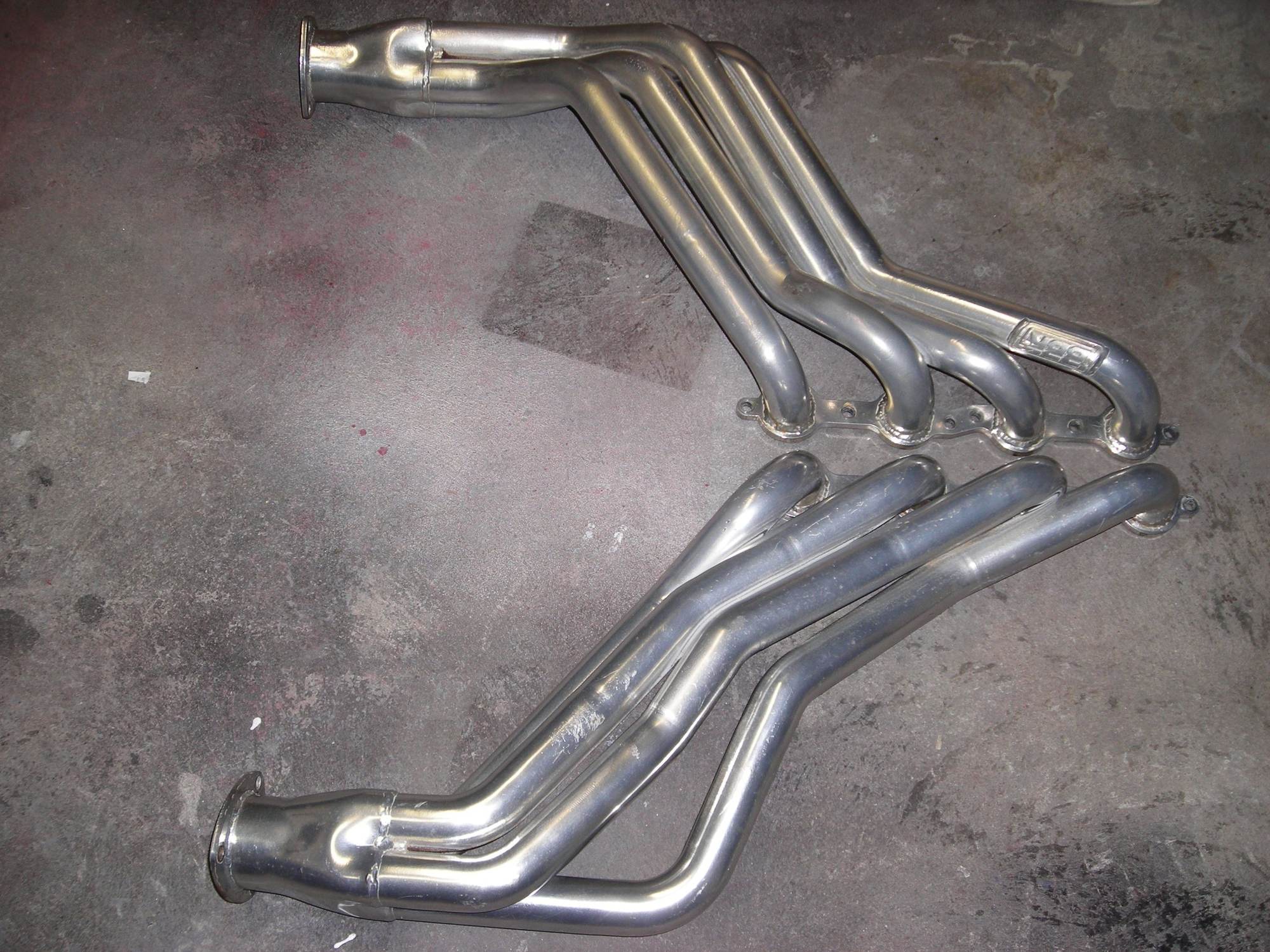

Default 351 swap headers
Heres a couple pics for ya....

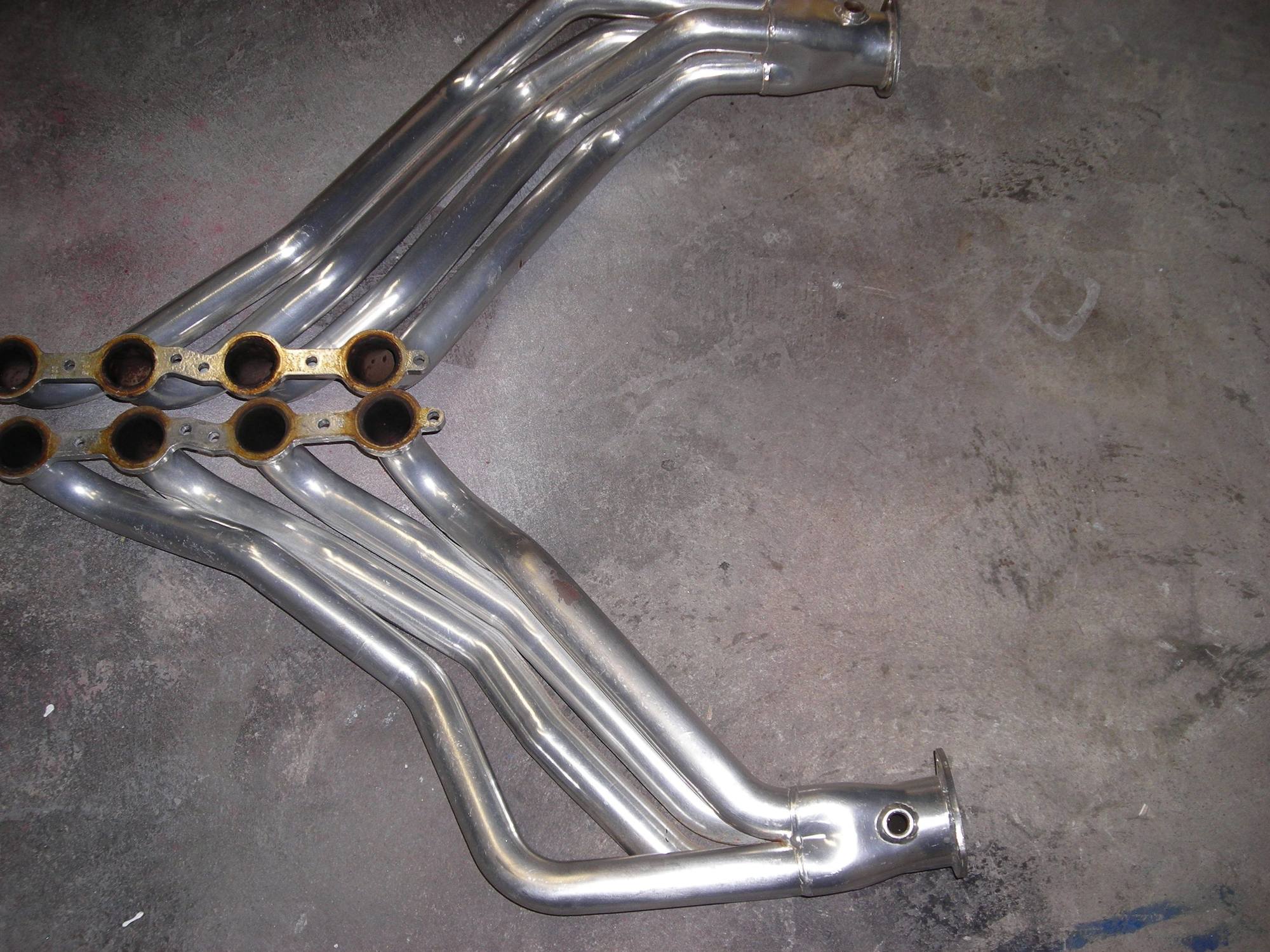

Could you click a quick one of the flange side?

Default new pic
Sure here you go....

Wow nice job. From how ford ports look compared to LS, that is alot of work! What do you need to ship to 58265? I am in Canada, but I ship stuff just across the border to a little border town in North Dakota
