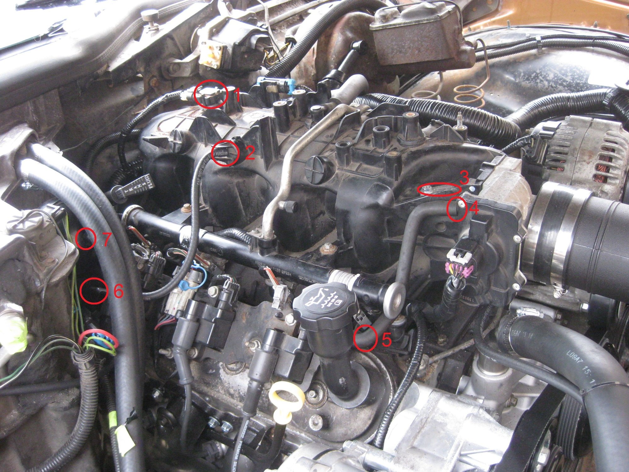

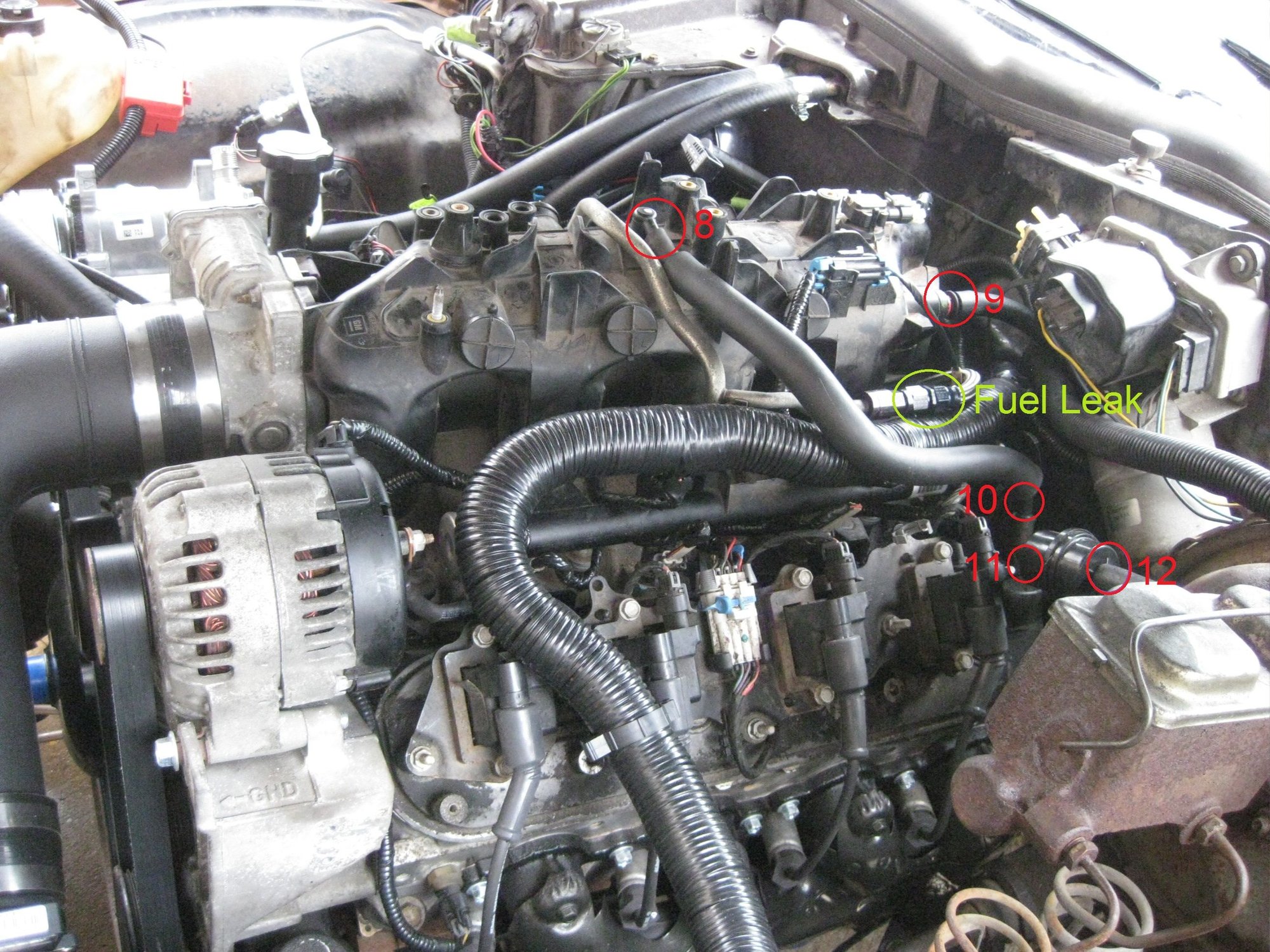

That was my first thought so last night I went and checked the power brake hose, but it was installed. I also checked the port I opened up for the HVAC reservoir, but it was good. I checked all the fittings that I'm aware of and they all seem to be good. The MAP sensor feels a bit loose. Is this normal? When I touch the part of the sensor on top of the back of the intake (LM7) I can wiggle the MAP sensor around a bit.
It's interesting that the first few times I started the engine it was holding idle where I could at least let it run but then on the 4th or 5th start it started getting faster and faster.
The pictures below show the places I've checked. #1 is the MAP sensor, which wiggles a little. I also have a small fuel leak that I need to fix as well and I mention in case it could be relevant.

Posts: 22,293
Likes: 3,617
No pics….

I'm not sure what to do, the pics are showing up on my screen?
Old Dec 24, 2018 | 11:18 AM
Posts: 22,293
Likes: 3,617
They show now. Must have been slow to load.
