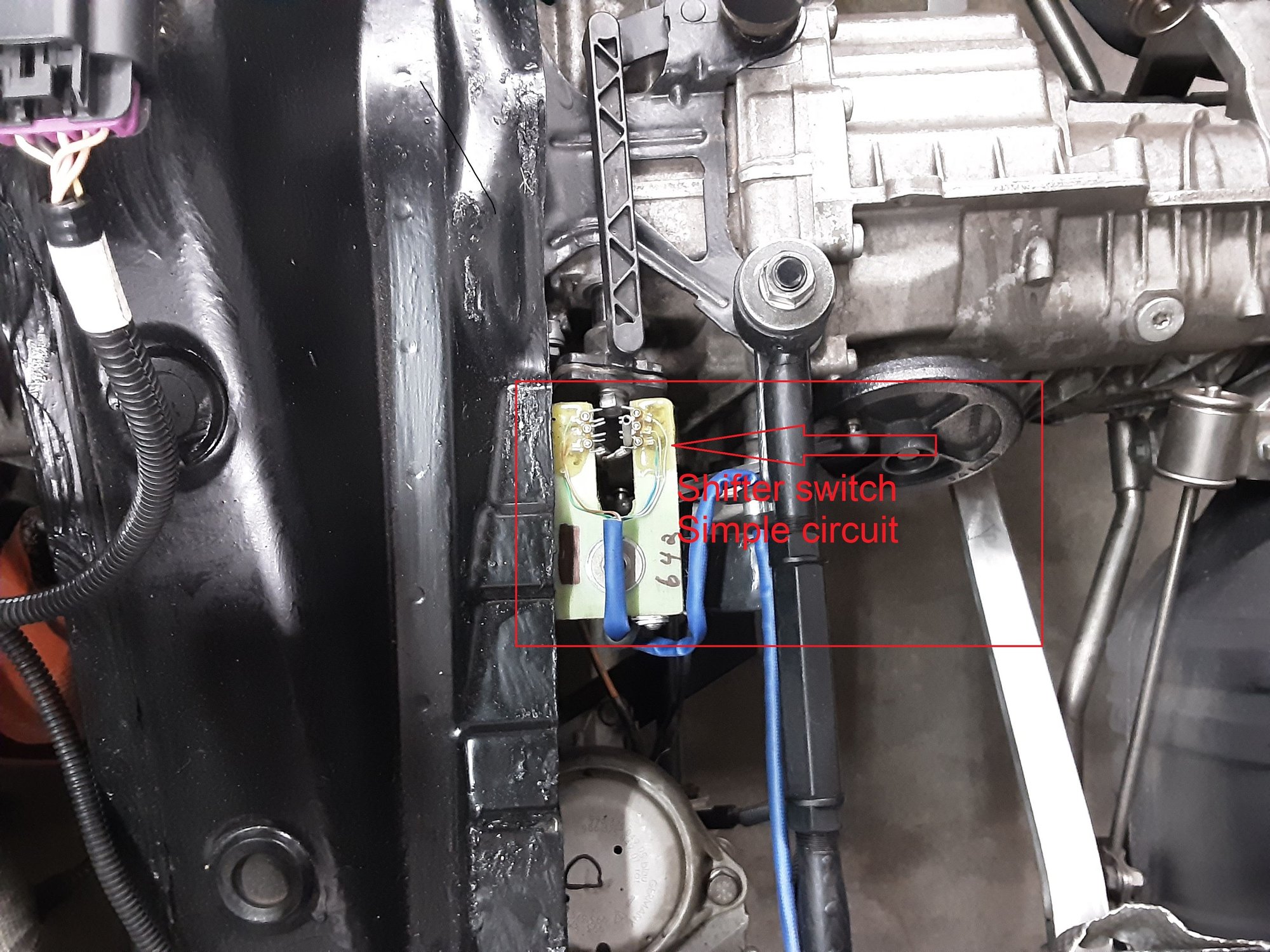

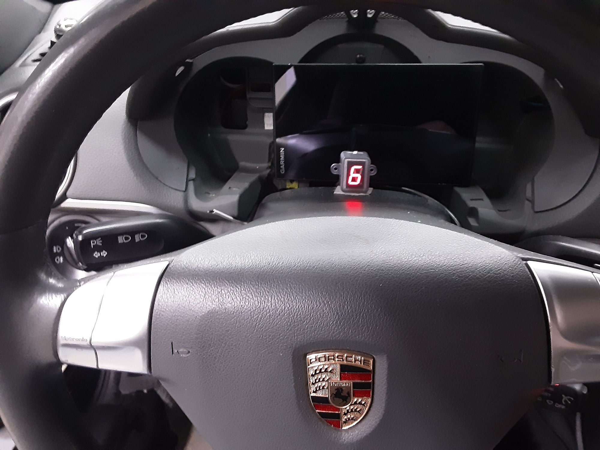

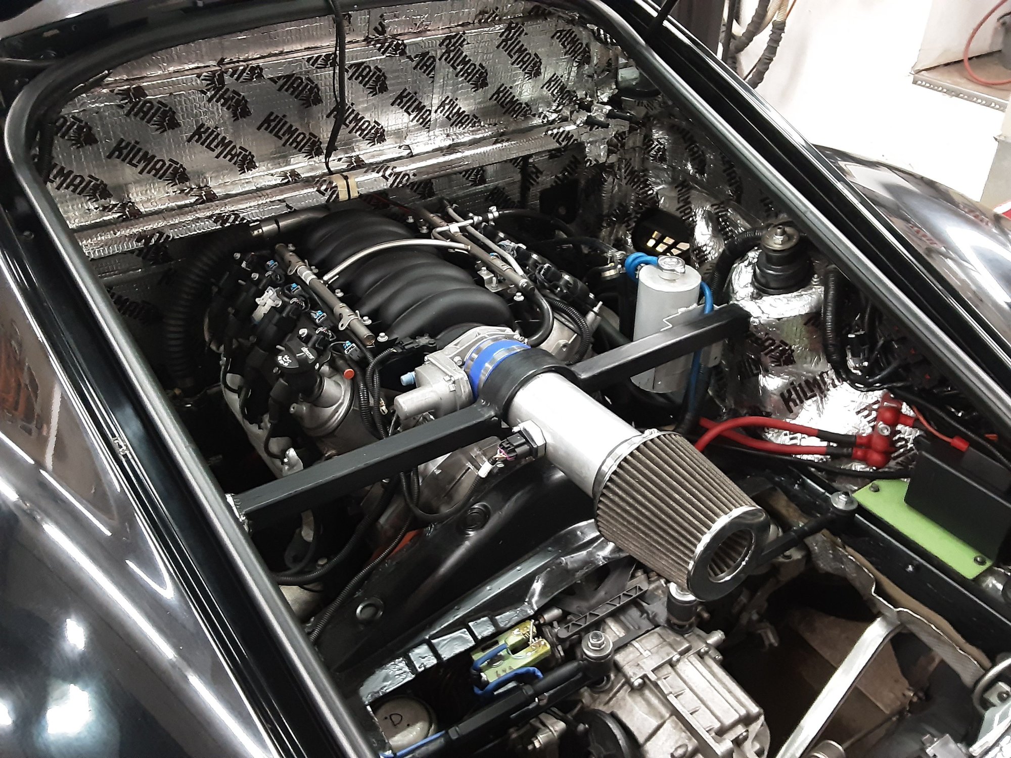

I have been driving the car working on the complete package. Getting a car like this "running" is just
the tip of the proverbial iceberg. I gave the car a big road test of about 3k miles last month. From WA state to So. Cal (1200 miles one way).
The car ran great with no issues. I installed a set of H&R street coilovers, a numeric shifter with the cables. I also wired up a 1-6 digital gear shift indicator. Crafting a 7 way grounding circuit was interesting but it works great and is handy to have with a 6 speed. I relocated the electric P/S pump to the front bumper area next to the driver side radiator.
I'll get some pics and videos up later today !!

Looks great, well done. Can we get some more details on how you wired up the gear indicator on the dash? Something I'd like to tinker with while my car is put up for the winter.

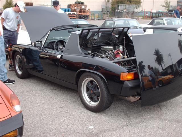

I spent 25 years working in G.M. dealerships doing tune-up and driveability work including having a smog license. I could install a G.M. connect and cruse packagedotthe i's andcross the t's which would be working with the state referee stations bla bla bla. It's a special kind of car, Uneek and provides a true raw high-performance experience not found in many cars. Below is a pic of my 1970 Porsche 914 with a old school 350 and a 930 4 speed built 15 years ago, that was a fun one as well.
This was my second V8 914 the chasse was built by a master called "Jeff" from Fullerton CA. I installed the engine and built it up bla bla bla. should have kept that one. A big car builder in LOS Vagas bought it and poured 60k into it. A crazy build twin turbo bla bla bla .

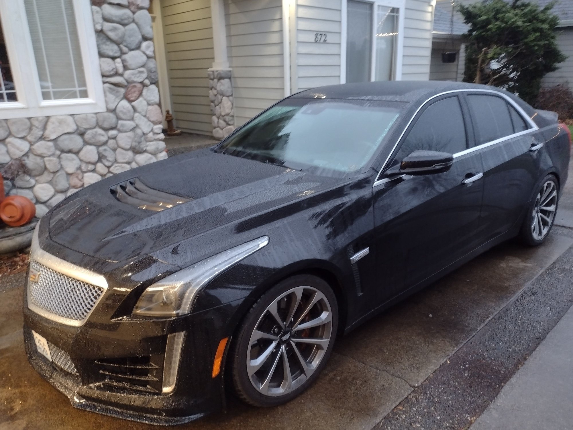

It's hard to beat the CTS V I'm driving now!!!!
