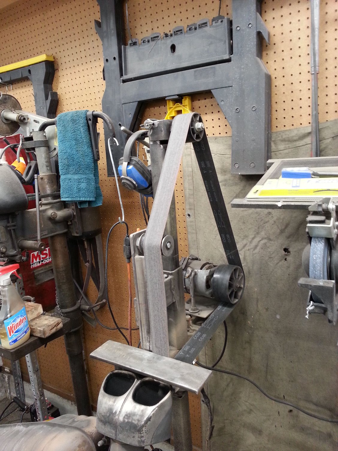

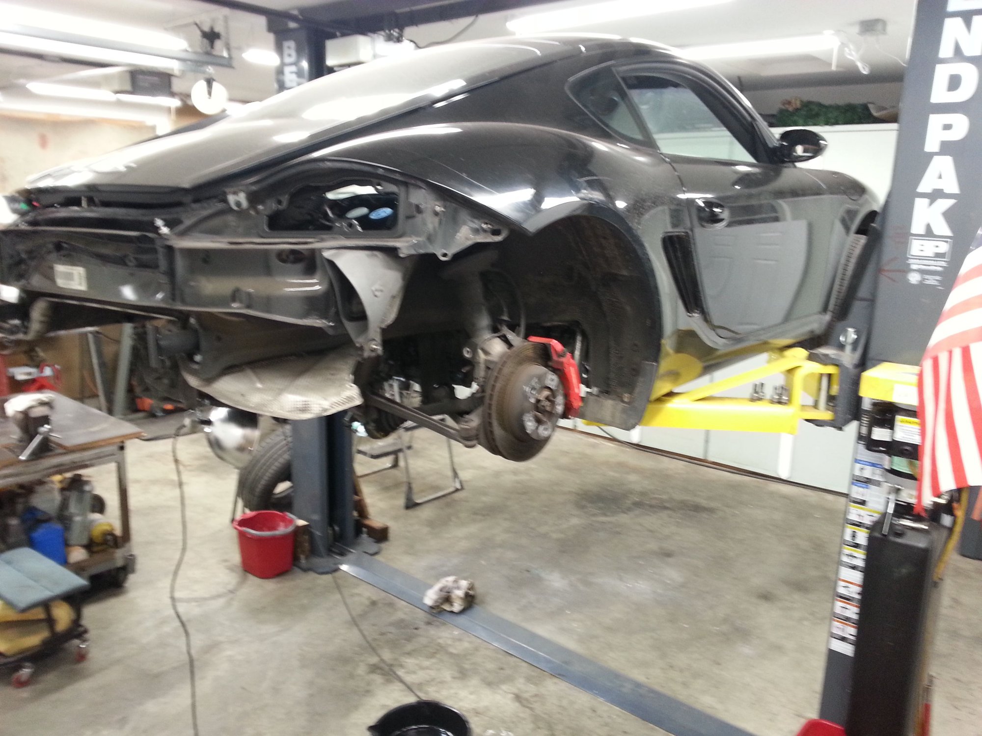

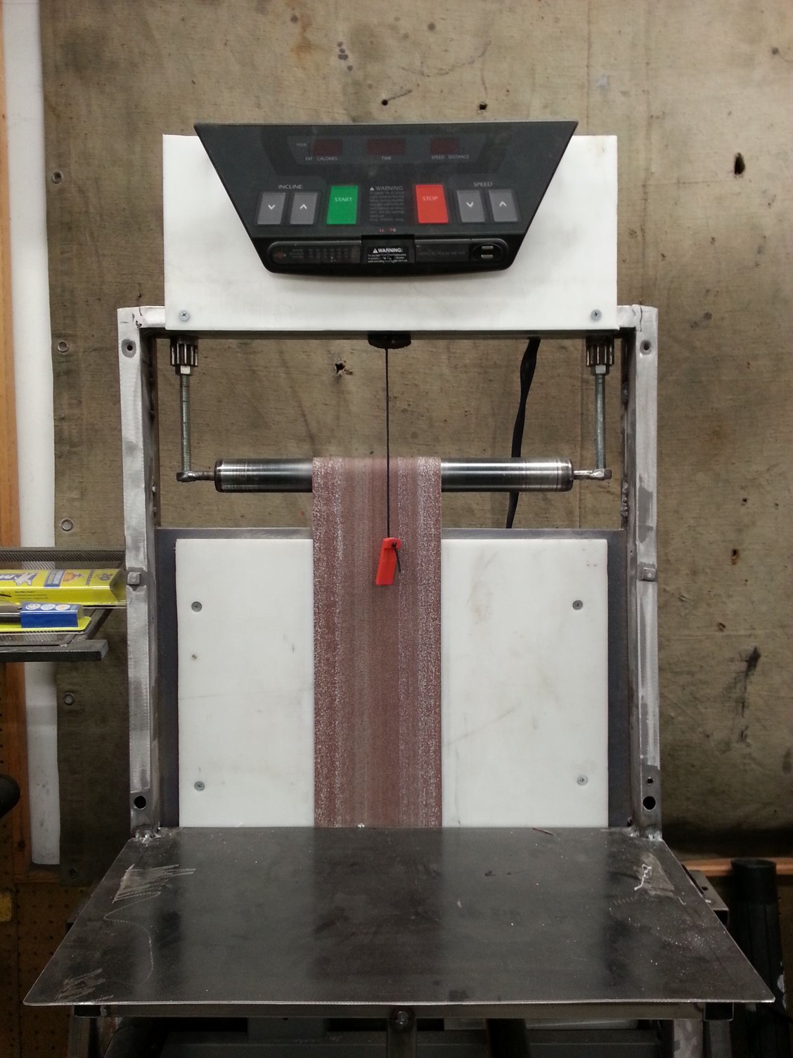

So getting things removed, engine and trans. I'm going to clean the undercarriage, suspension peace by peace. Pressure / steam clean everything and then spray a clear coat to help it stay that way. I'm going with a LS3 and a 6 speed. I'm likely listing the engine / trans (auto) for sale.
I made 2 belt sanders using treadmills, They were easy and work well LOL
I'm getting 12x48 36 grit to replace the junk on it now
2 x 72 and cuts metal great

The repurposed treadmills is genius!

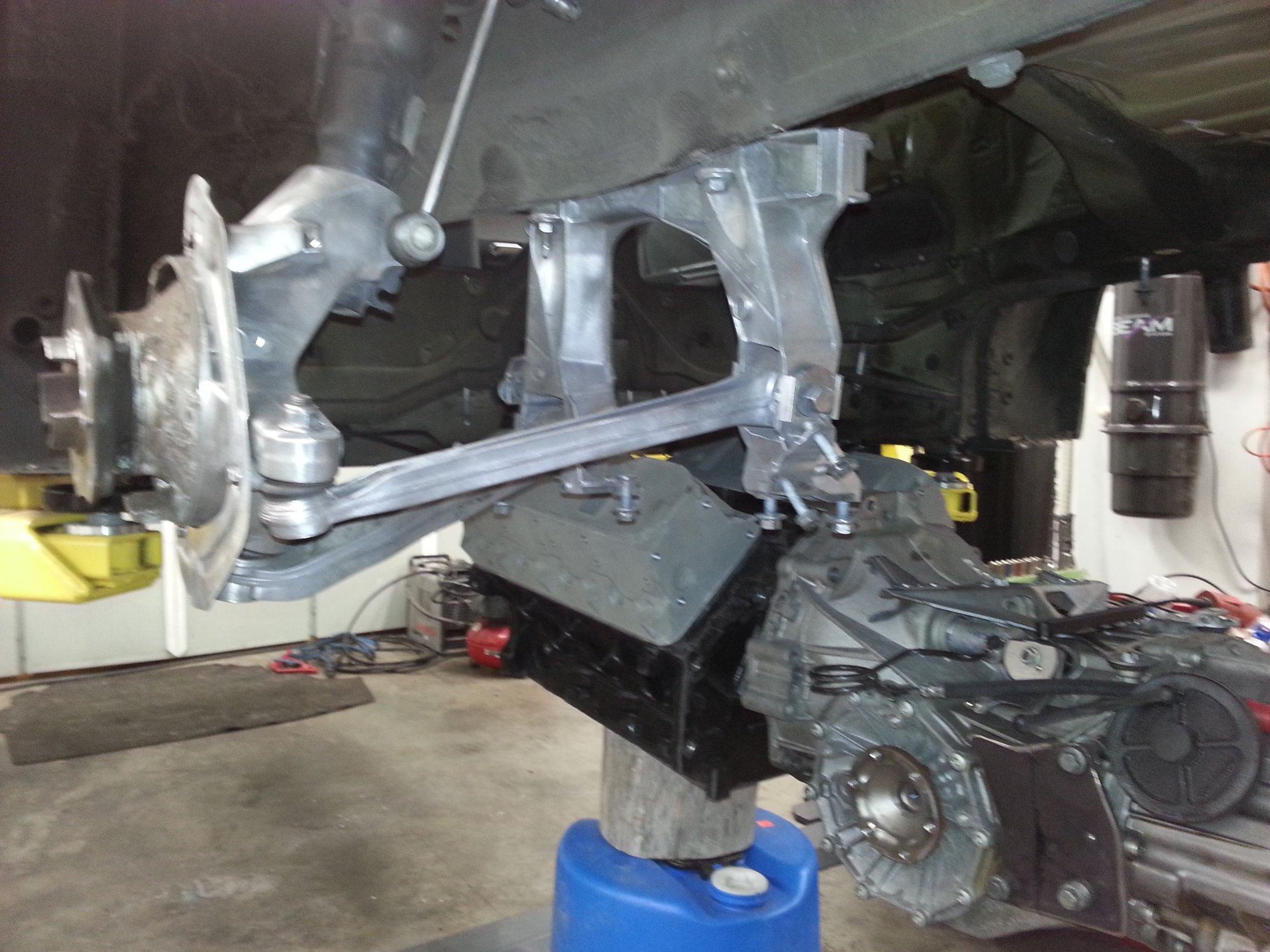

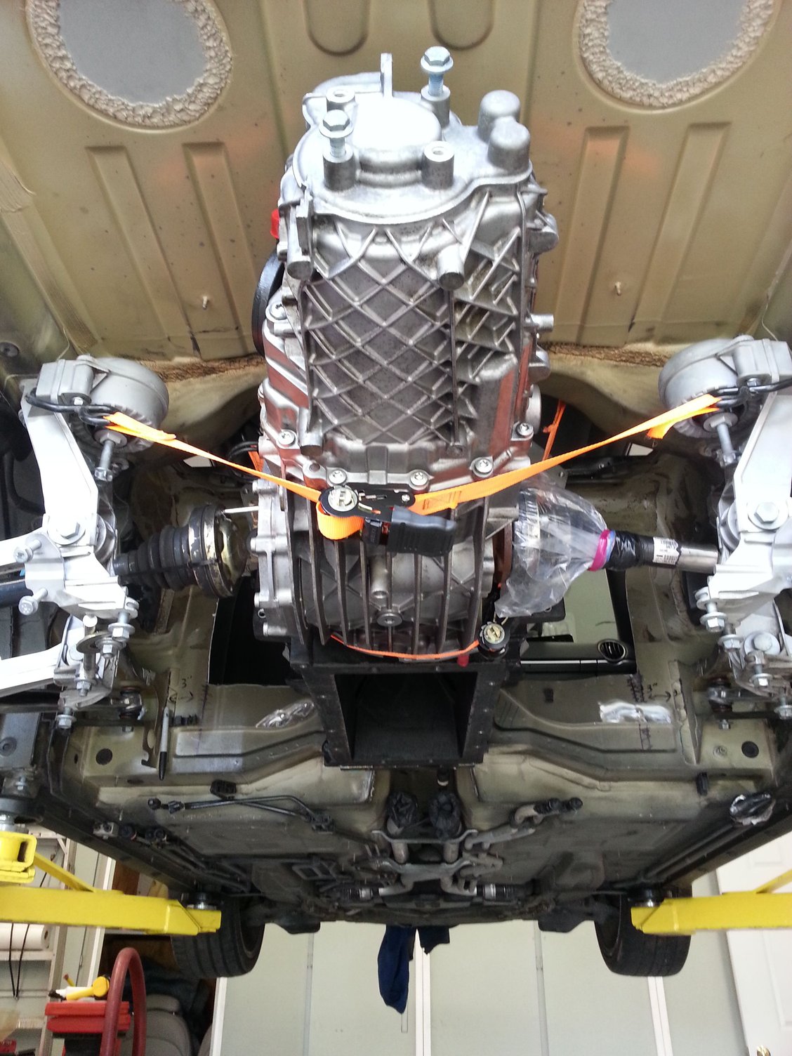

I'm now in the process of "waiting for parts". The suspension hardware on a 12 year old car sure gets dirty so I took the time to clean everything up. Using a mock up LS3 block so its going to be a little lighter and that helps.
Placement of the engine is really critical, starting with how to stack the accessories. I'm running a alternator, A/C compressor, for sure. Thinking to place them on the passenger side and maybe a belt driven water pump as well. Until the parts come in thumb twiddling is getting old!! It comes down to spending money and often I drag my feet looking for a "special deal" LOL . I really want to run a LS7 because 500 hp is where I want to be. There are guys who have de-stroked the LS3 using a crank from a 4.8 and that interests me as well. I do plan to fabricate a lot of the basic hardware. Making up the engine and transmission support structure along with the electric power steering pump I've done twice before in my 2 V8-914's.
