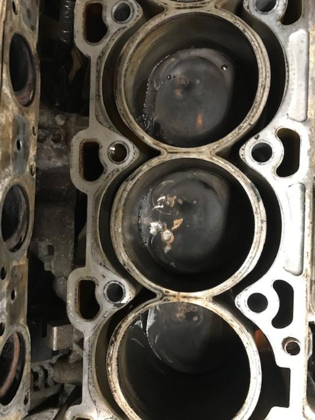

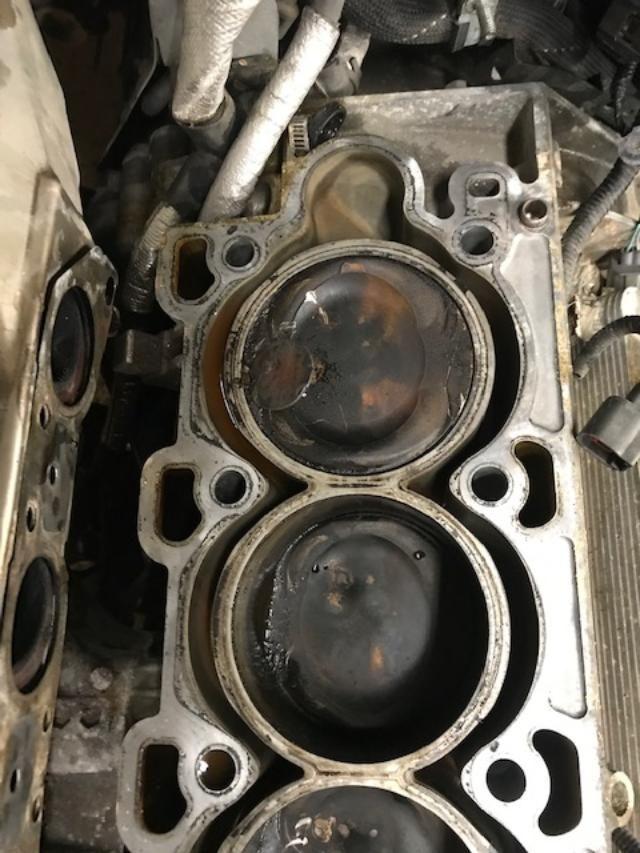

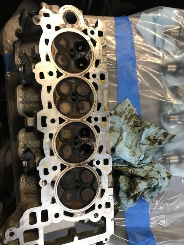

Old May 18, 2019 | 05:29 AM
leftlanetruckin's Avatar
Joined: Feb 2010
Posts: 276
From: Mid Mo via Lancs. England
Sorry for the delay, been a tad busy with a "project"
Grabbed a rig for a buddy, who proceeded to push the start button a little too long and spun over the motor with the front of the motor apart. All timing stuff was still on so not sure why, but everyone loves carnage so.....
4 valve heads less.....
1 missing valve, upside down in a piston
End result is a rebuild where I was just doing timing chains etc. Timing jumped on passenger bank exhaust cam, no idea why. So now taking a motor out that is officially only to be taken out by removing the body first. Not happening
