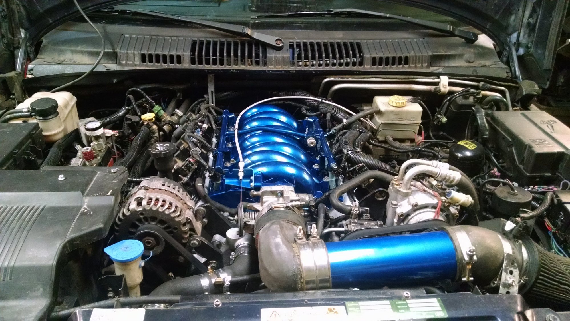

Hey guys
I have the mildly built 5.3 in a '98 Range Rover.
PRW high flow water pump
24" w x 21"h x 3" deep aluminum radiator. Both inlet and outlet are on passenger side, double pass design
Electric Taurus fan and shroud
Stock thermostat
Worse at higher rpm's, heats up more and quicker.
Any warm weather at all she's over 220 and the fan cant keep it cool. Worse with the ac on.
Turn the AC off, it will go back to@220-230 if you let off the throttle some.
AC condenser is 1" in front of radiator
With the temp gauge at 215, fan on, I shot the radiator and got 152 degrees at the top inlet, 141 at the bottom. So the rad is only pulling out 11 degrees of heat.
Steam lines hooked up. Have a header tank in the system, its on the 3/4" hose side of the heater core hoses, T'd into that hose.
I have some theories....
The water pump is pumping the water too much, meaning it isnt hanging out in the rad long enough
A restrictor may be needed on the thermostat side, so the coolant stays in the rad longer. Griffin suggested that after sending them some readings
The radiator isnt enough. If the coolant is just dropping from the top to the bottom. Cross flow better? I'd need to redo the intake, but it's doable.
It's the only thing stopping the rig being enjoyed more
I think that is all the pertinent information covered.
Many thanks in advance
Martin

By looking at your pic it looks as tho the rad my be mounted to low. Thus making the rad full of fluid but the engine not full leaving alot of air in the system.

Ok good....i just thought that was a overflow tank by looking on it from my phone.
