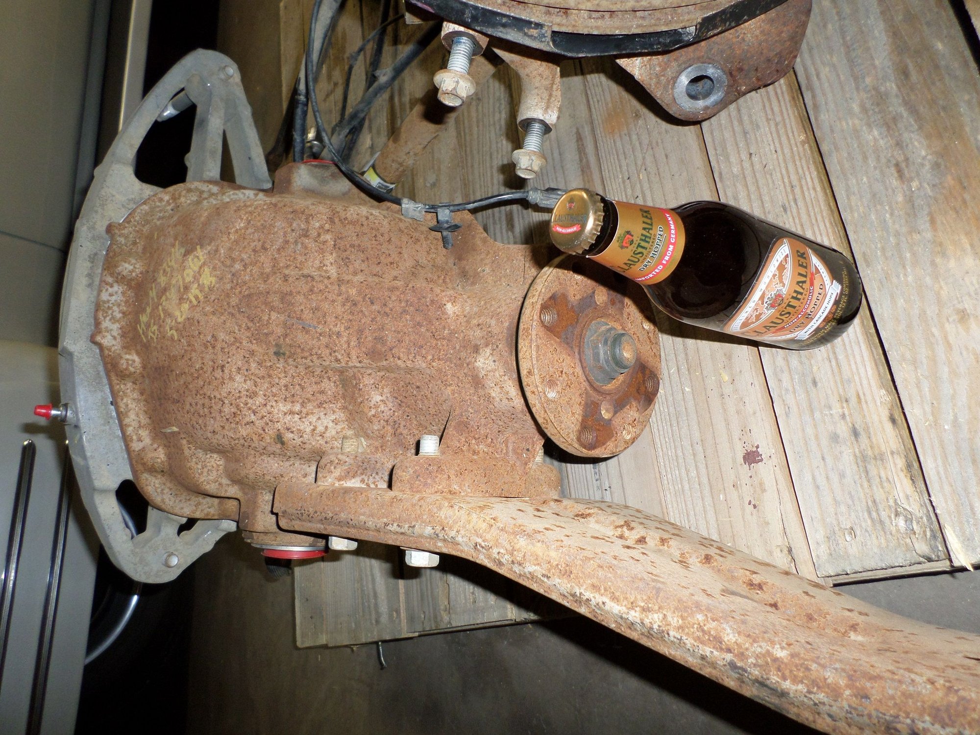

Broke down what I could and here are the axles, brakes and center section. This stuff is large and I'll be looking into trying to adapt a smaller disc rather than go to a bigger wheel. The Expedition weighs twice what my '39 does so I really don't need the extra braking power. As I start to build I'll post a few pictures.
