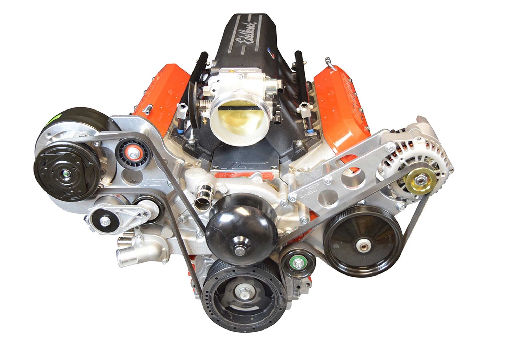

Next part of the project is to mount the accessories - alternator, AC, and so on.
Let me know if there are any questions or thoughts you have as far as accessory mounting and arrangement. We have a lot of options and can fit almost any chassis. Build looks good so far, that car is going to be a load of fun.

Thanks Ryan. You read my mind - I have been working out where I'm going to put things. Being in the desert, I'd of course like to keep AC, too.
From my understanding, the compressor usually sits passenger side, down low, on factory LS3 applications. I like your solution, but I want to keep the factory compressor (to fit on existing hose locations and harness plugs), so I've gone with a Holley mount which lets me do this.
Now trying to work out what to do about the alternator. There's a GM bracket that came with the pile of parts, but it interferes with the brake lines at the ABS pump (not a lot - can potentially just bend these out the way). Or perhaps another option, using a smaller alternator, or the one from the 350TBI.

Originally Posted by jamlip
Thanks Ryan. You read my mind - I need to work out where I'm going to put things. Being in the desert, I'd of course like to keep AC, too.
From my understanding, the compressor usually sits passenger side, down low, on factory LS3 applications. I need to go passenger high.
I've been looking at your site. There are a few things on there that could help me out - wish I had found it earlier so I didn't have to do so much Googling!
You are correct, the original LS3 compressor is down low. The factory Roadmaster compressor should be an R4 style, which will mount seamlessly in our 551585X-1 bracket; this will save you some cost in buying a new compressor. Lots of options for the Driver's Side accessories.
Thanks. I changed my reply because I remembered that had already bought the adapter bracket from Holley. If your unit includes the tensioners, it's probably a better deal though.
What's the situation with your alternator bracket? I have a GM one, which uses a later alternator, in my Big Pile of Bits, but it slightly fouls the brake lines that go to the ABS pump.
