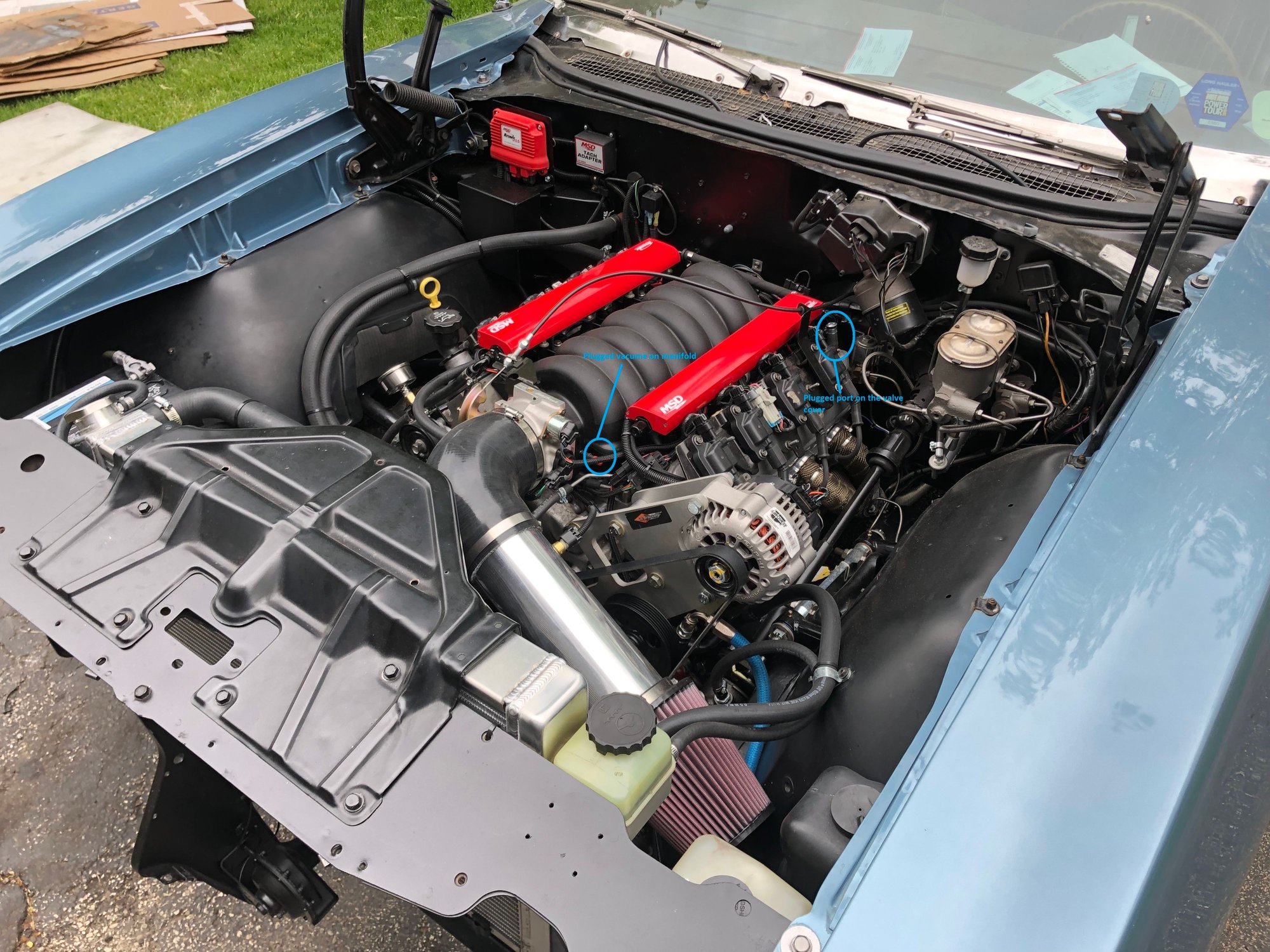

I have a L76 from a 2008 Pontiac G8GT with headers, Texas Speed Stage 1 cam and DOD delete kit from Texas Speed. Rest of engine is stock. It is in my 68 Lemans. after cam swap and re-ringing (engine had 30K on it) I have about 100 miles on it. I will drive for about 5-10 miles and when I park it I will get an 3" diam oil spot at the rear of the engine. I can see a drip from between the block and bellhousing. Nothing is coming down from the valley cover of above. It also leaks while driving because I have an oil film under the car. A person following said it is not burning oil. My first thought was that I did not get the rear cover and crank seal installed properly, but then I thought about my PCV system (or lack of) and thinking maybe I am building up crankcase pressure and it is pushing oil out through the rear cover. Is this possible? Following is what I did for the PCV system:
- From the passenger valve cover nipple ran a line from it to my intake tube ahead of the TB
- From the driver valve cover nipple I cap it off (I have also tried just leaving it open, came results, oil leak).
- Plugged the two inlets after the TB on the intake manifold.
There is no nipple on my valley cover from the DOD kit.
PCV problem or sealing problem?

Thanks for the Pic.. My passenger side is set up the same as yours, but I don't have a nipple for the "U" shaped line to the valley cover. See pics, zoom in to see my notes. Do I have an issue not having the nipple on the valley cover?

Near as I can tell - the only ventilation your crankcase has at all is through orifice-restricted passage in the passenger side valve cover INTO the air intake inlet. If that's correct, there's no manifold vacuum "pulling" on the crankcase at all. So you have no "PCV" arrangement at all. Seems to me you're likely to have crankcase pressure issues with the arrangement that I can see.
If both plugged ports in your picture are on the vacuum side of the throttle blade, I'd try connecting the one on the driver's side to the capped nipple on the driver's side valve cover. Then you have vacuum pulling on crankcase on the driver's side, and your "make-up air" connection on the passenger side.
If you wanna test the excessive crankcase pressure theory -- someone above suggested pulling up the dipstick until the o-rings AREN'T sealing. Clean up the bottom of the motor and then drive it for a while. That will let the crankcase vent through the dipstick tube. If the leak subsides, crankcase pressure was the culprit.

The OP does have the intake manifold pulling vacuum on the crankcase on the driver's side and he's running a line from the passenger side valve cover to the air intake bellow hence PCV. Is it restrictive due to the tiny orifice on the driver side valve cover? Perhaps but I don't think that's it either. He has an LS valley cover which has PCV built into it and it looks to me like its capped off. Connect the valley cover nipple to the intake manifold port or if you prefer put a sealed catch can between here to help slow up the amount of oil that could have reached the intake manifold. Then connect the passenger side to the throttle body or intake bellow. If still concerned install a small breather on the nipple on the driver side valve cover. That's how I would set it up if going PCV on your car.

#10 first picture he's showing the connection from the intake manifold to the back of the driver side valve cover and in the second pic he's showing the connection from the passenger side valve cover to the intake bellow.

Oh hell he's showing those as plugged off in #10 first pic.

If going PCV then he's missing the connection from the intake port from the driver side or passenger side "makes no difference" to the driver side rear valve cover. That is if the valve cover your using is the one with the small orifice in the line. If its the valve cover with the large hole on it then I'm pretty sure you install a PCV valve on the line between the valve cover and the intake manifold. Me personally I'd run 10AN lines of each valve cover to a breather can and call it good but that's me.
