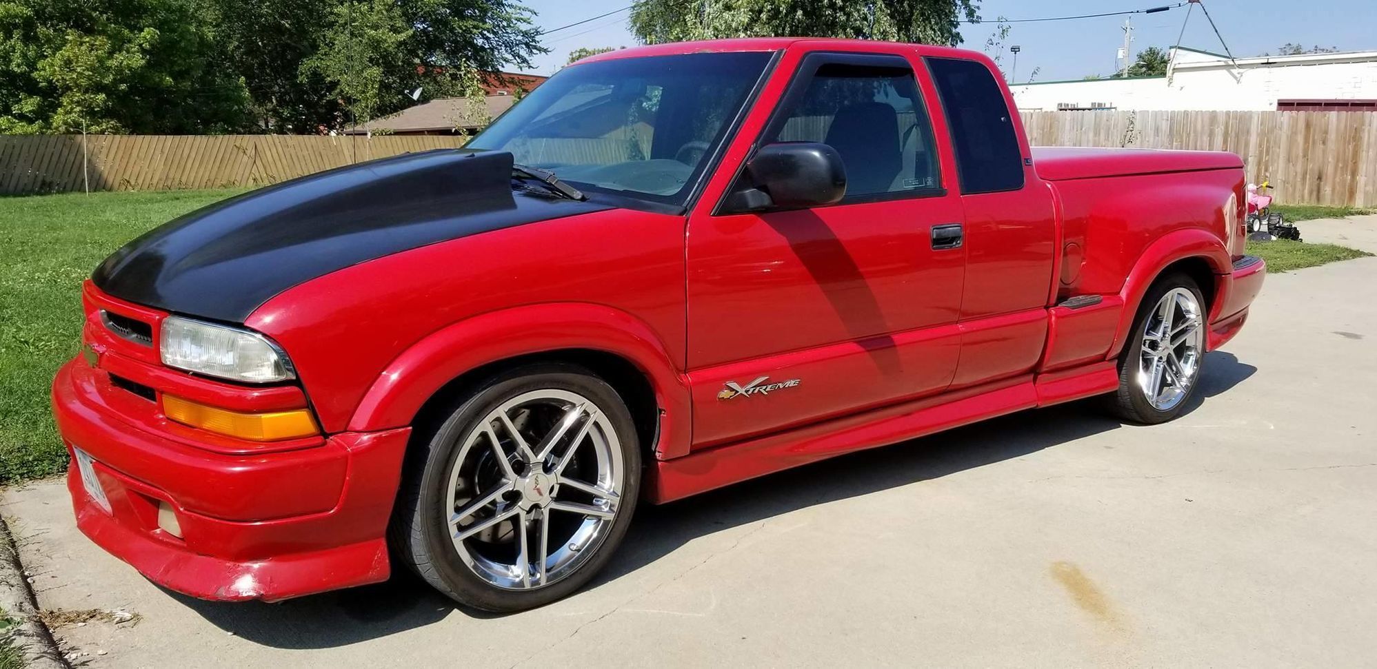

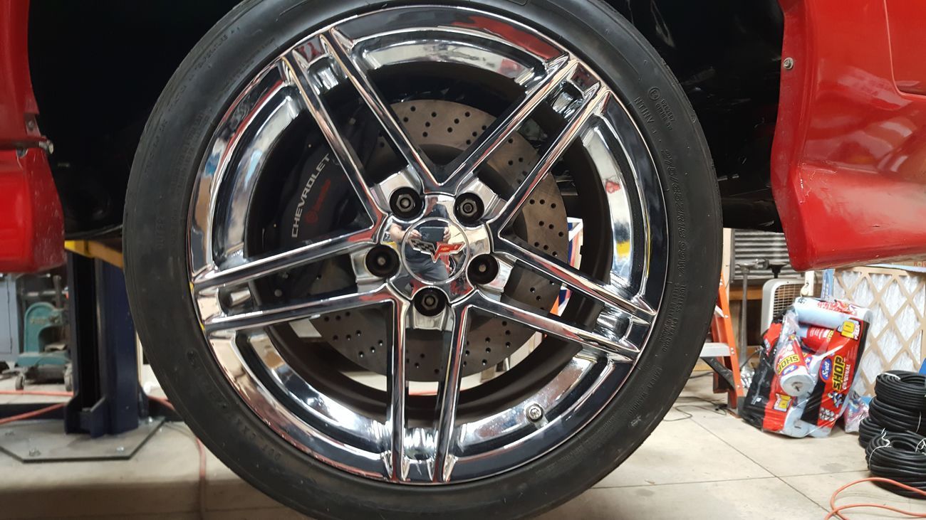

2000 S10 Xtreme Stock LY6 6.0 LSA Supercharger, LS9 Cam, TR6060 6-speed, Narrowed Frame to fit 19x12 OEM C6 Z06 wheels with Nitto Invo 325/30/19 tires and 18x9.5 275/35/18 up front. Big Brembo Front Brakes....It has some flaws in the paint and body but I built it to drive daily.

Originally Posted by G Atsma
Boy that'll sure put the hurt on the unsuspecting......
It has, Usually ricers...They roll along side and blip the throttle trying to get me to take the bait, I do a burnout at 40mph and they suddenly don't want to roll beside me anymore.

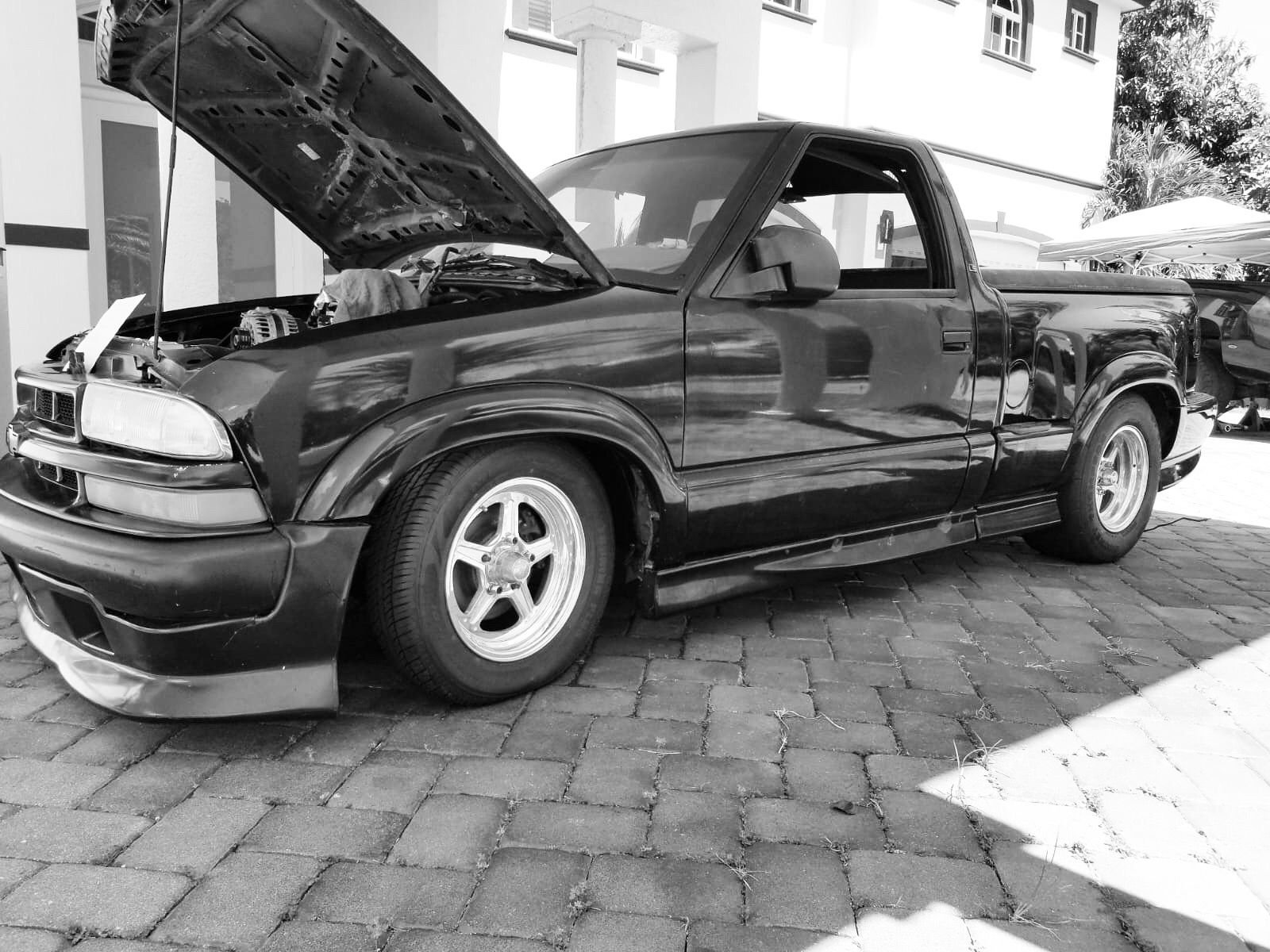

Made it to FL2K. Got a few passes in, the best pass was 11.9 @118 . I need to find a way to get my 60ft down. I’m consistent around 1.8-1.9 ... I have a 370 gear, Caltracs, da Vikings rear, 90/10 up front with Moroso trick springs. I understand I am super limited since my cam and converter are made for nitrous. Pretty happy with the results, but I want to improve! Any advice?

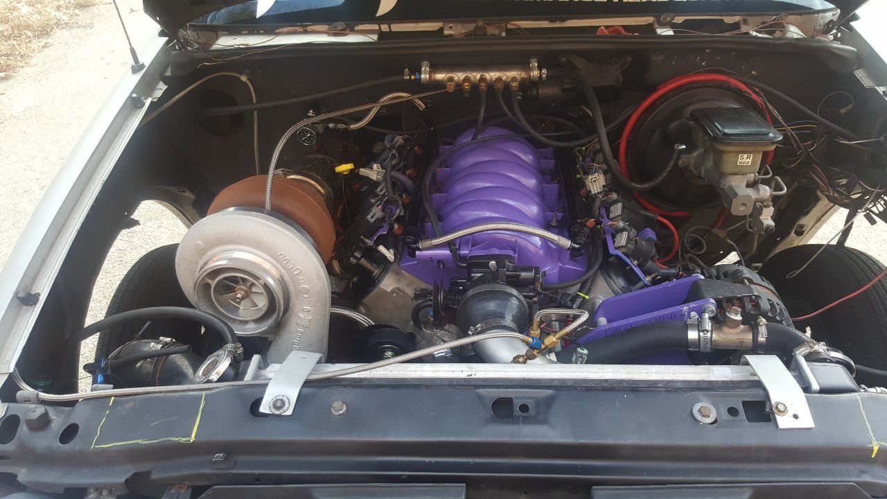

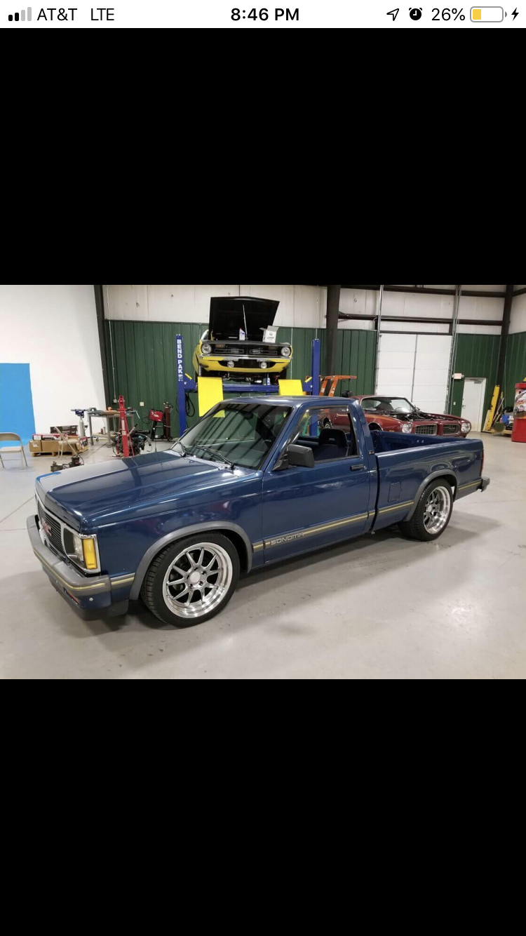

Here is my now LS swapped S10. I guess I never posted this thing.
