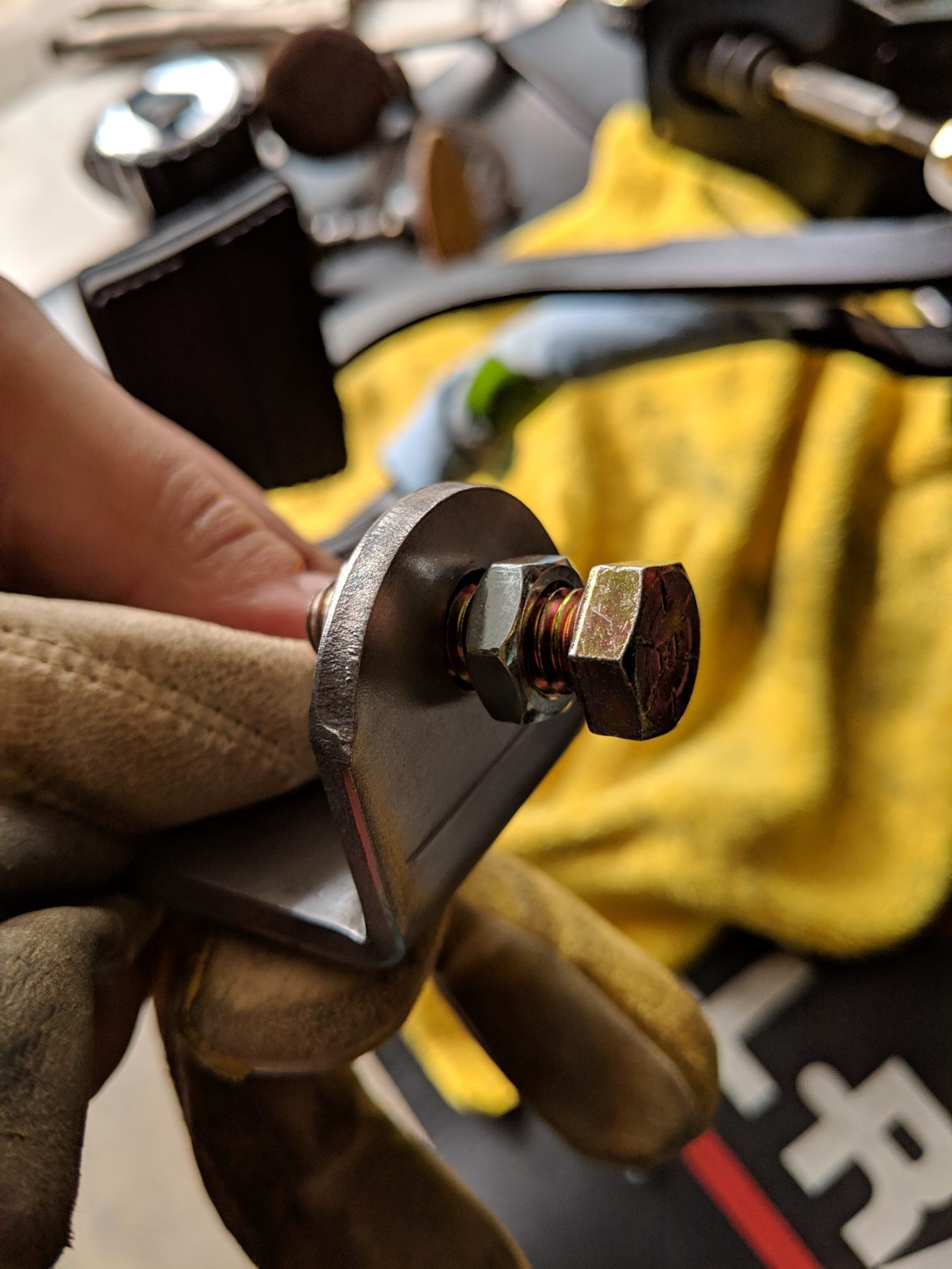

Not sure what master cyl set up you are using but you will also likely need a clutch pedal stop. I made an adjustable one by welding a tab/bolt/jamb nut to pedal hanger/assembly. pics attached.

At this point in time I dont have a clutch pedal at all. 70 nova, automatic car. I was considering buying a hydraulic clutch pedal setup but they are about $300. If I had a stock pedal I might be able to make something up.

Oh Cool! You've got the knowledge/tools to set up what you need. Your current pedal assembly should be fine just order up a repro clutch pedal. The Mcleod item is an adapter that works on the stock clutch pedal. I chose another route (tilton master/DSE plate/adapter) which is why I chose to make my own pedal stop. Best of luck with your project and good to know you're the one who does that cable set up. I might have gone through you years ago when i had mine done, lol...

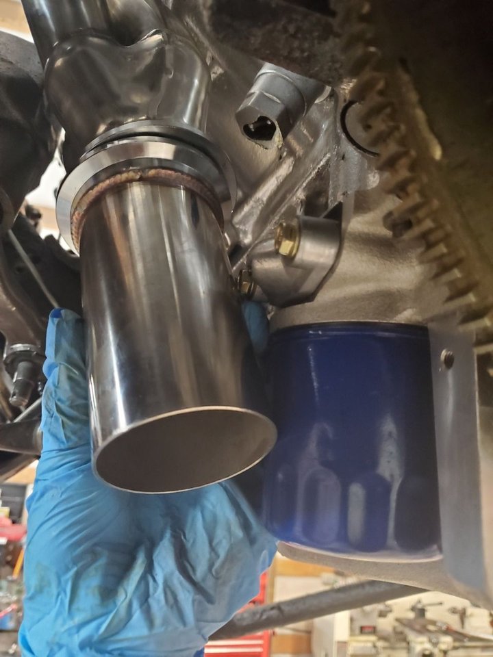

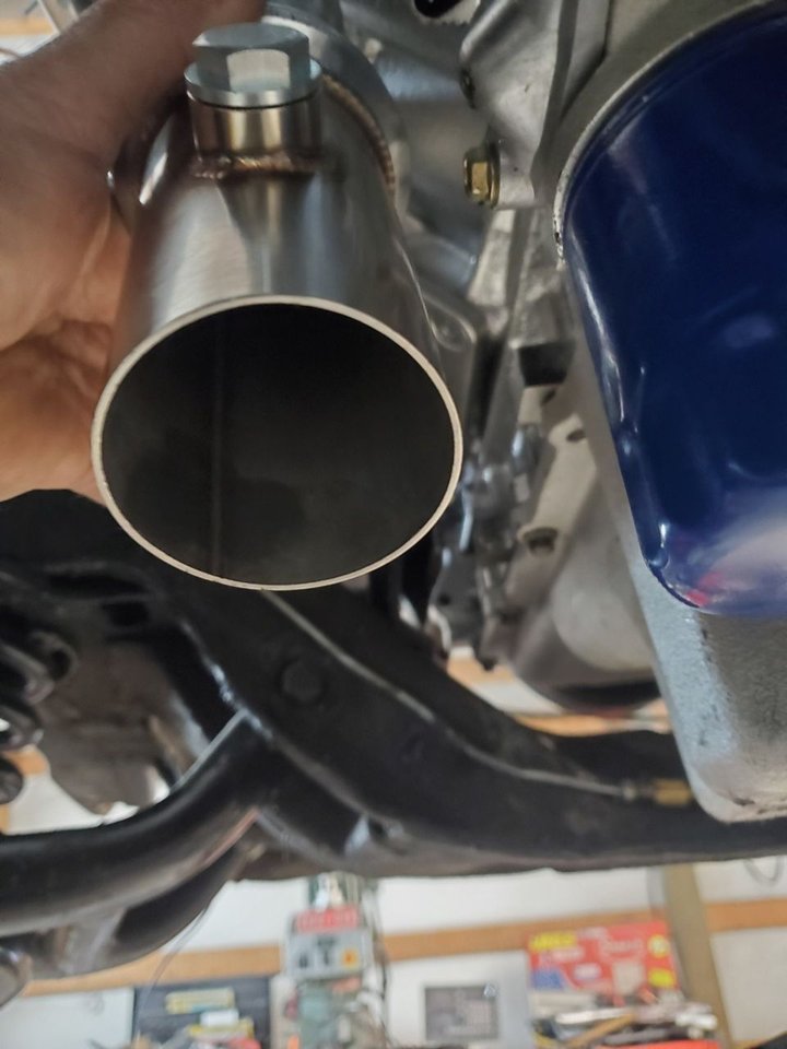

I've found a work around on my header clearance problem. The collector was pointing directly at my oil filter and oil cooler block off plate.
I've cut the flange off the drivers side header and going to have it welded back and an angle. It won't take much of an angle to clear, but I'd like some air gap between my exhaust and filter. I found a guy that builds boats and he will weld both the headers up for $80. He is one of the few around here that will take on a small stainless job.

Well I cut the flange off the headers and now the collector clears the oil filter. I just need to get the flanges welded back on.
