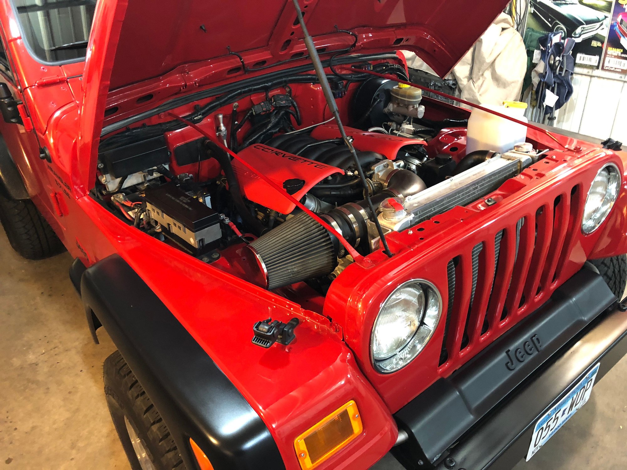

I also have a LS6/4L60E 98 Wrangler. Great swap. Also have an 8.8 rear end out of a Explorer. Zero issues. 241 TC out a Rubicon. Did the swap about 12-13 years ago. It's been bullet proof. I plow my drive with it in the winter. Mall crawler in the summer time.
That looks great my man!
