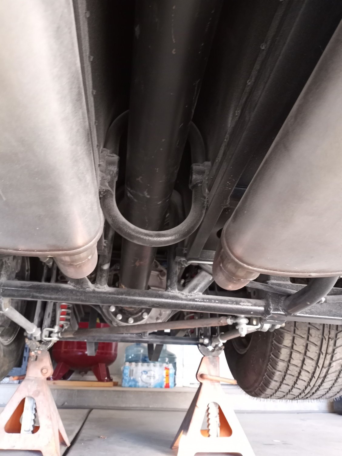

Little under construction pic.

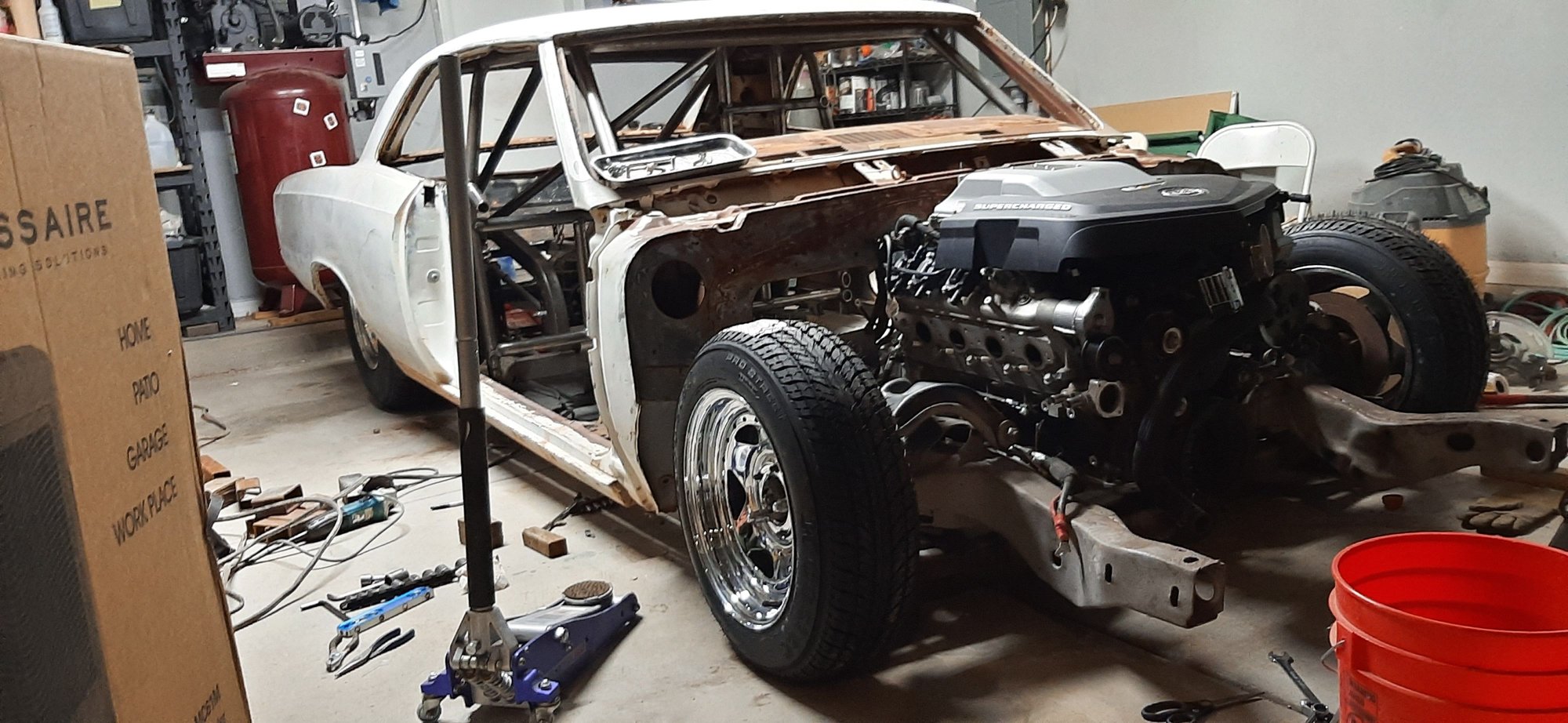

other side view

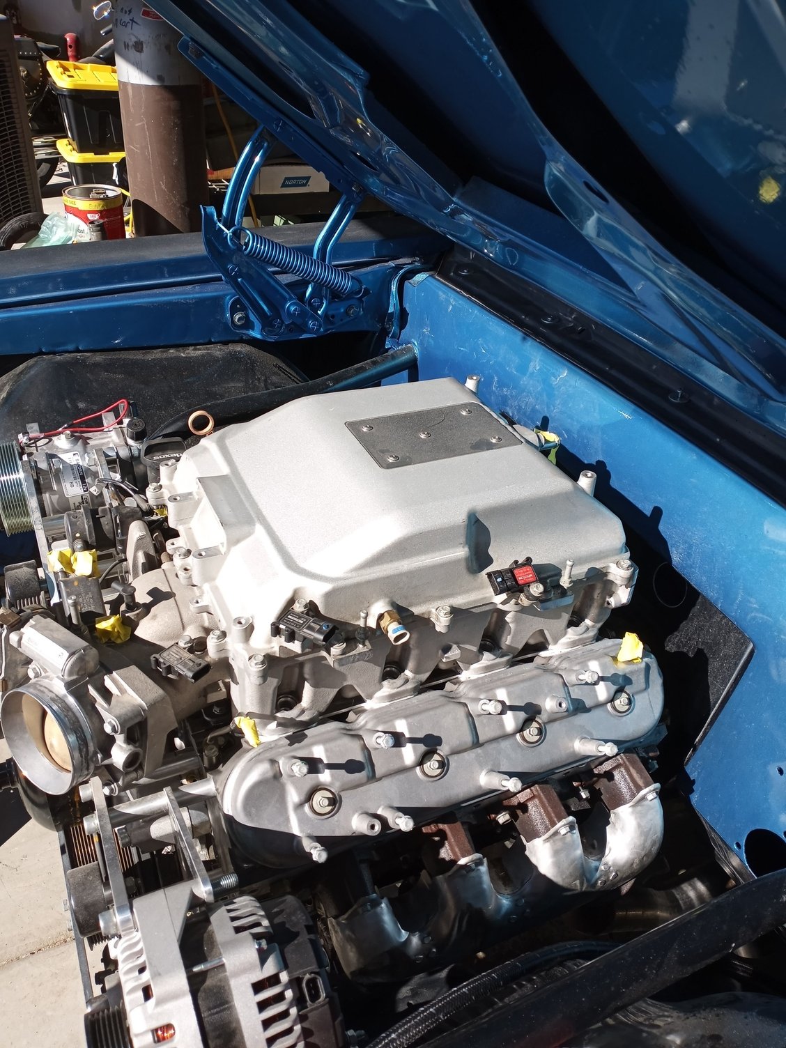

Couple of recent pics

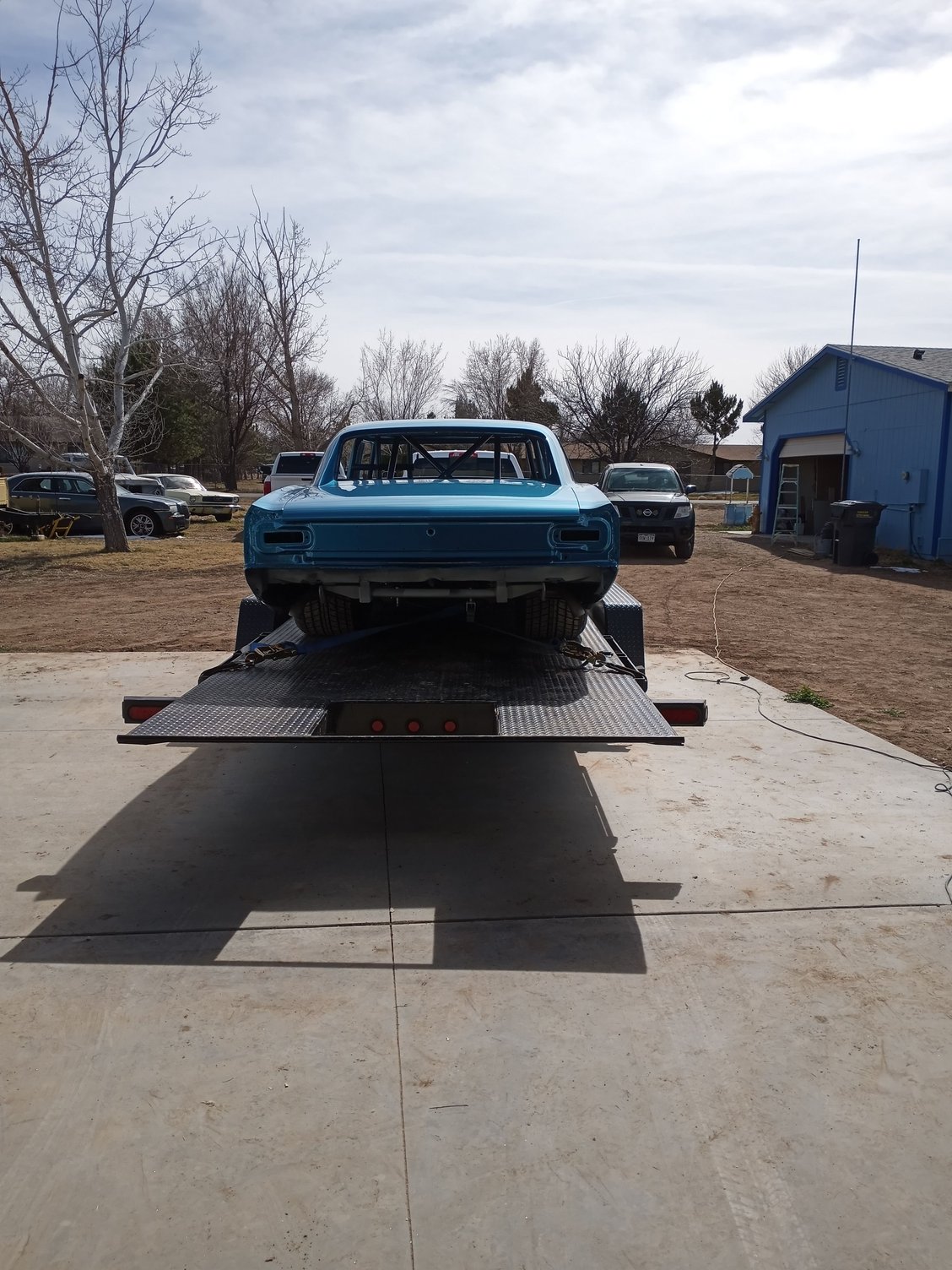

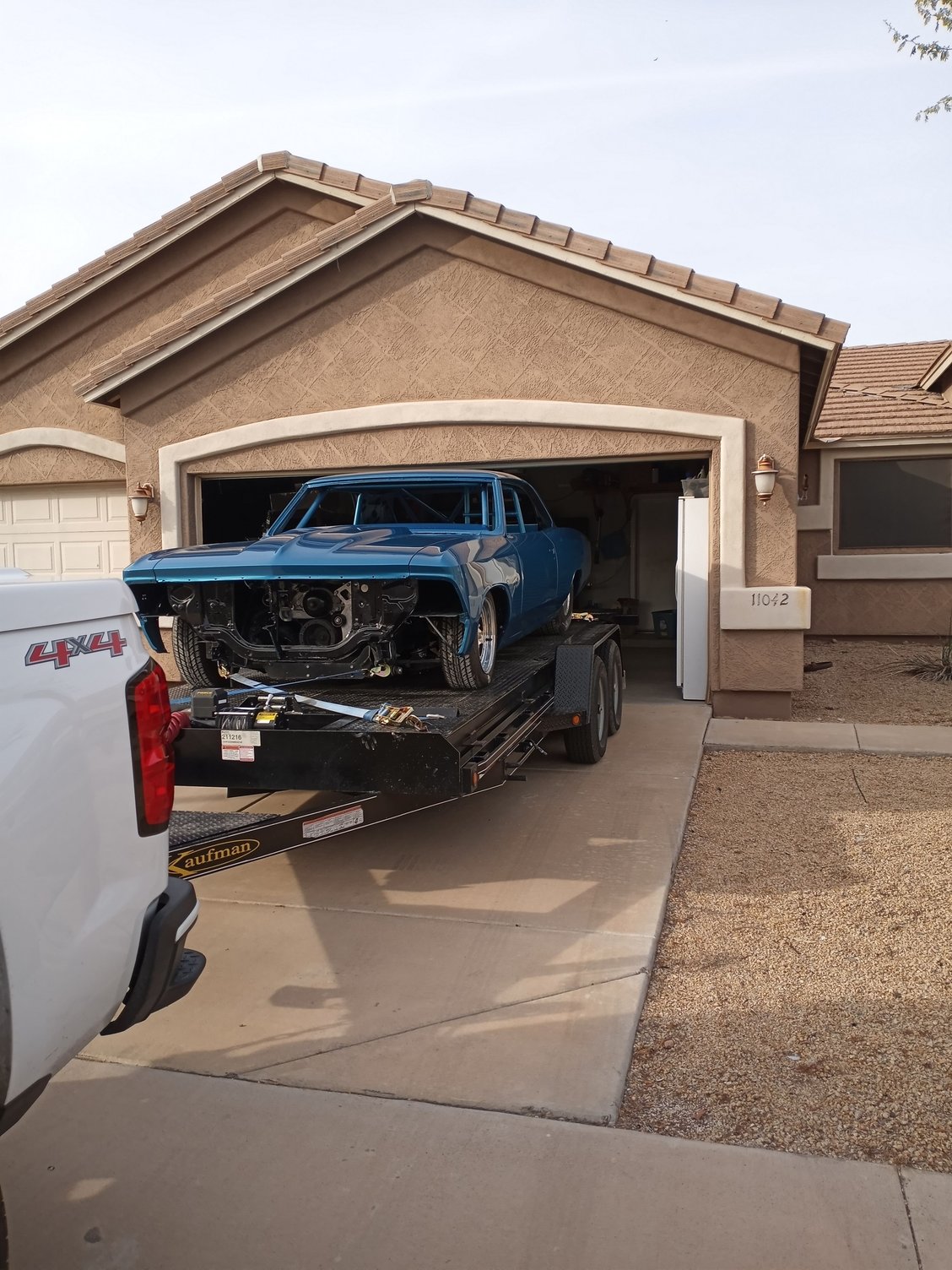

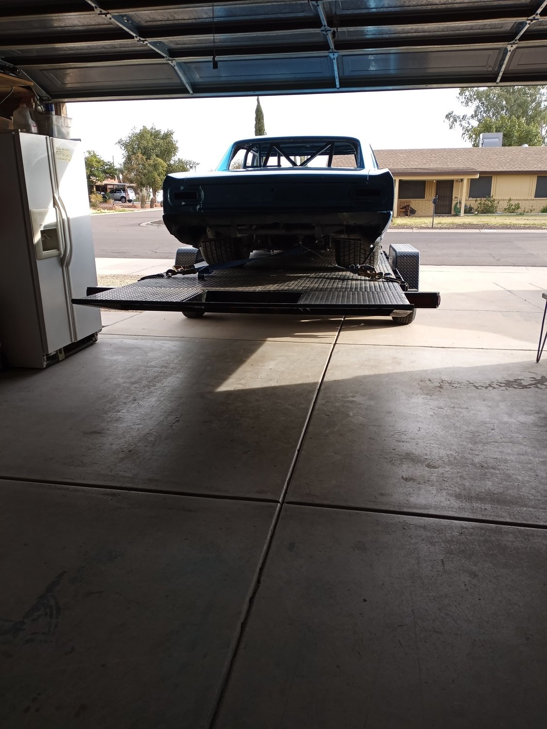

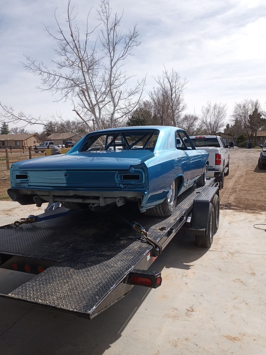

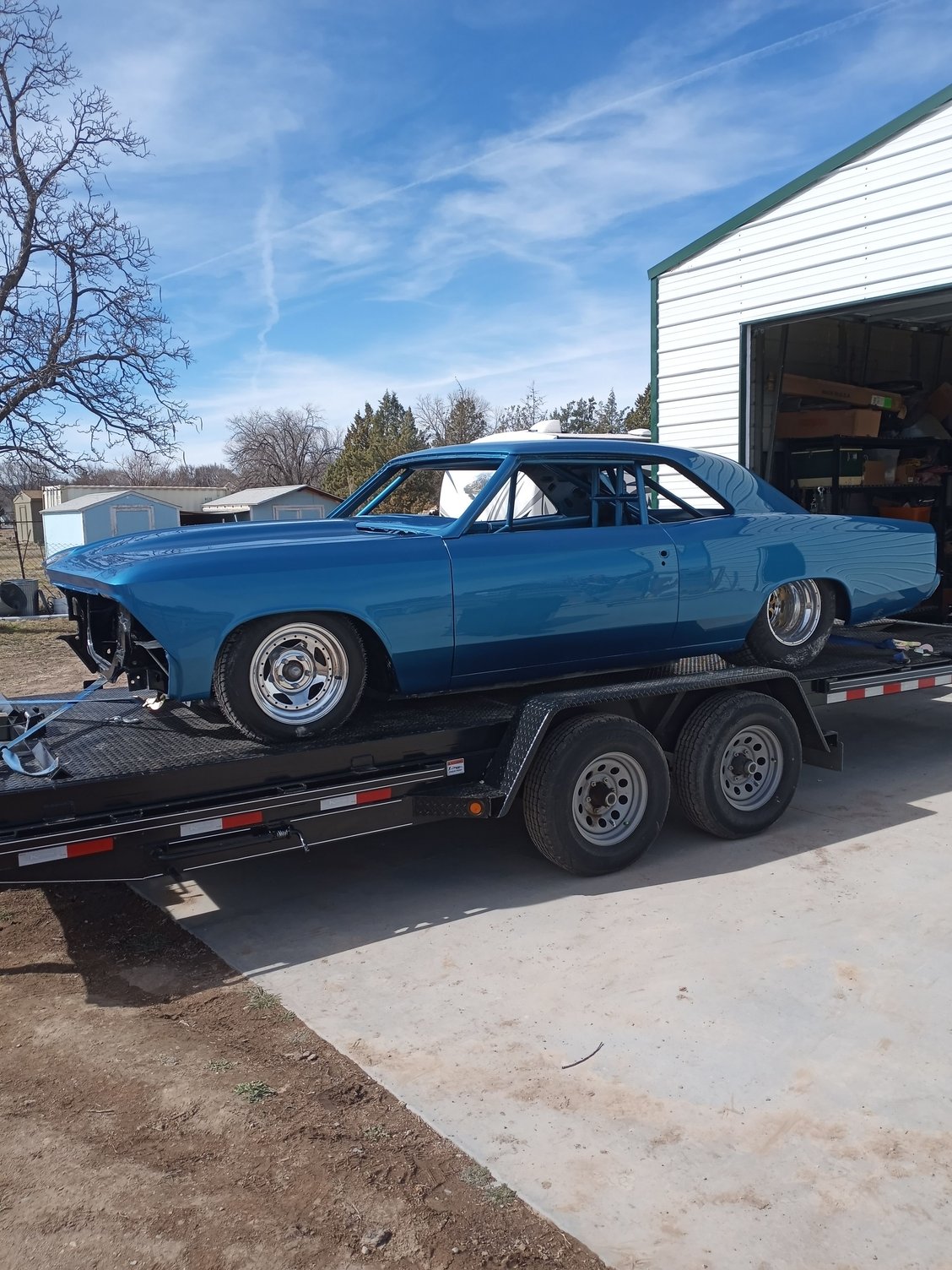

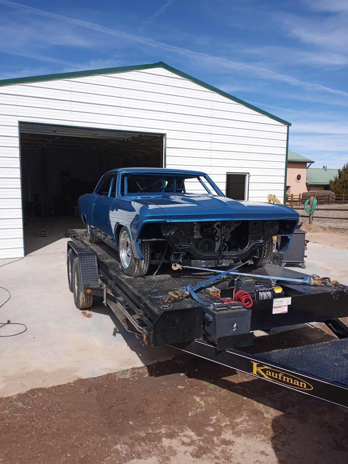

Been busy since 12-2020. I had a fab shop work with me on replacing all the floor and new firewall, etc. I spent about 10 months doing the metal work, filler work, primer, etc. Got ready for top coat and hauled it to my buddies work shop in Prescott and had him shoot the top coat. First time I had bought cheaper base and it came out a little splotchy so I had him sand the car and re-shoot it. Then cut and buff it (1st go) before I hauled it down home to wire it and start finishing it up and getting it ready to fire up.
