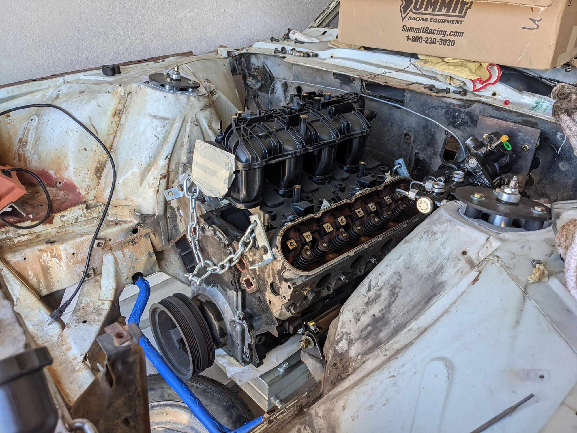

These images shown the magnitude of the problem, the car is unibody and the shock towers are stressed members so it can't take a wide engine, the FE that it came with (which I still have) barely fit. The engine will be raised about 0.5-1" from it's current spot so the oil and transmission pans aren't so low.
One advantage of the full size car is that a trailblazer ss intake actually fits. Just barely. I intended to use it but I have a different engine for the car now that will need a different intake.

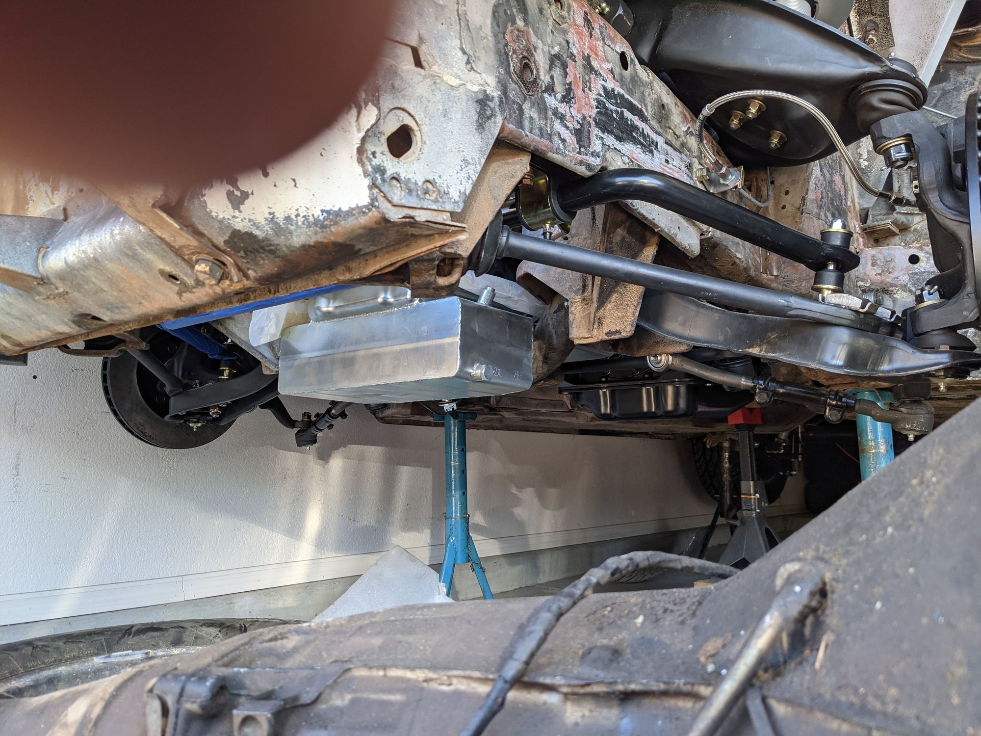

How to build a Resto-Mod. Fuel System, Step 1:
Stock fuel tank is full of rust. No Bueno. Order a new one, and it fits great, along with a new fuel sender and fuel level sensor. The fuel sender is 3/8 line, but the bends look like they were made by an orangutan with a pair of channel locks, will flat out NOT flow enough fuel for a worthwhile engine. The car will be fuel injected so I need a real pickup and return, so I decided to use the stock pickup as the RETURN, and bought a Holley fuel pickup sock that comes with the 3/8 pickup, drilled a hole for a -6 AN bulkhead fitting in the pickup face, and bolted the whole thing together with proper chemical resistant gaskets. Bent a new stainless internal line with flare nut fittings, fished 4" wide the pickup into the tank through the 2" wide hole, bolted it all up and it seems pretty good. The only change from the outside is the pickup has an extra fitting.
Total Cost: Way too much.
Time Investment: Way too long.

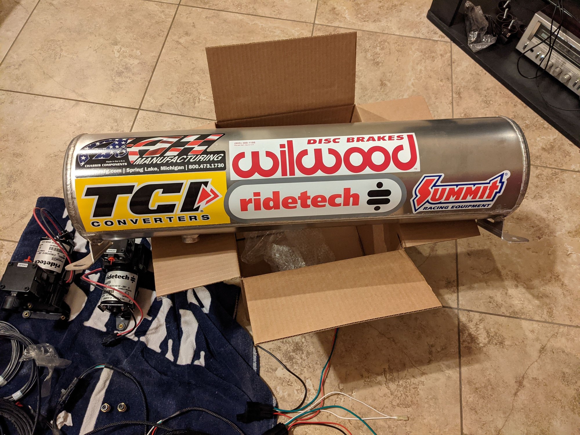

Mapping out the ride tech air suspension system I actually bought years ago, it's finally to the mockup stage. The old TBird has a perfect place to mount the tank and pumps, up and behind the rear seat and not down in the trunk or spare tire well. It should be pretty good when it's mounted, tidy and compact at least.
If you do use air springs, the air tank is a great place to mount some stickers.
