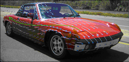

As far as the aerodynamics go, you can use the old yarn trick. Cut up a multitude of yarn strings about 3-4" long or so and tape them all over the body that you're looking at. You'll be able to 'see' the air flow to help you decide where to vent or where not to.
If the yarn is standing straight out, or curling, it's a bad place.
Actually found someone tuft testing a tesla nose.
https://www.youtube.com/watch?v=x1X0x3SGxP4
Interesting, thanx. Wouldn't yarn straight out indicate a good place for the vent due to low pressure?
No, you'd want to vent where the yarn is laying flat. Take a look at Bernouli's principal with how velocity and flow can create vacuum pressure.
