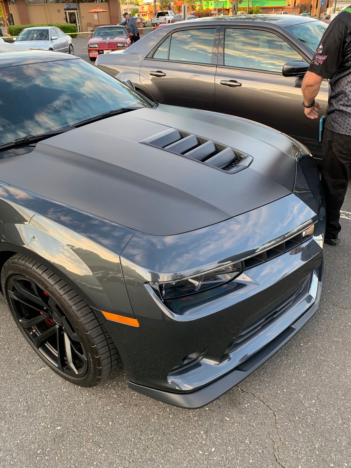

Old Apr 17, 2021 | 01:39 PM
  #72
Michael Yount's Avatar
Joined: Jun 2015
Posts: 3,125
Likes: 501
Note location of vents

Note vent location

Of the vents shown above, are either strictly cosmetic? Or do they both work?

Both functional - took the pic of the Camaro this morning; the Aston is the V12; takes up more space than the V8 and has more thermal load to shed; hood vents needed to help manage that.
