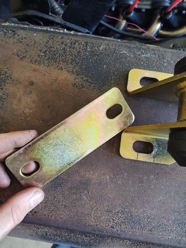

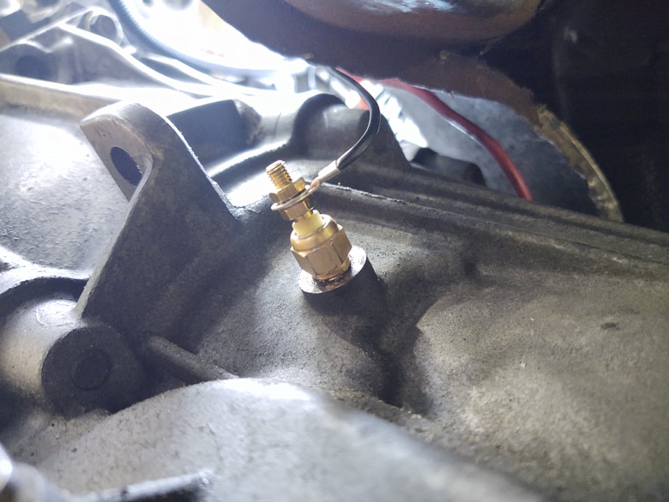

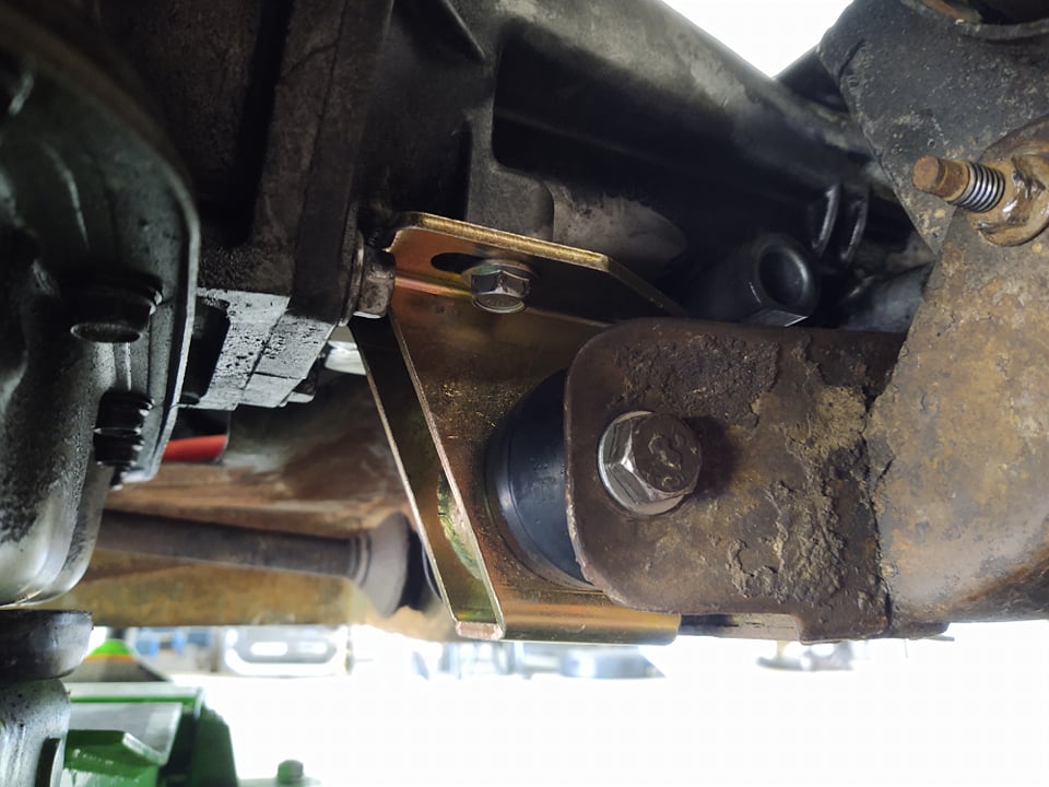

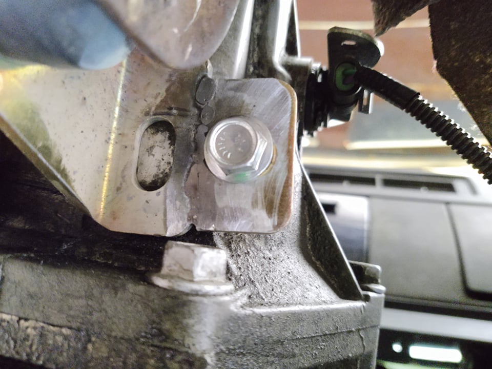

Got more done on the **** box today.
Been procastinating on doing the trans mount because i knew id have to do some cutting to the crossmember and welding on another plate etc etc. Im not a welder, i will never be a good welder as i don't care enough to be one lol. I will also never be a good fabricator, Ill just be "good enough" lol.
But after thinking about it for a couple min figured i could use the stock mount which leaves the crossmember alone and keeps the factory pinion angle, and this is what i did.
Then i hooked up the trans temp sensor. I pulled the volt gauge out because for me personally theres really no need for the gauge. Anyone thats messed with cars long enough knows the symptoms of no charging or over charging lol.
I also got the trans pan removed and cleaned up along with putting on a new filter and gasket. I found a good amount of sludge on the pan magnet or maybe it was metal. Wouldn't be surprised lol. But i know the trans works because the yoke i have in the back to keep fluid from running out spins while its running. We'll just have to see how long it last... lol
