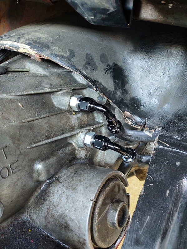

Very minor update. Moneys been extremely tight so i had to do something that didnt cost much. So, i ordered ICT Billet trans line fittings to run the rubber line off of AN but not AN style fittings (dont know the name of them) lol. Cost was around $40 for trans fittings and AN fittings. Im doing this as i just had the rubber line on the cut stock line. Didn't leak but i did that just to get the car running. I knew i couldn't keep it that way especially when it comes time to cover the transmission up. Which, is on the list. Ran out of day light, but snapped a pic. I have to cut a little more of the floor so i can route the top line better. Obviously i wouldn't keep it this way. Or would i... lol. Ill post an update once i do that.

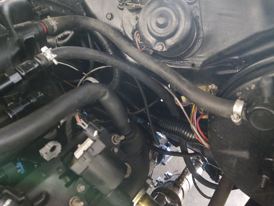

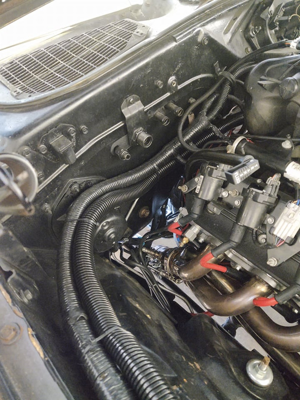

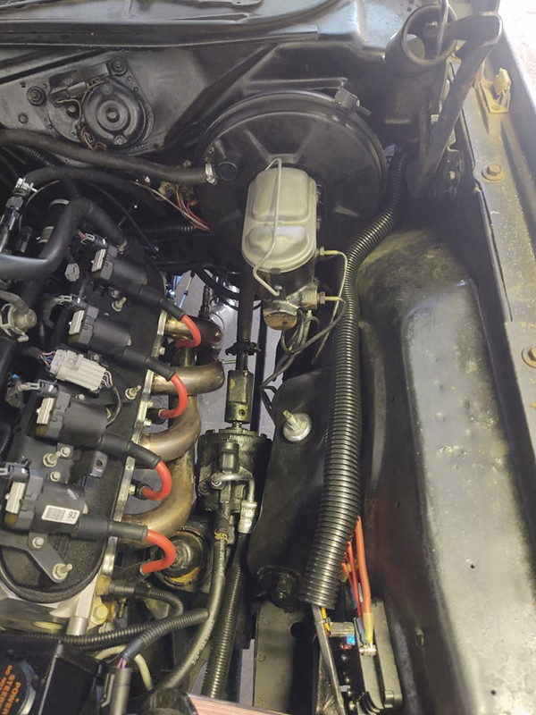

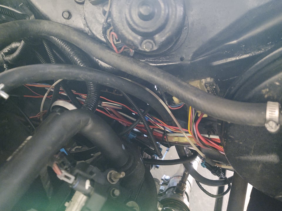

Forgot. I also added some wire loom to clean up the wiring in the engine bay. The wiring on the fender well will get situated a little more but aside from that, thats it. Wish i would have put the relay somewhere else but oh well, maybe ill do that some time down the road. Just want to drive the car already but have plenty left to do and no money to do it lol.

Well got the trans lines re routed. Now i need to figure out how im going to do the transmission tunnel as i've never done one before. Wont be able to do anything else to the car for a little while so these lines are really it as far as an "update".

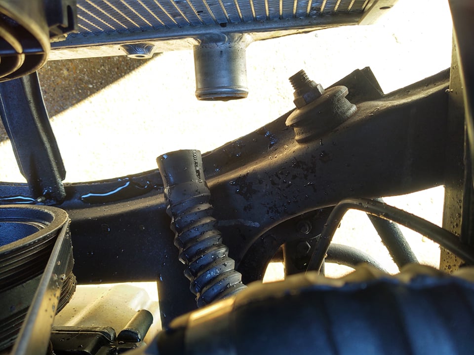

So i got the courage to take the Cuda on its first trip around the neighborhood. I actually drove it around 3 times. I didn't want to stop.. lol. I just want to daily drive it already so bad but she still needs a little more love before we get there, and money lol.
99% success. Only the rear view mirror fell off, nothing broke, and as long as I stay in the neighborhood all the gears in the 4l60 work .
But, I don't think the converter is locking up. I put it in 4th and it works but if I manually shift I can only feel it shift up to 2nd. But I may just not be getting up to speed for it to shift. Only issue i came across is the lower radiator hose leaking. Its half inch end but the radiator is 3/4 inch end. I thought i was slick and stuck a 3/4inch rubber piece on there and stuck the radiator hose in that and tightened it down and it never leaked until i drove it today. Basically the rubber just squishes together when tightened and it leaks. It obviously needs to tighten down to something hard so i need to find an adapter.
