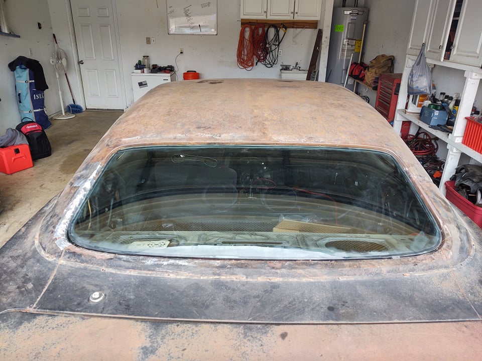

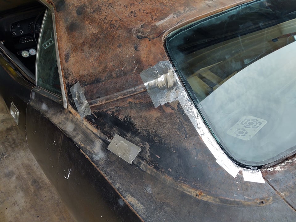

Today I got the rust holes fixed up and I put the rear window back in. Chose not to do fiberglass this go round so yall should be proud of me. Maybe next time ill actually use metal? but probably not. Too much metal work needed on the back end of the car for my wallet so... lol. I enjoy posting the pics of how i cheaply do rust repair stuff in Facebook groups. The internet builders get REAL mad lol. But at some point waaay down the line if i still own the car ill replace metal but for now, the ol girl with her LS just wants to hit the road. I will spruce it up some and paint the tape black so that you at least cant tell from about 15ft that its tape. Plus the reflection off that Tx sun in the summer would be brutal lol

So when you say you fixed them, you covered them with duct tape?
It's a specific 3M aluminum tape for metal.
is it specifically for rusty metal? Asking for a friend.
Yes and no. It can be used the way I used it, then lay some fiberglass or Bondo over it, smooth it out and call it good.
Yes and no. It can be used the way I used it, then lay some fiberglass or Bondo over it, smooth it out and call it good hidden.
I love what you are doing with the car, but it will come back even if you can't see it.
What will come back? Lol
That nasty CRUST we MUST call RUST that shall turn your body into DUST.

Little trick, paint the metal with POR-15, AND BEFORE IT DRIES, lay the extra thick aluminum tape on it.
its almost like its welded and the POR will stop the rust from growing,
You can also use light weight fiberglass cloth and glue it down with POR-15 to fill rust holes in the floorboard.
Layer as needed, needs time to dry but itt produces a very thin patch that you can feather in.
Thanks, didn't know those tricks. When i fiber glassed the roof of my challenger i used the fiberglass patch on the big hole in the roof. For the holes where the roof line and window channel meet i used house foam, then fiberglass over it. I actually do plan on replacing metal at some point.

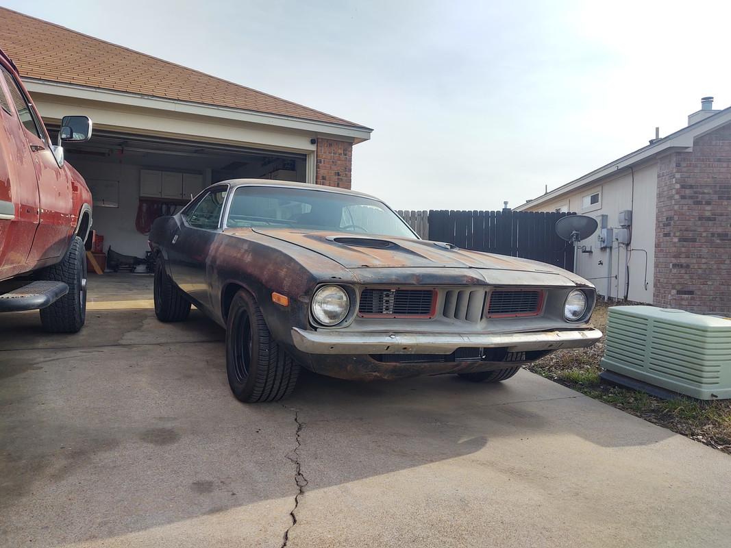

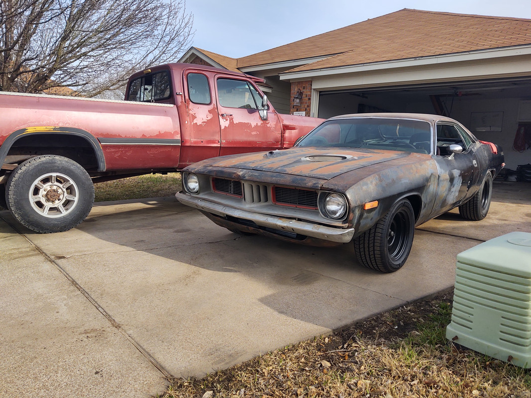

Got some stuff done today. I was able to source a used grille that had minor broken pieces but is still in far better shape than the one i've had just sitting in place. Got it for a steal thanks to they guy that sold it to me, not all mopar guys think their stuff is worth gold.. lol
I got that grille in, and the rear window trim in. I should be heading to Summit to get a trunk lid this coming weekend.
Also, don't mind the messed up bumper on the driver side, im sure the bracket is bent but no point in messing with it as i want to switch to 72 bumpers and those take different brackets anyways.

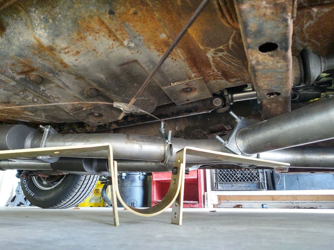

Did some nick knack things today while i procrastinate on needing to fix an oil leak, transmission tunnel, and putting in the in tank fuel pump. So I tried mocking up the driveshaft loop. I knew when i took it out of the box it wouldn't work with both loops connected, so i took the top one off and still, with where the x pipe sits there's no chance of anything fitting under the driveshaft. Unless i move it farther back and mount it? Just thought of that as i type this. Well damn, i might do that. Either way i cant use the top loop but i think id be able to have the bottom loop sit under it, farther back behind the x pipe. Also, where the x pipe sits the x pipe will catch it lol. But my luck, that'd happen, then the x pipe would fall off and it'd just be a mess. What do you think?

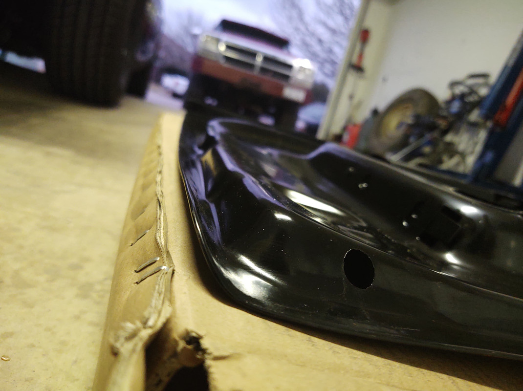

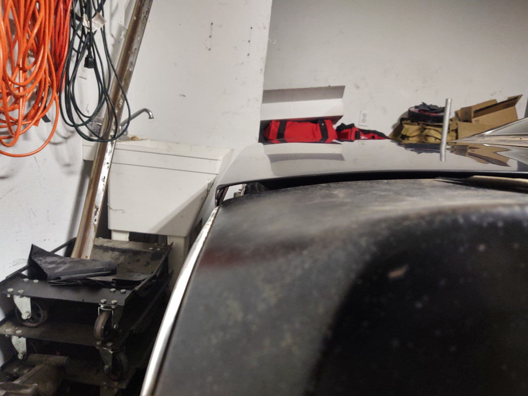

Of course, the lid was bent... In the pic you can clearly see it bent up, its supposed to be completely flat. I would think it was dropped from a decent height as its creased also. I just took my rubber hammer to it and flattened it as much as i cared to. I got the cheapest trunk lid you can get anywhere so can't be surprised. I also paid for most of it with gift cards so im only into it for $65. But of course, it doesn't close tight and the passenger side sits up all crooked. I believe the issue is the new Chinese trunk lid latch which of course by itself was $80... Used "OEM" latches go for over $100, good ol mopar... So what im going to have to do is lengthen the holes on the latch that the bolts go through so that i can have the latch sit as low as possible in hopes the trunk lid latches farther down, if that makes sense. I've never messed with this kind of trunk issue so im wondering if maybe the hinge spring/bar is worn out? don't know... Cant have just one thing go on, go on easy, and fit correctly... lol
*UPDATE AFTER ASKING QUESTIONS ON FACEBOOK*
I went out and pulled the rod off that keeps tension on the hinge, (it only puts tension on one). The lid closes nice and flat/even now. Unsure on how these mopar trunk hinges work so ill most likely just keep the rod off and have to just hold the lid up by hand if i need in the trunk. One less thing i can just mark off the list and move on lol. Ill post daytime pics tomorrow.

Still doesn't sit 100% flat but im pretty sure thats because the brand new $80 latch doesn't fully "latch". It just 3/4 latches which that extra 1/4 latch would pull the trunk lid down a little further to where id prefer it. But they left the factory like this and its a million times better than the original rusted out lid so, can't complain too much.
