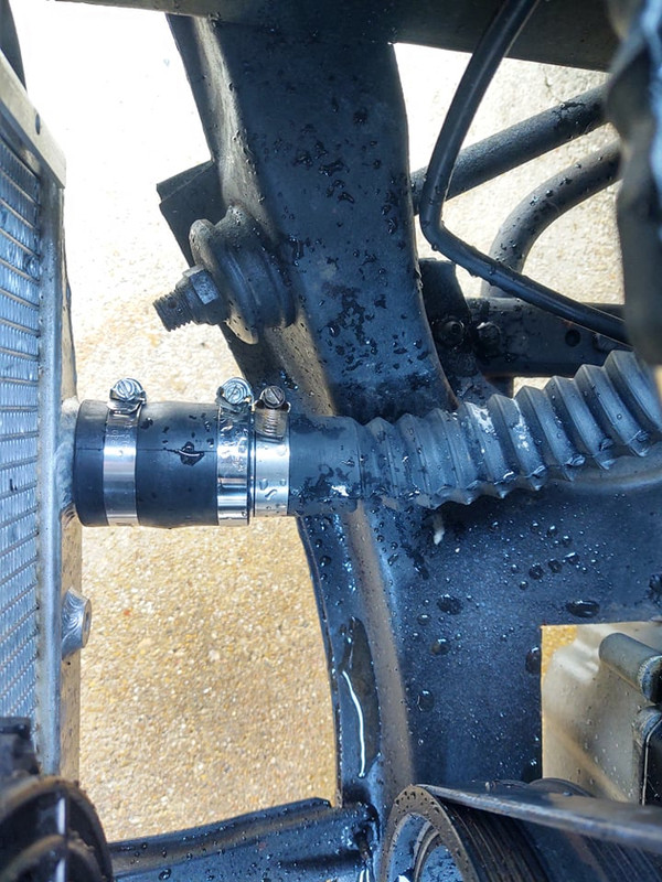

So i ordered an ICT adapter for the lower radiator hose and thats fixed. Next i need to replace the TPS switch inside the transmission. I keep getting a code for it but ive ignored it till now as I thought it was nothing important, then it clicked as to being why the transmission shifts rough and most likely why i had the weird shifting issues on the test drive the other day. Hopefully this switch fixes it. I was not gentle with the transmission the last time i put it in the car so, im not surprised lol.

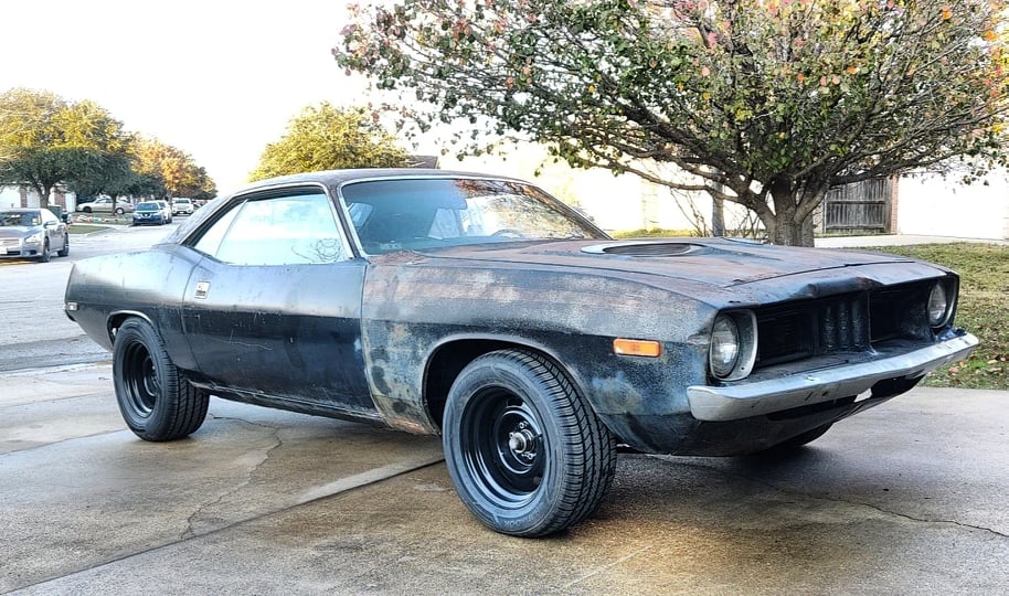

Also, lowered the front end just a tad over 2 inches. Not sure how I feel about it... First time running 50 series 15 inch tires and not sure i like the look on the front with that series on a 15inch rim... You tell me. Rear is stock height as far as i know. I will at some point put on a set of 2 inch lowering springs. Im ok with a very slight rake but not the old school rake lol.

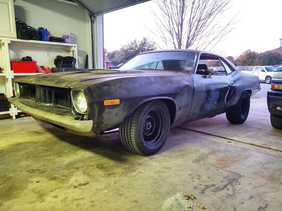

I put the car on the mostly level street and re adjusted the front end height. Way too much rake for my liking with lowering the front 2 inches so I brought it back up an inch. Thats where it will stay until i can get the rear lowered.
The car still sits lower in the front than this picture shows even after i raised it back up an inch. I think the unlevel street makes the front sit higher. As it sits in the garage right now the top of the tire is even with the wheel well opening.

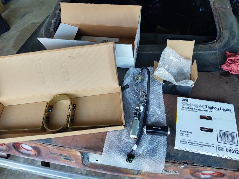

Ordered some stuff and they showed up today. Love that Summit is only 2 hours from me. Means my parts get here next day most of the time. But, unlike the theme ive had going of "as cheap as possible" for this build. I chose to bite the bullet and spend $400 on an in tank fuel pump. My external pump is mounted on the bottom side of the trunk pan right above the sending unit of the tank (on a cuda the sending unit is on the side of the tank). I put it there because there was absolutely no where to put it below the tank. I barely found a spot on the frame rail next to the axle to mount the corvette filter/regulator. So, i just knew that that pump would burn up pretty quickly and it SUPER loud. You can hear it over the exhaust, so the in tank pump takes away quite a few issues. Im adding an external fuel filter which i got off amazon, im keeping my driveshaft the way it is with the extended yoke so i got the $45 driveshaft loop for insurance. Then i got some butyl tape so i can put the back window back in.
Im on the hunt for a trunk lid and grille both of which im afraid im going to have to buy new and i really don't want to spend $600 on a grille for this car thats 90% rust but, mopar... lol
So, im at the stage of the build now where im trying to finish up just the bare minimum stuff to get the car on the road.
