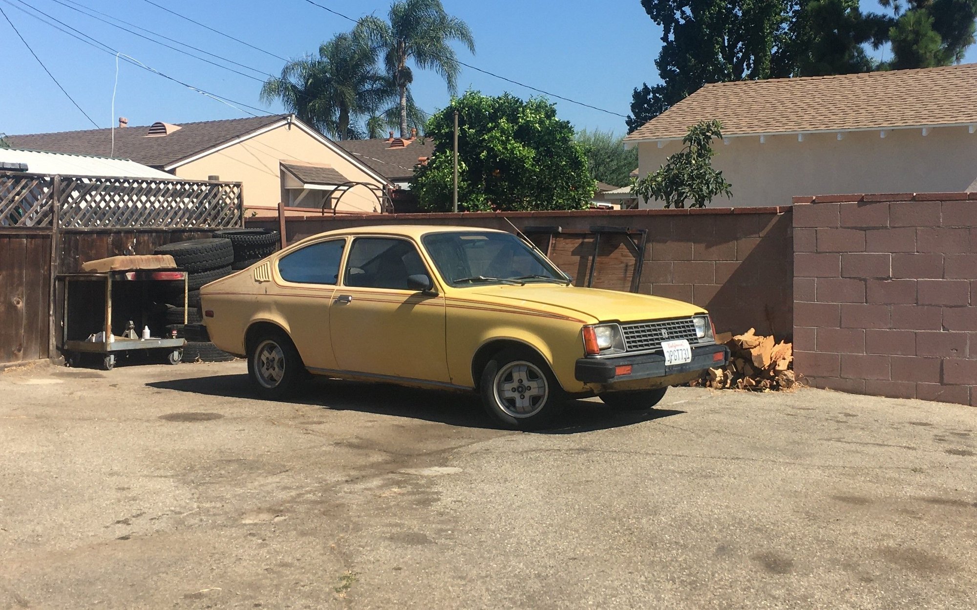

Starting a build and a buddy told me I should start a thread on it just because it's fairly unique. The car is an '82 Isuzu i-mark diesel. My previous build was a 9 second '65 Pontiac Tempest that had a turbo 4.8. Had a blast with that car, but after we finished RMRW it was time to send the old boat off and build something a little lighter. Well this car came up and in CA we can't be picky about what comes up, so I bought this gem:
Its small and light. That's about where the pros end. From the factory they weighed low 2000's as far as I have seen, 95" wheelbase. Will be a whole different build from the '65, so I'm hoping to learn a lot and put some of my "skills" to the test.

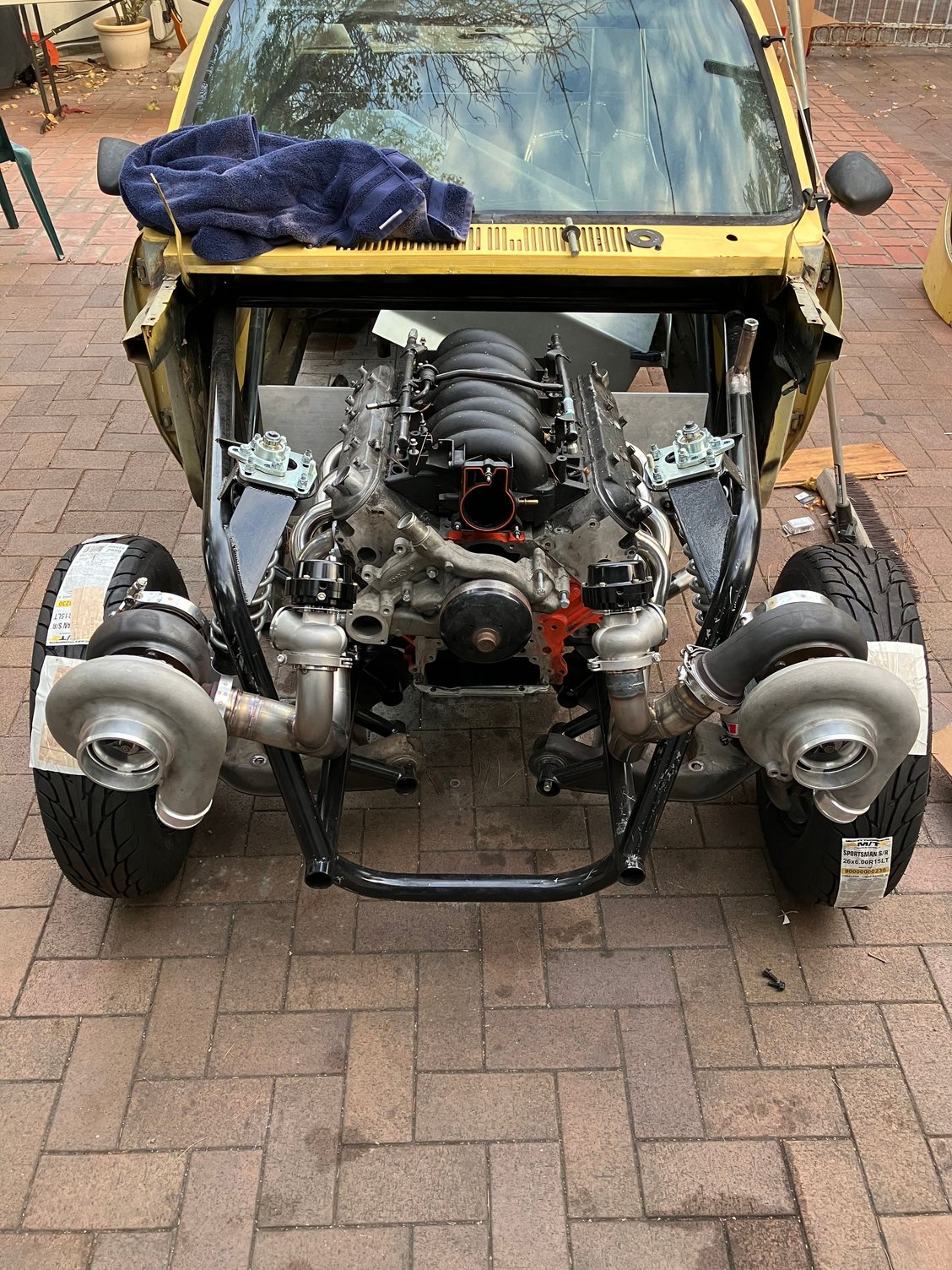

Got most of the heavy lifting done on the exhaust this weekend, here’s some pics.

It all looks very tidy!

Tube frame with an i-Mark hat --- LOVE IT!

I must of missed it, what size are those turbos? They look huge
Old Sep 26, 2022 | 02:17 PM
smog_exempt's Avatar
Joined: Jul 2021
Posts: 27
Likes: 22
VS 66/73’s. Was gonna go with the 67/62’s but a buddy gave me a good deal on these.
