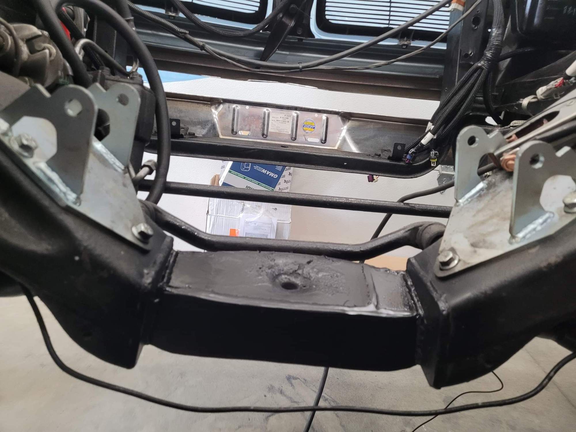

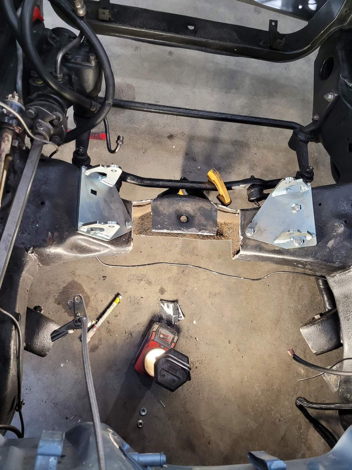

​​​​​​Oh and crossmember problem taken care of!

Looks good. I’m surprised you made the notch that big. Do it once I guess. Lol. What are the dimensions of the radiator?
Old Mar 15, 2022 | 09:59 AM
  #68
brucebanner's Avatar
Joined: Nov 2021
Posts: 127
Likes: 74
24" x 19" x 3"

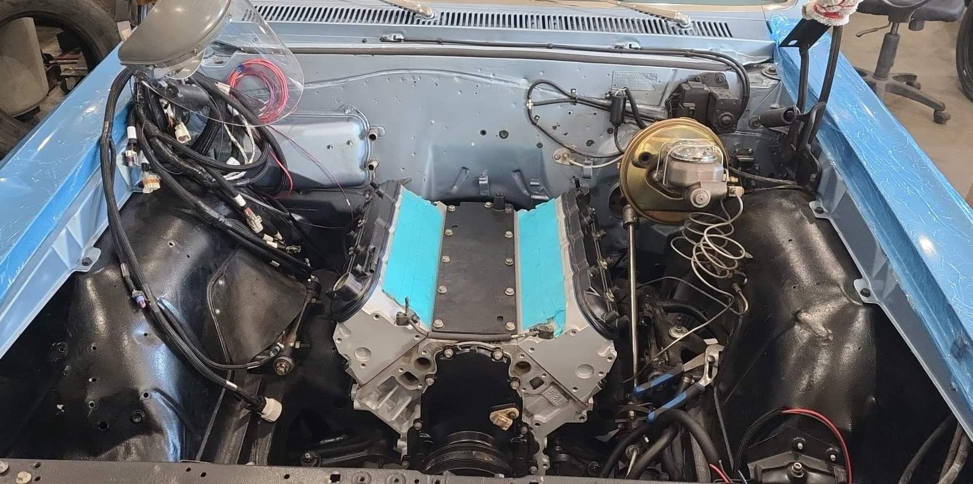

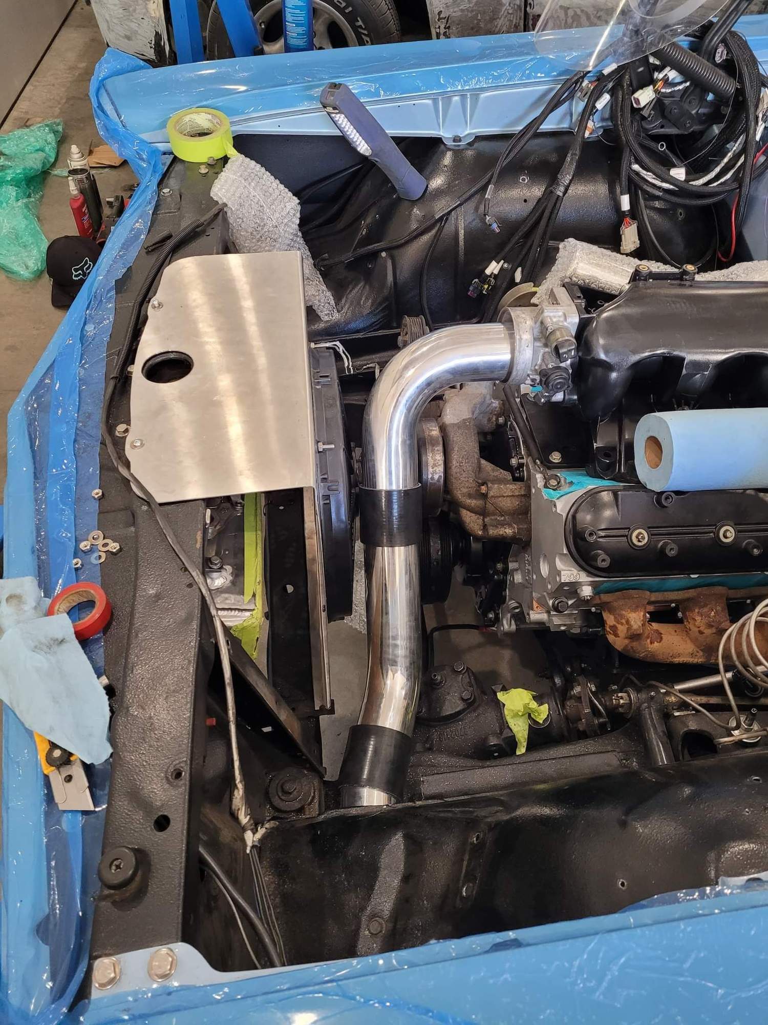

Look what should be in its home for good now

It's always exciting when the engine goes in for good.

Things and stuff - coming together quickly once time is actually spent on it!

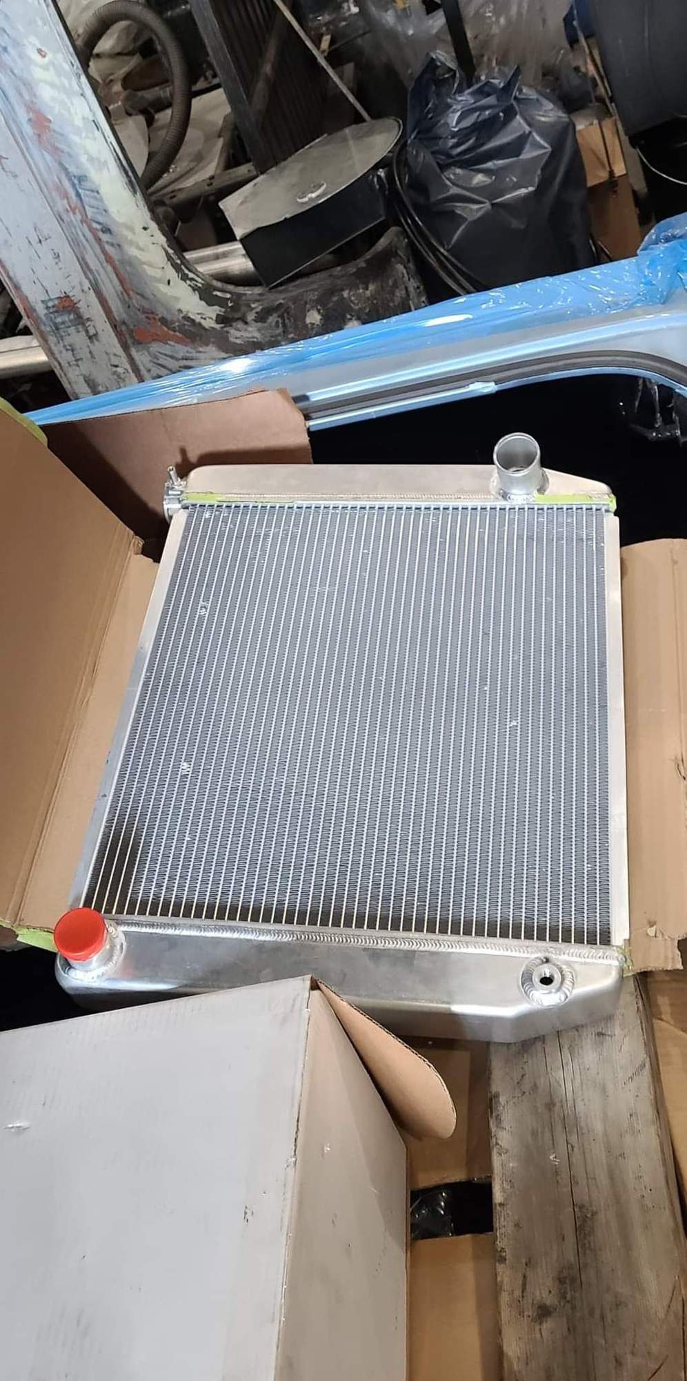

​​​​​PSA: Always check your parts. Bought this rad end of December but never opened the box. This isn't a dual pass rad with both inlet/outlet on pass side. So trying to deal with this a couple months down the road, fingers crossed it's painless haha.

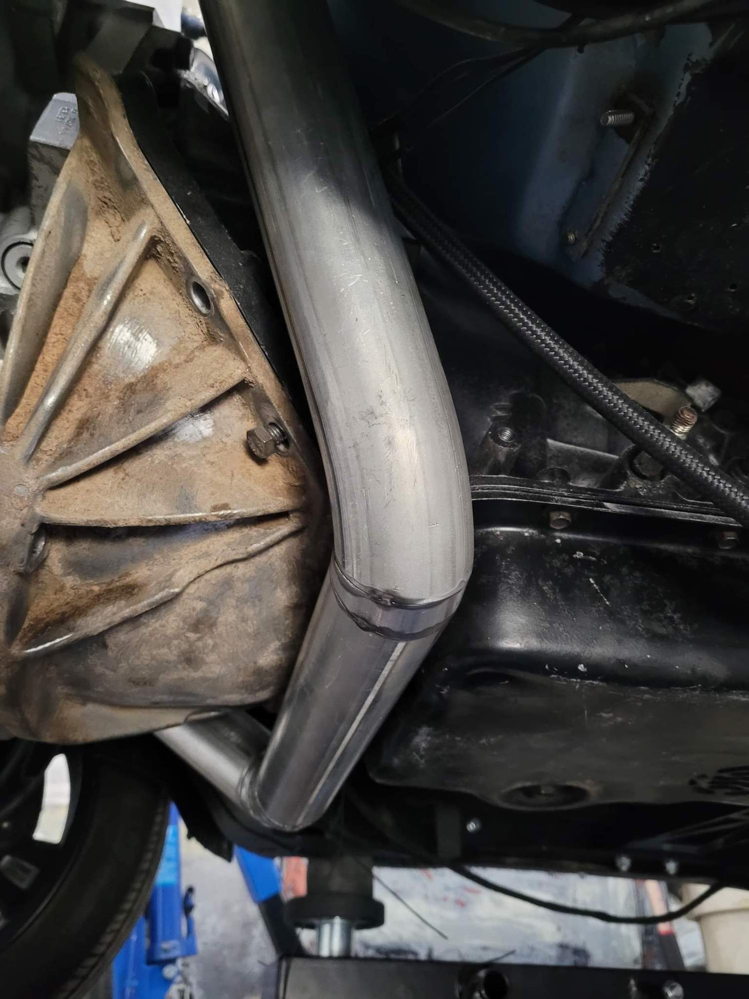

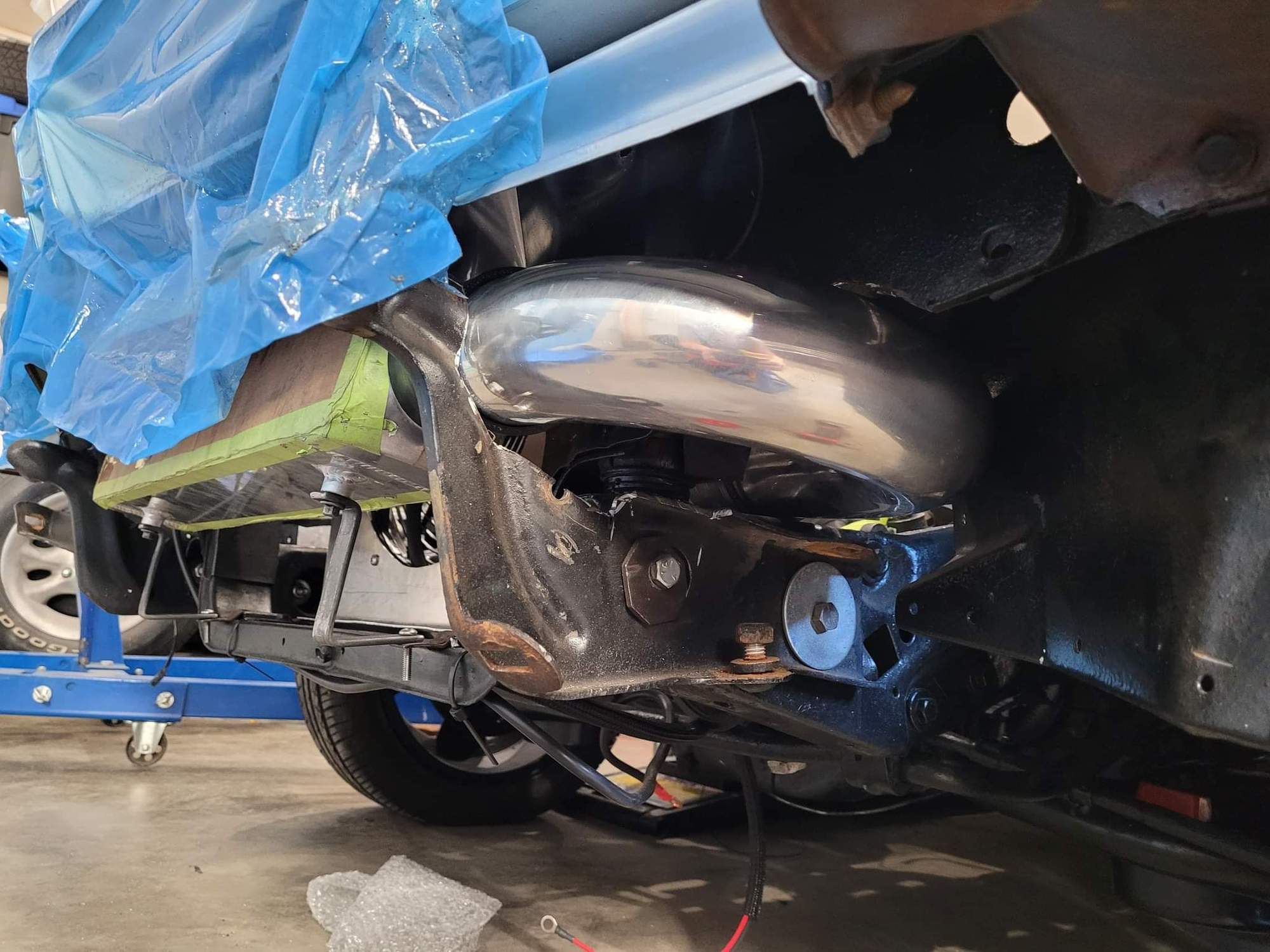

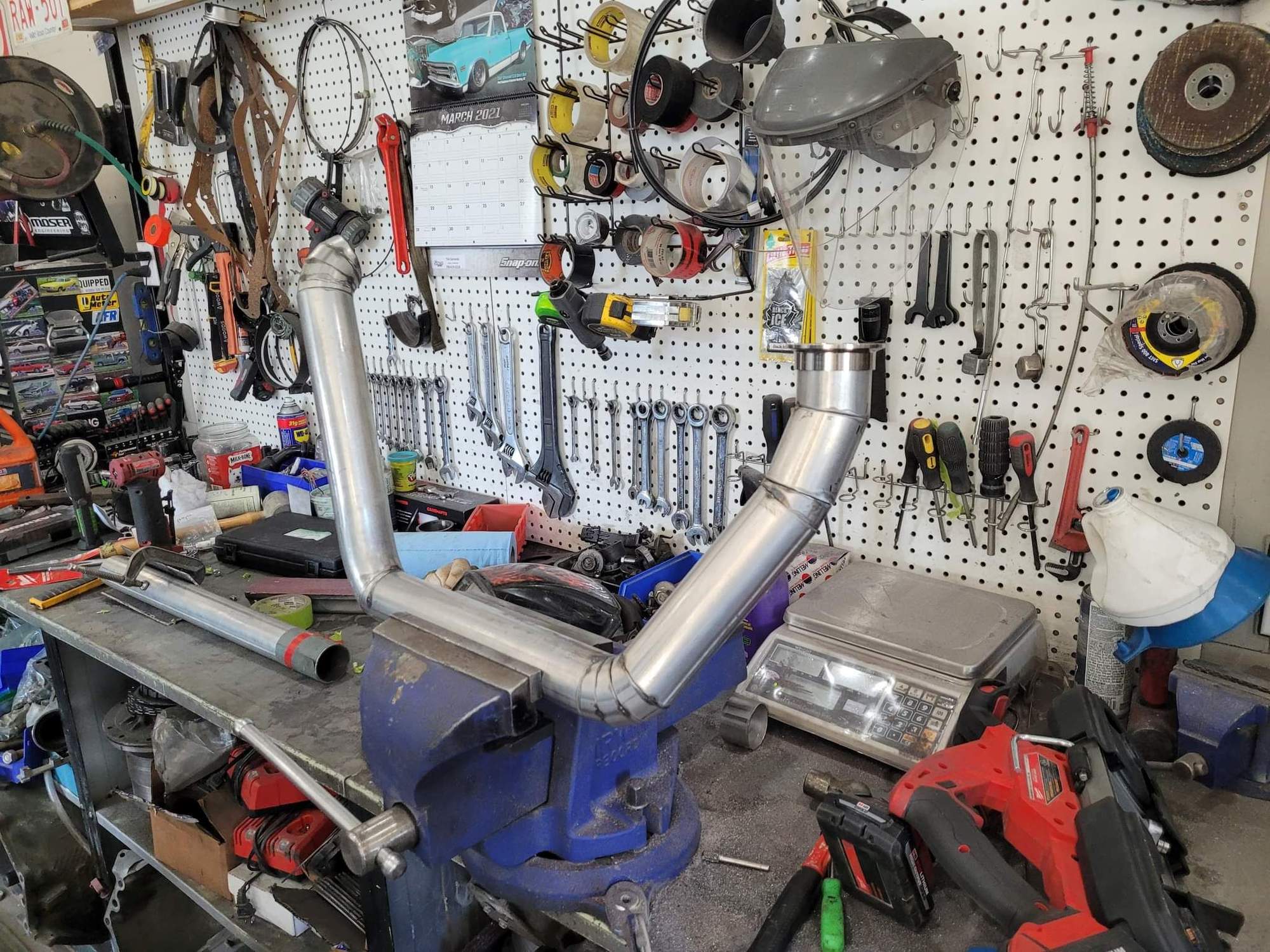

More progress
Nice and snug! Time to get fully welded out.
​​​​​​2.25" crossover size.

Originally Posted by brucebanner
More progress
The Holley crossover has a slip fit joint to account for thermal expansion.
Andrew
Old Mar 24, 2022 | 07:38 PM
  #78
Joined: Nov 2021
Posts: 127
Likes: 74
Now they do, for a long time they did not.
The fit up on this is very good, I expect it to move but I'm not particularly worried about anything cracking. From all of my research, lots don't have issues, some do.
Time will tell.
Old Mar 24, 2022 | 08:28 PM
  #79
Project GatTagO's Avatar
Joined: Mar 2003
Posts: 10,617
Likes: 1,883
From: Little Austin
The original design had a flex couple that blew out. I think you'll want something to let it move. Remember, that pipe can glow!
Andrew
