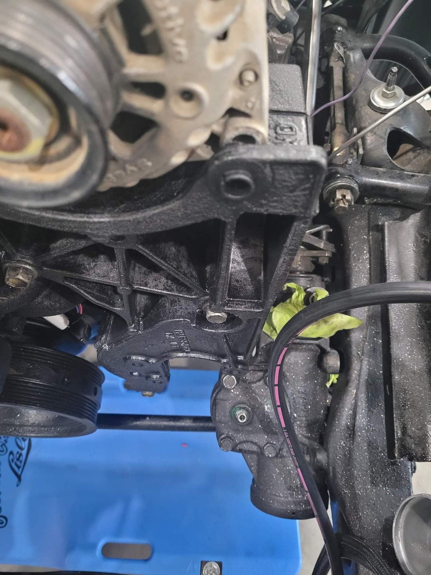

Turbo isn't mounted yet. That's the "wrong" rad in there while waiting for the right one but as you can see there's a spacing issue.
Looks like the rad will get modified.
All issues aside, I think the car will be running in the next couple weeks and all that will be left after that is to finish up the exhaust.

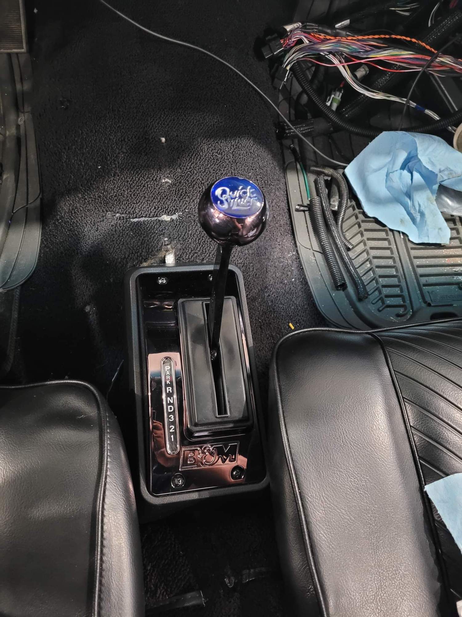

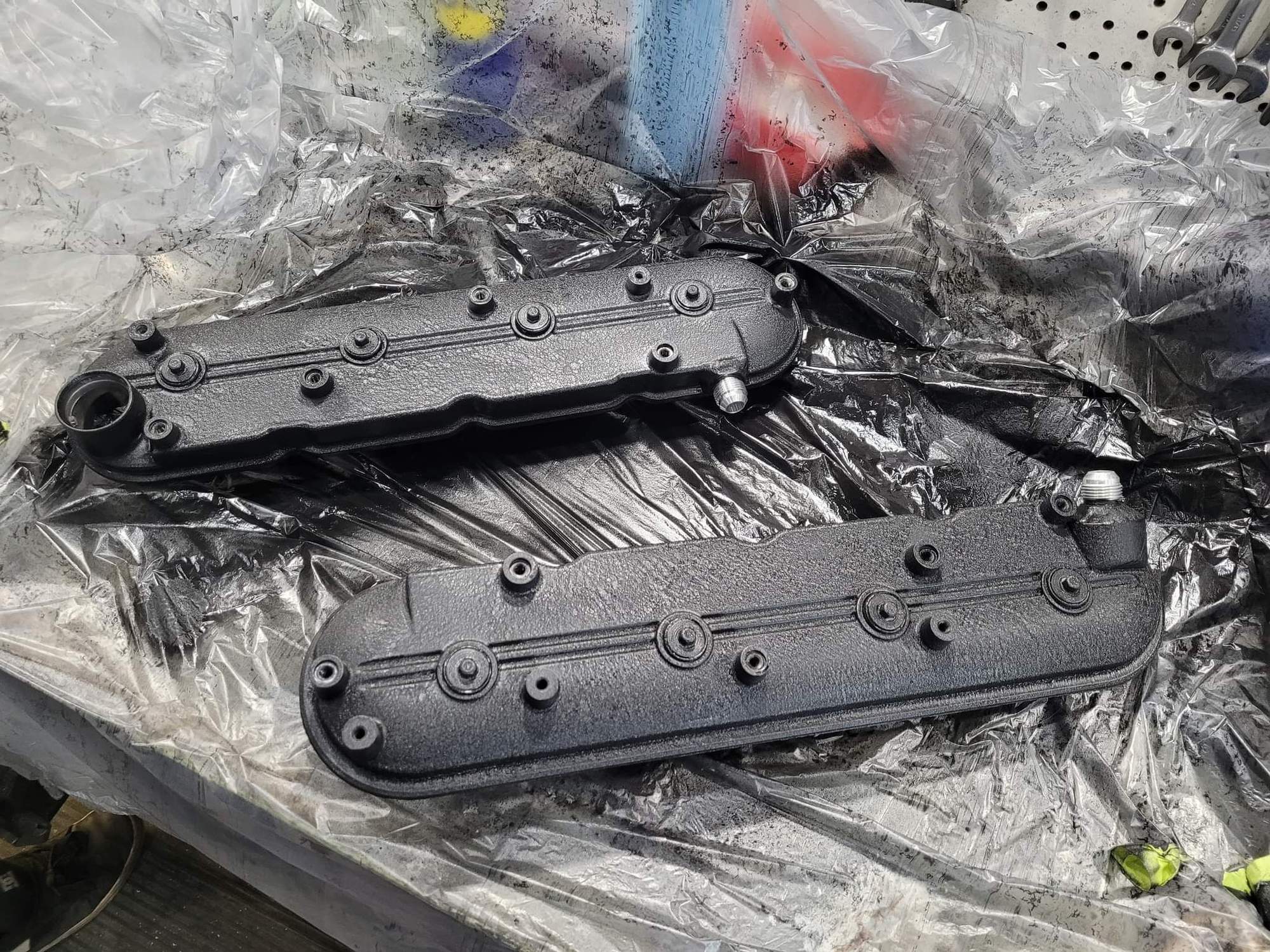

Some more little stuff done today but progress is progress.
Valve covers prepped, bungs welded for catch can and fresh coat of paint.
Shifter installed and as you can see, sits further back than the old one. TH350 vs 4l80.
Probably look for cup holders or something like that to mount in front of shifter. Possibly a full console.

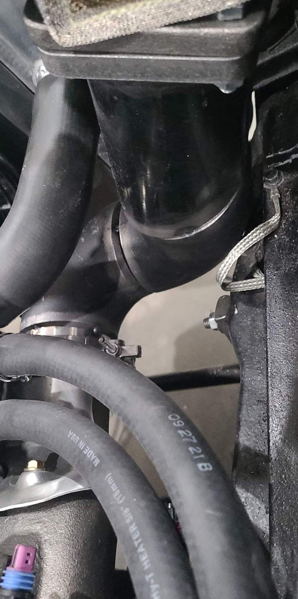

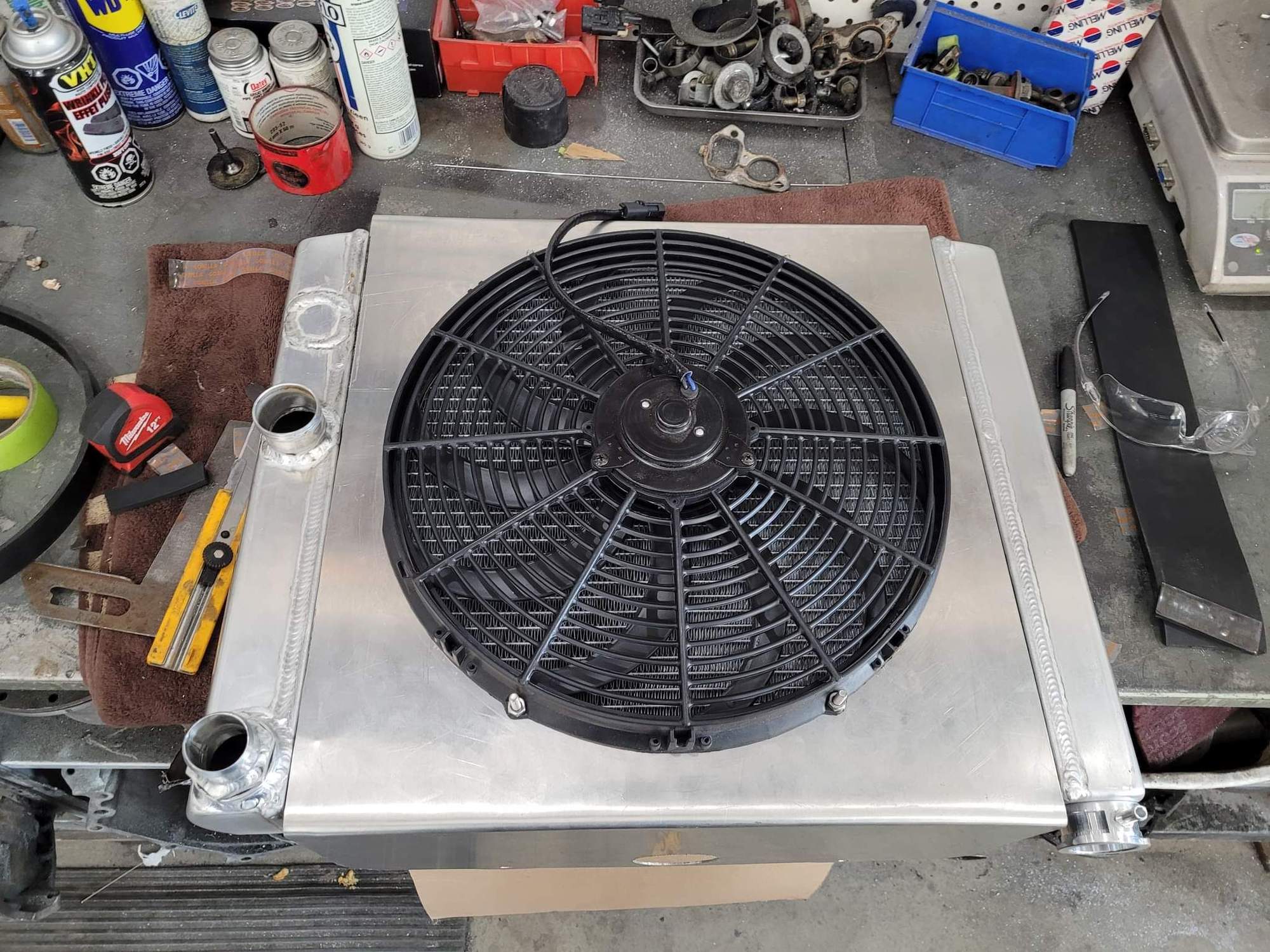

Likes: 74

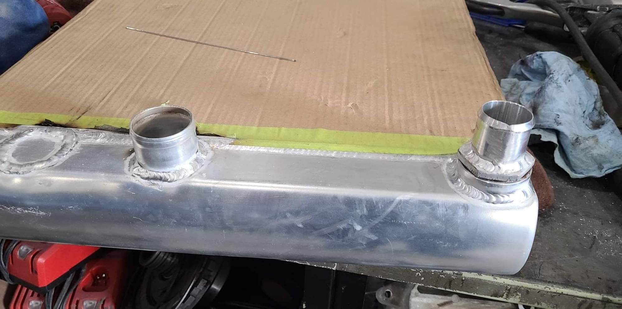

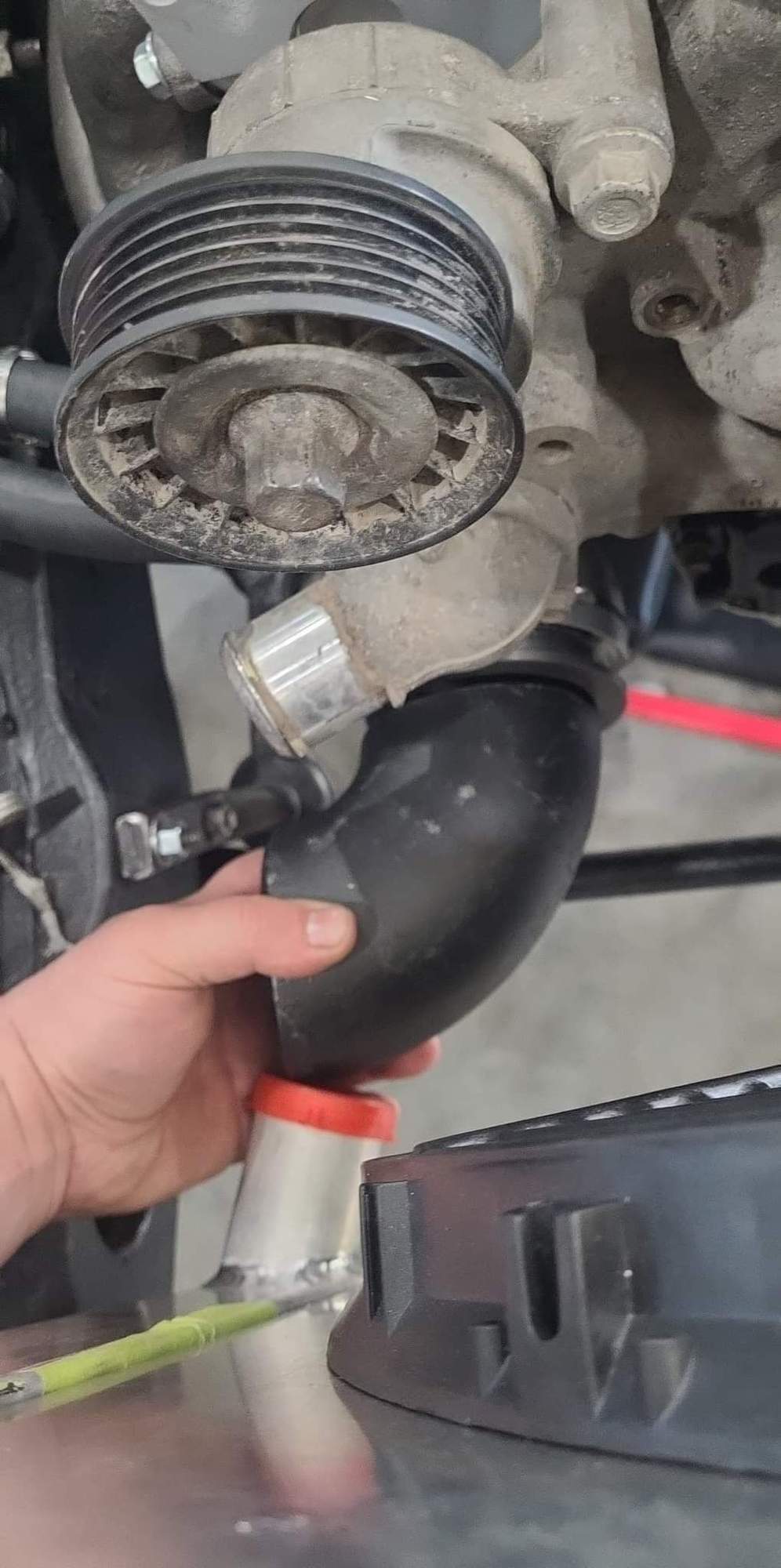

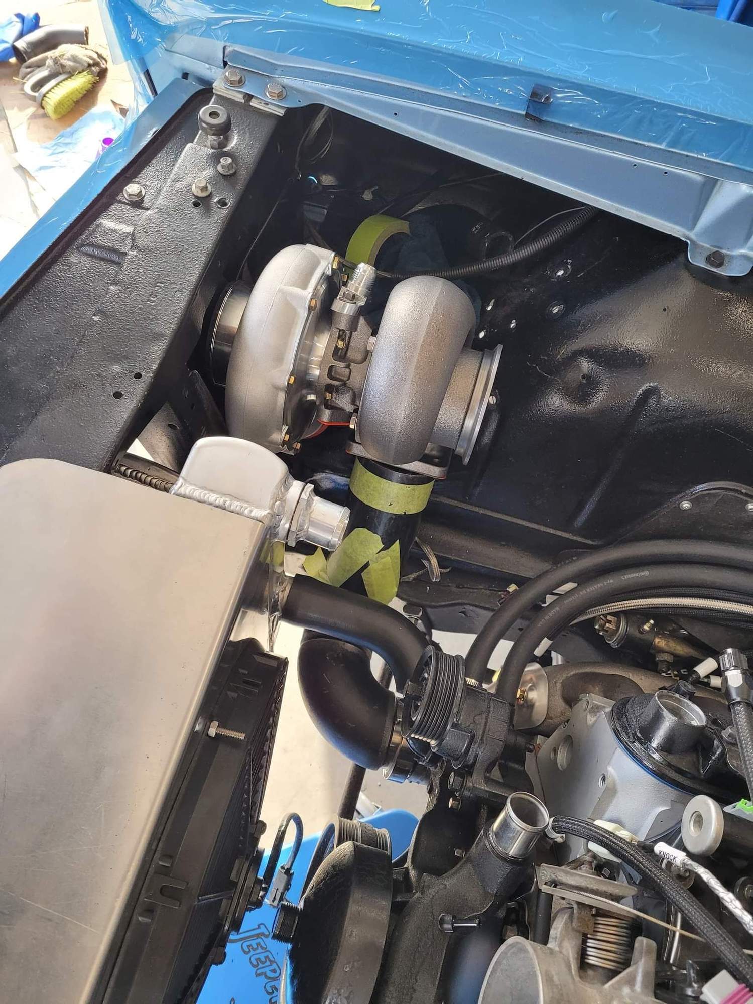

​​​​​Correctt radiator finally showed up and hit the chopping block.
This is where the turbo seems to want to live
Getting closer to the finish line!

How tight is that bend off the Holley manifold? What the dimension from the end of the log to the far side of the bend?
Andrew
Old Mar 30, 2022 | 09:44 PM
  #96
brucebanner's Avatar
Joined: Nov 2021
Posts: 127
Likes: 74
That's was poor photo..
Have to wait for a true measurement but it's roughly 4" - 5" center to center.

Is your radiator moved back from the original location?
Andrew
Old Mar 30, 2022 | 10:39 PM
  #98
Joined: Nov 2021
Posts: 127
Likes: 74
No, radiator is mounted in factory location. 19" x 24" sized radiator, same size as the one it replaced.

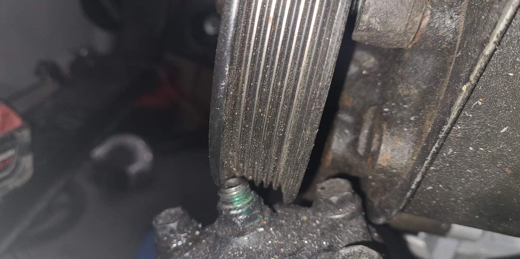

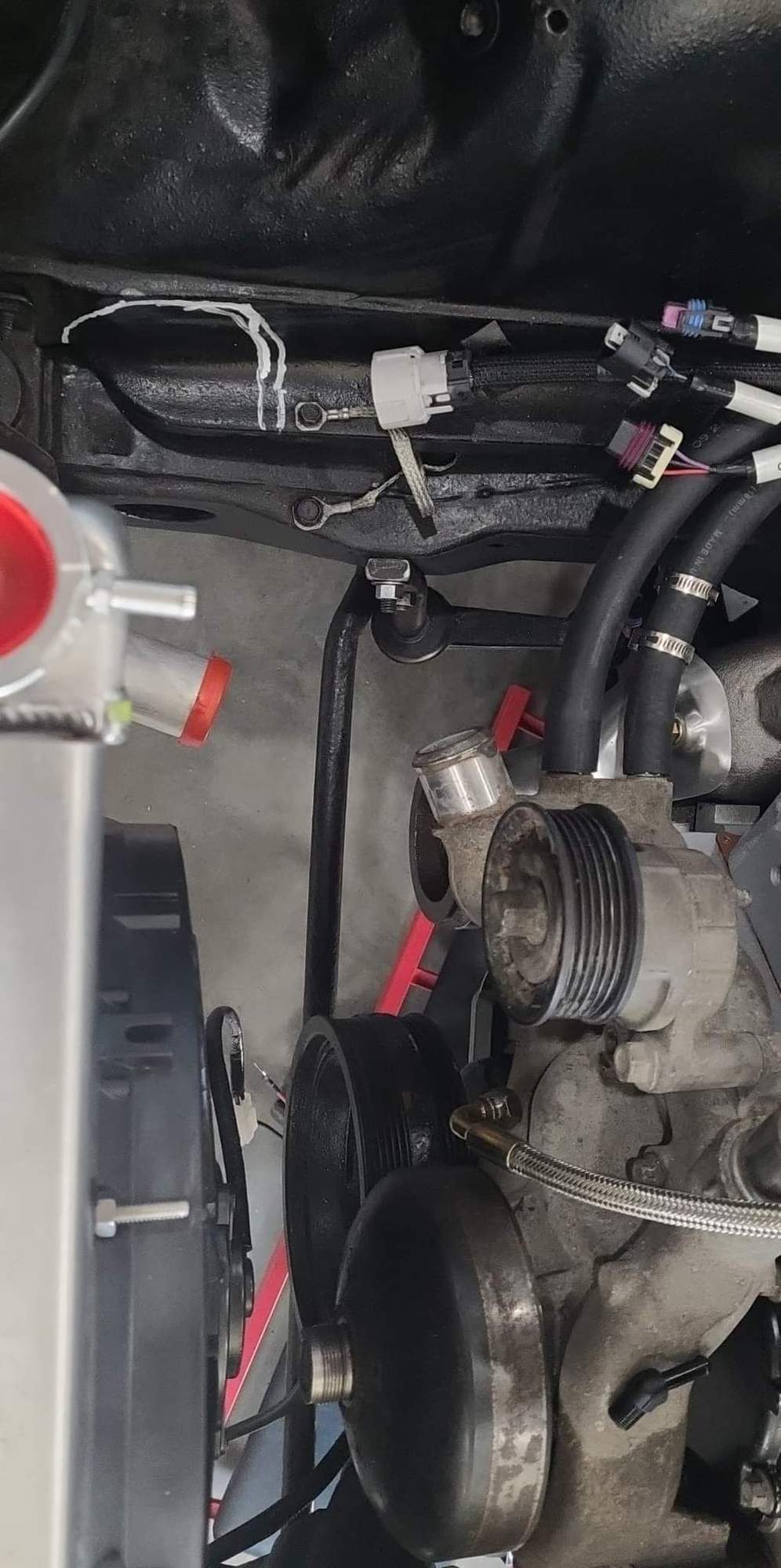

Surfaced a problem. Short of ordering a relocate kit, any ideas?
Power steering pulley makes contact.
Ideas besides ordering a relocate kit?
Old Apr 4, 2022 | 07:21 PM
  #100
Posts: 22,295
Likes: 3,619
Looks like a P/S box relocating kit is your solution.
