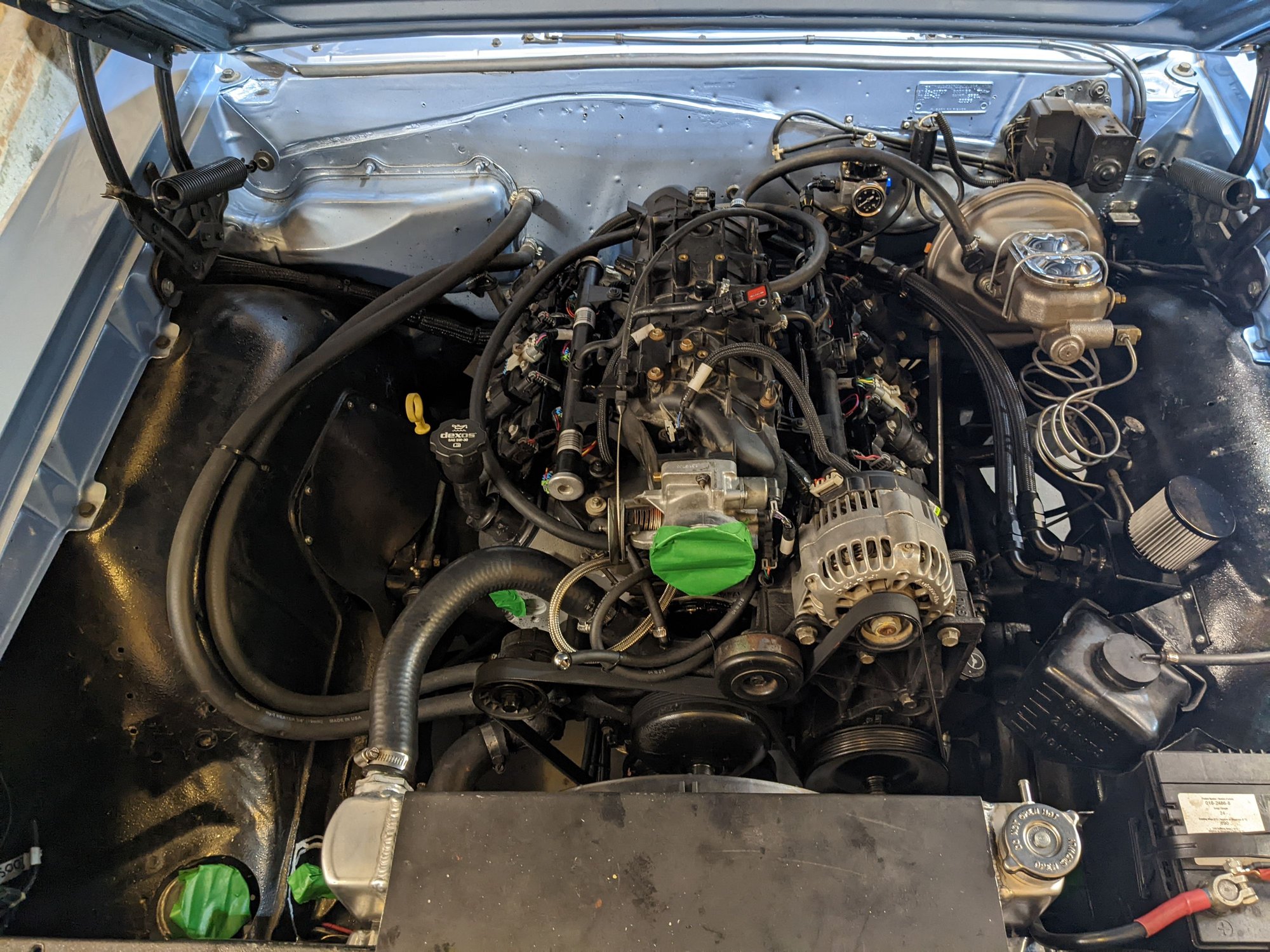

Remember my wishful thinking of smooth sailing and no issues?
Didn't get home until 11pm..
Check valve on the brake booster failed, suspect it blew out the diaphragm.. Okay cool. Pull off that line and plug the booster, get rolling again
Various boost leaks popped up.. Cool, tackle those.
While checking for boost leaks, saw something fishy on the smoothed intake, found a soft spot.
Just to be safe, swapped that out to another stock truck intake.
Springs in the gate (supposed to be 12psi) seem to be creeping too much or something else going on?
Swap the 7psi spring in, things seem to be going well. Car seems to have a shimmy 5200ish + rpm.but hey, everything else seems to be good now.
Nothing gave us reason to think it was motor / transmission. Brand new driveshaft. Think there's something going on in the rear end which I knew all along was going to be the weak link in the car, just didn't think it would show up yet.
So more investigating today + leaving the car to get dialed in at 7psi unless we figure the shimmy out.
Off memory, 7lbs made 510 / 550 ~

Spend a little bit of time last night getting the motor ready to be pulled.. Started steaming/smoking pretty bad out of the catch can. Pulled the plugs, no real indication there. Boroscoped yesterday, no indication from that either. Thinking it must he rings on #8 (based on the plug differences). Still only 7lbs and 14.5°. All plugs looked good, with #8 being the "worst". It is the most carboned / sooty looking and even then, still not terrible At a loss really, not really sure what else I can check before yanking the motor. Going to re test the injectors just to be safe and cross that off the list. Open for suggestions haha. Plans to yank, hopefully find the culprit, fix, button back up and then turn it up.
