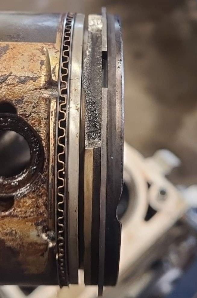

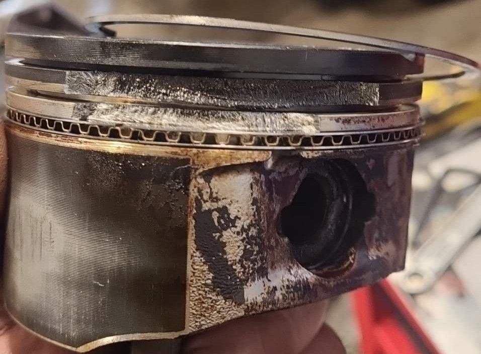

Cylinders 5 & 7 broken pistons. Was also some debris on the oil pickup screen.
Digging more tomorrow, hopefully don't find anything else.

Andrew what do you think could have caused this?

The guy tearing it down doesn't think it was detonation as the tops of the pistons and plugs show no sign of it. A few other guys I've shared the photos with lean towards detonation based off of the damage.
I can't lie, it's out of the realm of my experience, so I'm definitely open to others opinions.
Since it's out of my experience, it's part of the reason I went with someone else to provide a motor/trans combo... even that doesn't seem to matter for me unfortunately.

Generally I've seen folks say that was caused by detonation.

Motors torn down and findings..
"Rod bearings look good & same with the rod throws on the crank.
The crank bearings are done and so are the surfaces on the crank.
So you need 2 pistons and your choice of a different crank or get this one ground. I would rebearing the whole engine and I would strongly consider replacing all the pistons."
Was the information given to me today. I have access to a spare parts motor that I'm likely going to get the motor back together so my cost and downtime is limited. Plan for something different over winter likely.

Bruce, that sounds like a solid plan given you are at a reasonable boost number. While it's apart though, have the guy gap your rings. When I built my motor, I got new Mahle file fit rings and gapped to .024/.026 per the instructions for mild boost. I was running around 10-12 psi.

So did it go lean or something?

From the people I've spoke with and shared pictures with, most lean (no pin intended) towards detonation. I don't know the cause of the detonation if that's truly what it was as the car is tuned conservatively. Can't pull the log file as terminator doesn't auto log and I definitely wasn't logging drives.
Bad gas? Possible I guess. Whatever it was, I hope it's behind me now.
